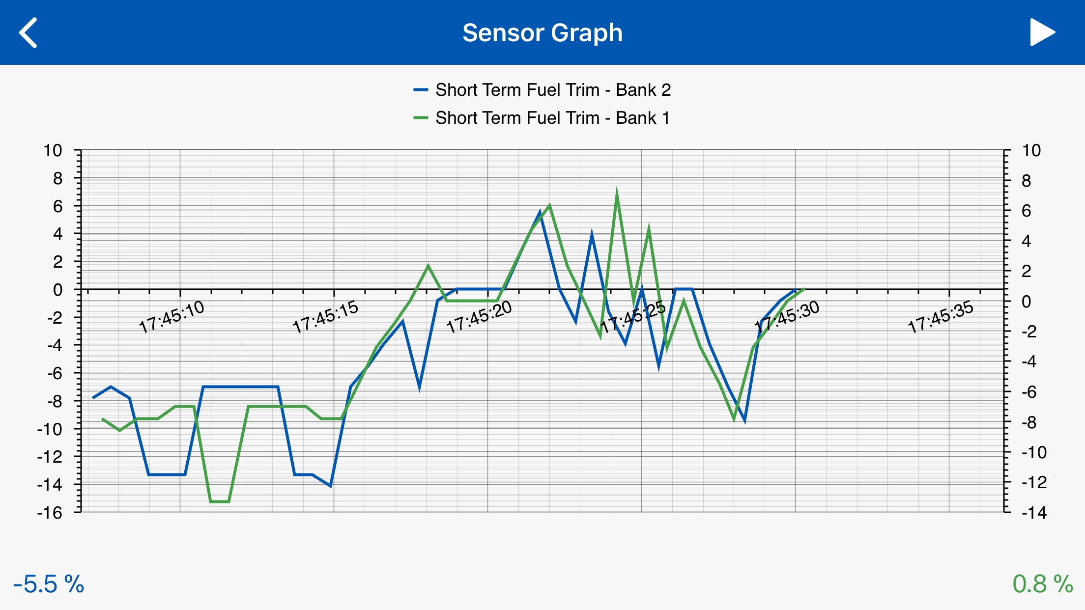

My XJR has had a fixed, unchanging LTFT of 10.9% for the past few thousand km. The STFT fluctuates by a few percent as per the graphs from Autodoctor that I have attached.
Under harder throttle the STFT goes to zero as per the graph that also shows %throttle opening, presumably because it goes into open loop when the pedal is down. Rest of the time both banks fluctuate up and down in a fairly matched way.
