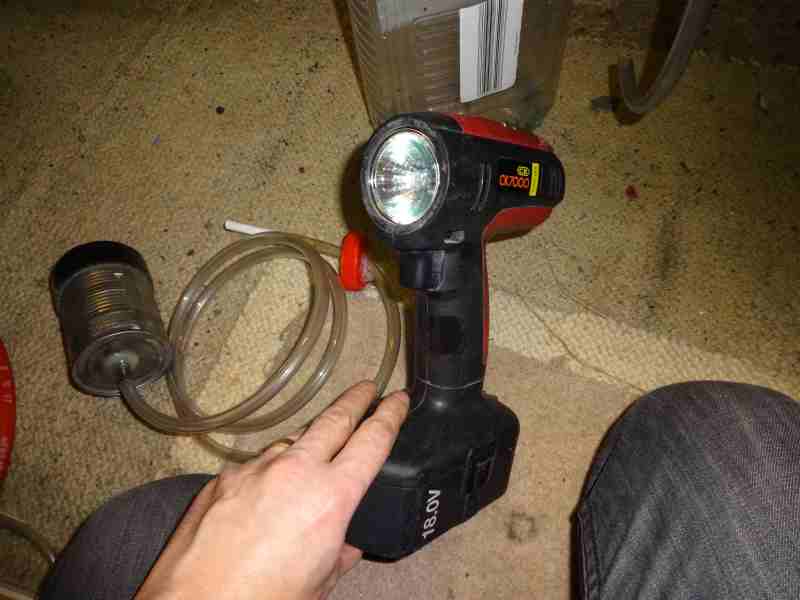

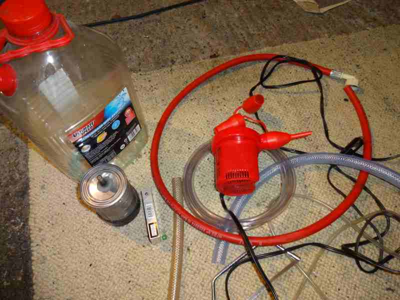

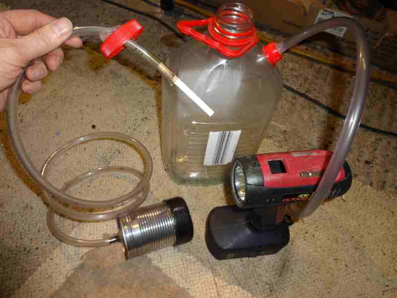

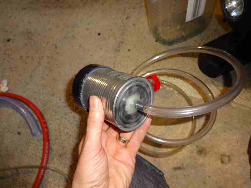

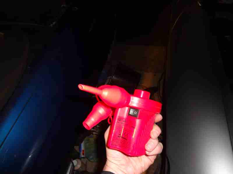

I gathered together some odds and ends.
This container has two sealable lids but it is not critical, I used heat glue (faster than epoxy which would be better) to fit the tubes to the two lids and a cigarette was pushed into the tube.
One end goes to a pump used to blow up camp beds powered from the cars 12 volt outlet and the other goes to a tin can which had a bicycle tyre valve glued into it, I drilled out the valve from the body.
I butchered an old battery powered drill to make a "day light" torch for paintwork inspection and this will be handy to use to identify any pufs of smoke. The halogen lamp I used is 12 volt but goes super bright at 18volts.
This is the camp bed pump I used, however it is too powerful as it burned out the cigarette in about 10 seconds, I will rig it up to a lower voltage power supply so it lasts a bit longer.
Attached Thumbnails long term fuel trims, what are yours-smoke%25201.jpg   long term fuel trims, what are yours-smoke%25202.jpg   long term fuel trims, what are yours-smoke%25203.jpg   long term fuel trims, what are yours-smoke%25204.jpg   long term fuel trims, what are yours-smoke%25205.jpg

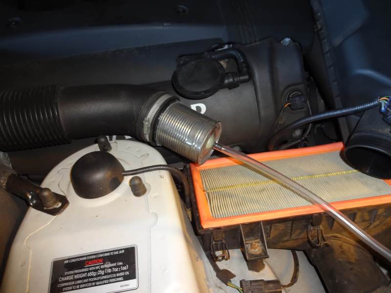

I tried the smoke machine today.
The tin can fitted in the end of the intake tube perfectly, must have been the same diameter as the TT
On to try it out.
Looks like I should have put on a new gasket when I had the TB off to repair the heater pump!
Attached Thumbnails long term fuel trims, what are yours-smoke%2520%25206.jpg
