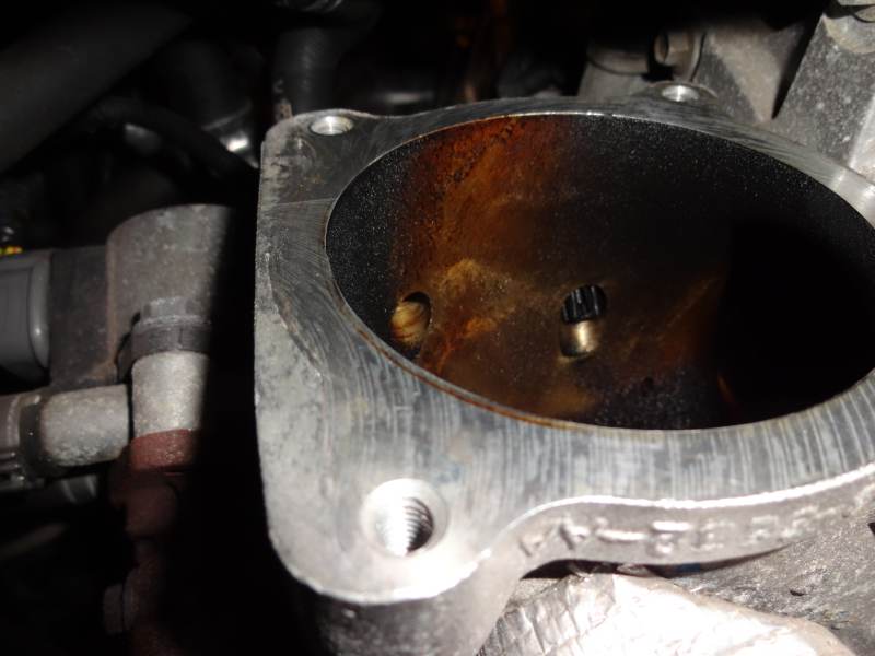

I picked up a new gasket today.

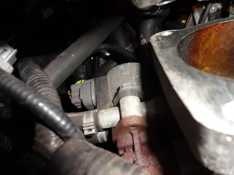

Once the tb was off I noticed this, I guess it is the egr valve, I hope the smoke was not coming from it.
The manifold below the TB was pretty dirty, is that normal?

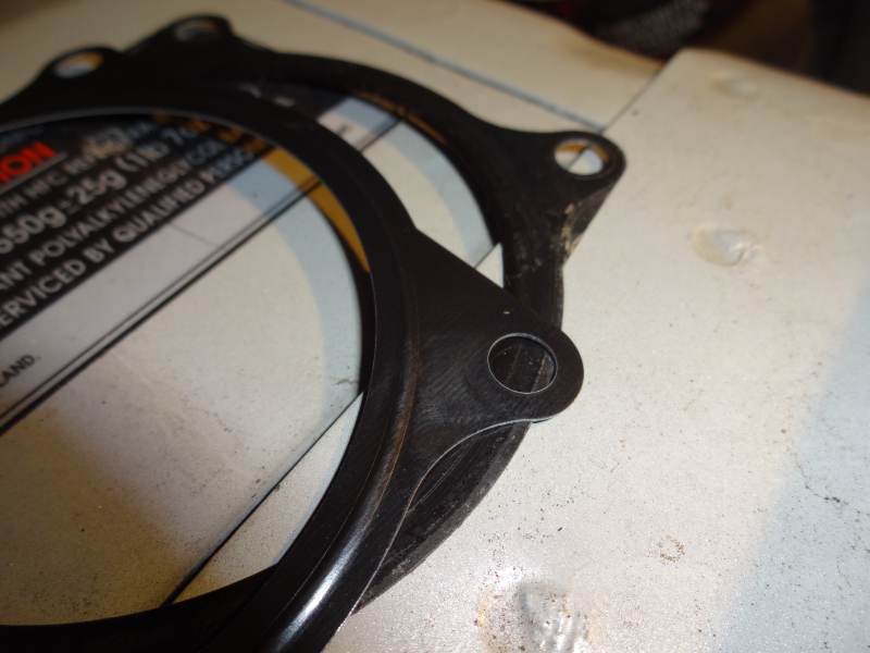

The new and old gasket.
It was just a 10min job to get the new gasket fitted but as there is snow on the ground tonight I did not give it a test drive or smoke test yet. Results later.
