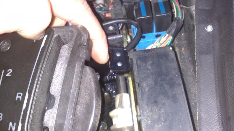

Heya,
I hope somebody please can give me some advise in getting the ticking noise fixed in the center console.
Referring to this thread https://www.jaguarforums.com/forum/x...300-faq-57038/, my switch under the skislope / J gate is making contact when not pressed in. Its not all the time, most of the times when the car is cold i here ticking from the switchmaking contact( the sound is like a relais going on and off ), after a few times going crazy it stops and works like normal again.
I opened up the skislope and unscrewed the J gate and then cleaned the switch, but its still making contact by itself sometimes. I noticed it is popped with nails on a metal plate next to the J gate.
- What is the name of this switch?
- Is there any way of fixing this issue without replacing the switch?
- Is it replaceable?
Thanks in advance,
Maraud

It looks like the inhibitor switch that stops the car starting if it's not in park.
It's a micro switch and the only way is to replace it as they can't be taken apart.

Its not that the car won't start, it start and runs great. Its just the sound of the switch going on and off for a couple of times.
Can i just replace the micro switch or do i have to replace the whole unit?
As i am just expecting the switch to be the problem.

No I dont think so it is the solanoid. When i removed the Skislope and J-gate I played a bit with the switch. When i touch the switch and try to wiggle it a bit i hear that the switch is making contact itself. I hear the click noise in the switch. When you press the metal plate it makes contact, when you let it go it makes a sound of releasing. But sometimes it just goes by itself. Specially when i hold the micro switch in my hand and try to move it. There is almost no room to clean the switch, and the switch itself can not be openend.

It is not the solenoid that I hear making sound. When i press my brake pedal and let is lose I hear and see that the solenoid is doing the right thing.
Its the micro switch for sure, but the odd thing is when i lay my hand on the plastic switch, and grab it and try to move it a bit on the metal plate, it starts clicking and making noise.
Where do i find the same switch that perfectly matches the genuine part?
On jaguar part websites i can find the solenoid and the inhibitor switch module, but not the tiny micro switch.

The problem with the switch is solved since last weekend, i have replaced the old switch!
I have also located a store on Internet where you can buy the switch if its not availible by your local dealer.
Y4T6Y-1884 Sundry - 40 in stock to buy, photo, pdf datasheet, rfq, obsolete
See video for the working switch after replacement.
When i press the switch and brake you hear the mechanism from the solenoid work fine. When i let it go and brake you dont hear the solenoid. Nice and queit, also the stressed out switch clicking noise is gone now. Works like a charm!

When the switch is pressed, the solenoid mechanism is unlocked so you can move the shifter to drive. When the switch is not pressed, the mechanism is locked so you cant put it in park or reverse when driving the car.
Also you would hear the mechanism click all the time when you would press your break! ;-)
Adjusting the metal sprite from the switch will propably fix your problem.

Hi Maraud, exactly the same problem here! I'll order a switch off that link you kindly provided...
Just so I'm prepared though - did you have to drill out what look like rivets holding the old microswitch in place? & presumably just cut the wires and solder to the new switch?
Cheers!
Old Jul 25, 2013 | 06:46 AM
Maraud's Avatar
Joined: Nov 2012
Posts: 286
Likes: 60
From: The Netherlands
Cheers!
Hi Ziggy, yes what you can do is order a new switch and replace the old one.
Drill out the remaining switch, and replace. Exactly what you already thought.
Other thing you can do is remove the complete ski slope and remove the copper plate attached to the J-gate ( a lot more work )
This copper plate hold the switch.
Best thing to do first is to try and clean it tho! Soak it with contact spray, wiggle and play with it.
Goodluck!
