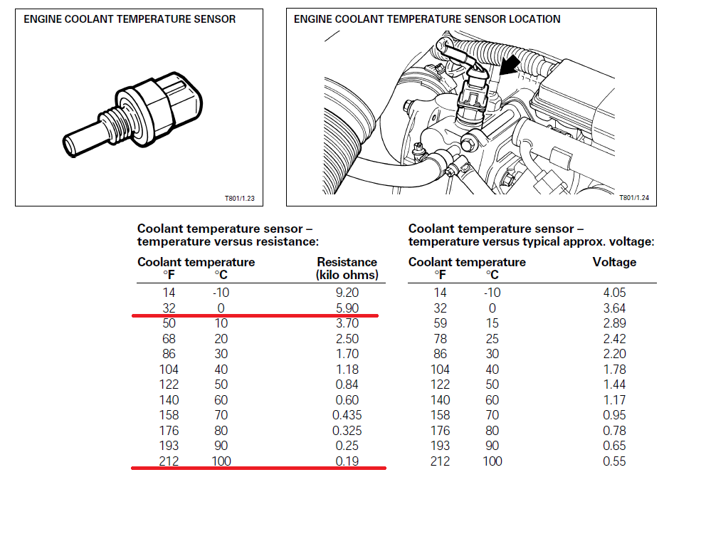

In my opinion if you read the wire and is in range on the 0.60 + or - 0.02 volts you may not need a reorientation with the cost involved and appointment hassles . You can read this value with the key on and engine off by tapping into the return (Green / Yellow wire ) to the ECU wire as it goes over the top of the engine . This would also depend on how the present orientation setting or matching is with respect to the previous TPS . Note that the factory holes of the sensor may not be placed to be able to put it on the factory recommended range and I had to drill them up in size in order to do so . If you have enough patience the sensor mounting screws can be got to from the top without removing the TB .
With respect to the engine coolant sensor it's one of those oh by the way this is also involved thing overlooked and forgotten . As the coolant temp is low it biases the fuel trim or mixture to the rich side until the engine warms up . This could be making the idle high . It's an exposed connector so I would look at it and clean it up and preserve it . You can easily remove it and calibrate it's accuracy by dipping it in ice water and boiling water and verify the results on the graph . It's a negative temperature coefficient (NTC) thermistor so the response is opposite from the old school plain resistor style . This is the same response chart of the inlet air temp sensor just forward of the TB on top of the 90 degree turn . If you don't already have this full doc that it came from , here it is below :
