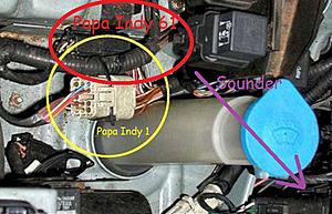

There are 3 relays inside the fan control relay module and they should be either on or off as designed . I cut mine open to find out if I could repair them finding it full of water . In toying with it I could get full or less then full speed on the fans . I will be sourcing a replacement fan control relay module . X308 part is a substitution .
On the AJ16 a free and easy try would be to cleanup the Papa Indy 1 and 61 connector that gets corroded containing the injector and coil power source wire for each and is common to your V12 as the secondary air pump wire runs through it .
