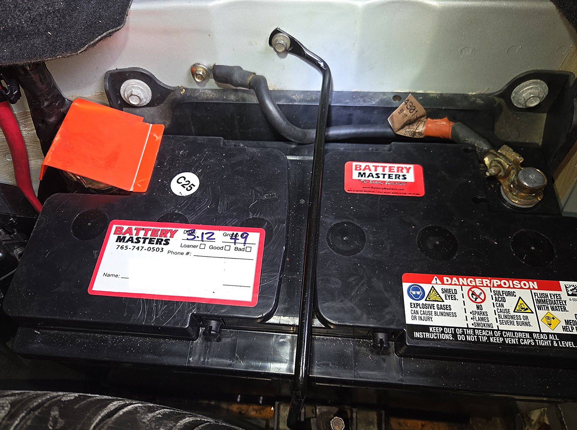

When starting the engine, I noticed that the engine cranked and started sluggishly.
I measured the battery resting voltage and it was extremely low at 11.88 volts. I then measured the alternator charging voltage at the battery terminals and it was very low at 13.2 volts. I connected my battery-charging system analyzer and found that the battery capacity was just 597 Cold Cranking Amps. There was no rating label on the battery, but typically H8/Group 49 batteries carry ratings of 850 – 950 CCA, so this battery’s capacity was significantly diminished, possibly due to poor charging.
The alternator output was clean with relatively low AC ripple of just 75 mV, so I suspected high resistance in the battery power and ground circuits between the battery in the trunk and the alternator and starter in the engine bay. This is a very common issue on all Jaguars with batteries in the trunk/boot.

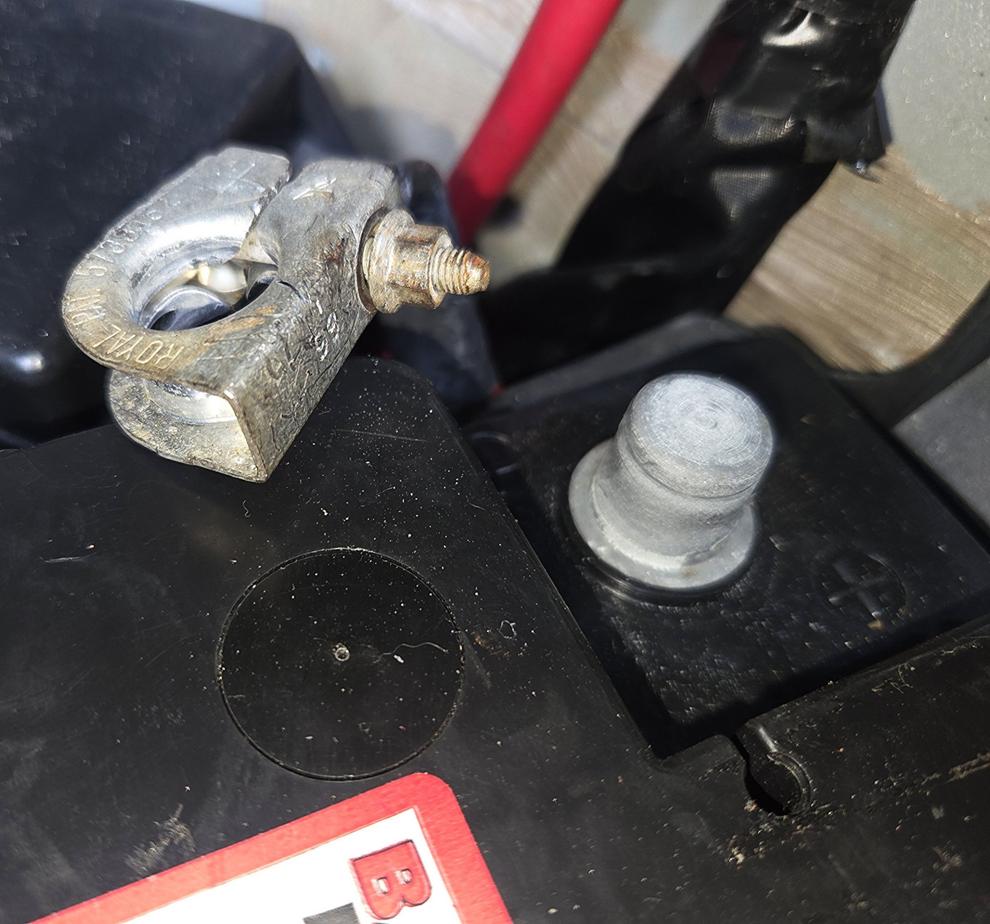

I detached the negative battery cable and inspected the terminal and battery post. Both exhibited white lead oxide corrosion.

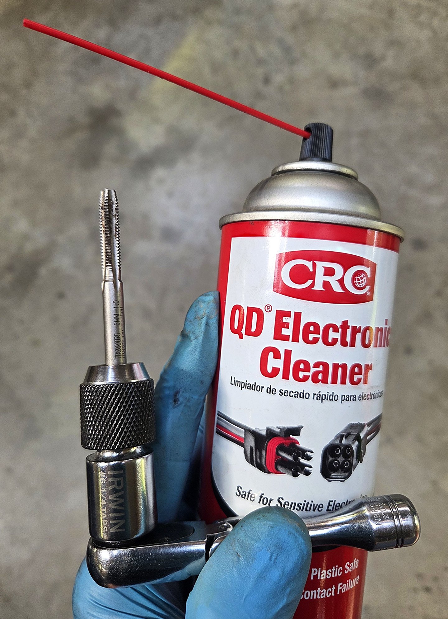

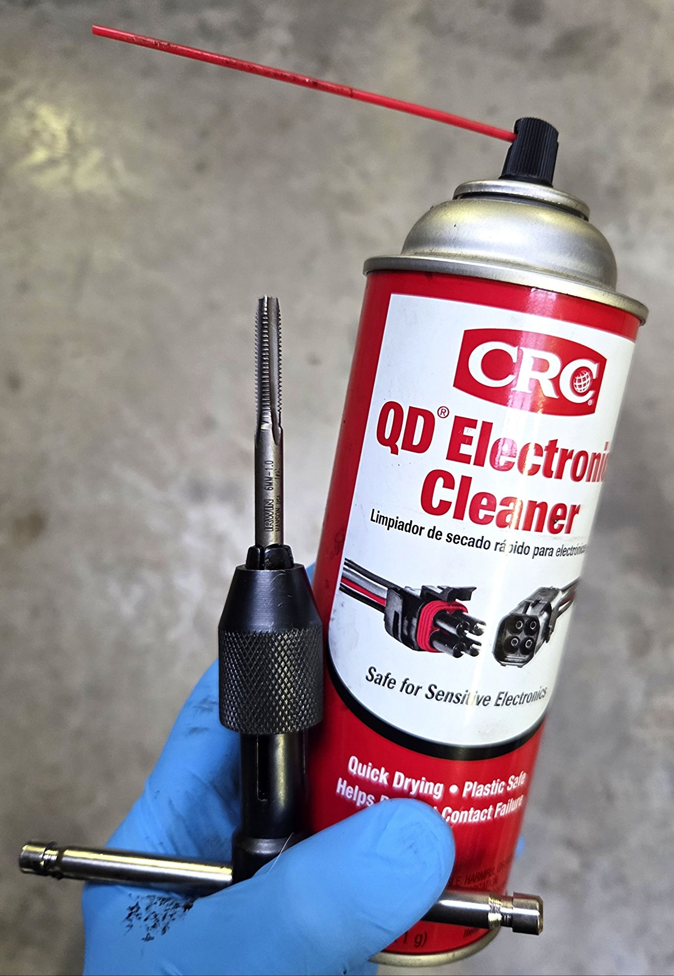

I cleaned the threaded hole in the body with an M6x1.0 tap sprayed with CRC zero-residue electronic contact spray cleaner.
I detached the positive battery cable and found the terminal and post both covered in oxidation. I cleaned the cable terminals, battery posts and ground screw with battery brushes, a small brass-bristle brush, and contact spray cleaner. For now, I left the battery disconnected.

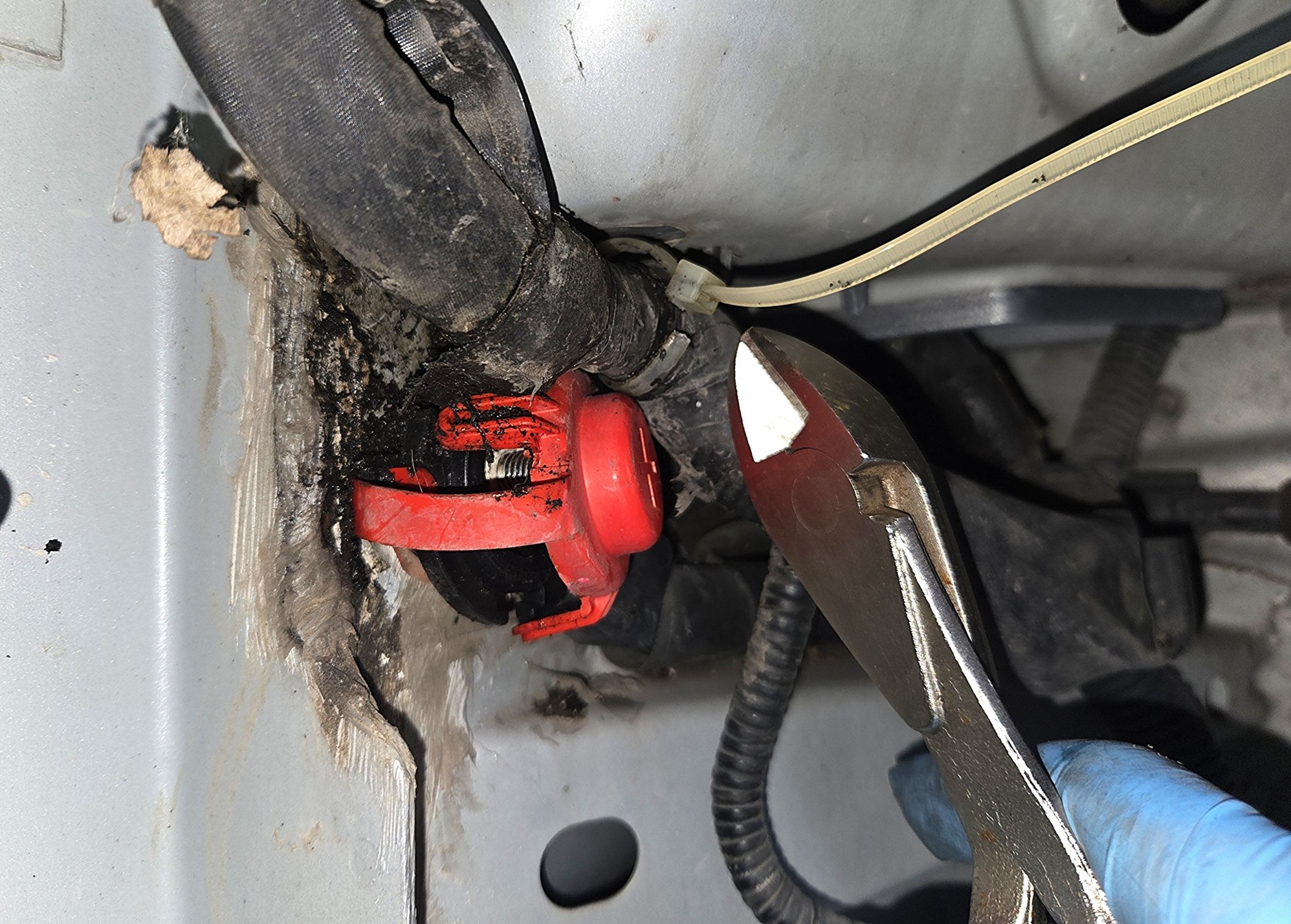

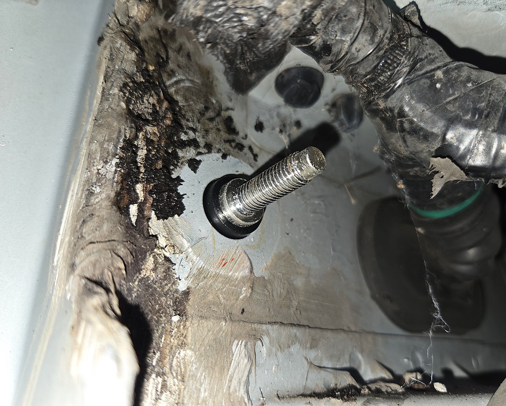

Next I gained access to the Bulkhead Power Stud by raising the vehicle, removing the front right wheel, detaching the rearward half of the wheel arch liner and folding it forward over the brake rotor.
Upon inspection, I found that a wad of wet, decomposing leaves was wedged above the bulkhead power stud.
I used a pick to clean out most of the leaves. Then for improved access to the stud cover, I cut the zip tie and displaced the electrical harness:
The red plastic power stud cover is secured by three slotted “legs” that must be pried outward until they unclip from wedged tabs. I used a small right-angle pick:
Remove the 13 mm nut and the power cable will pull off of the stud. Both the nut and eyelet terminal exhibited white oxidation.
The threaded stud is now accessible to clean. On the other side of the bulkhead/firewall is a similar connection, though because it is sheltered from weather, it tends to not suffer the same corrosion and contamination as this side.

I removed the 8 mm screw and inspected the eyelet terminal and screw and found more crusty white oxidation. I cleaned the eylet terminal and nut and used the M6x1.0 tap sprayed with contact cleaner to clean the threaded hole in the body:

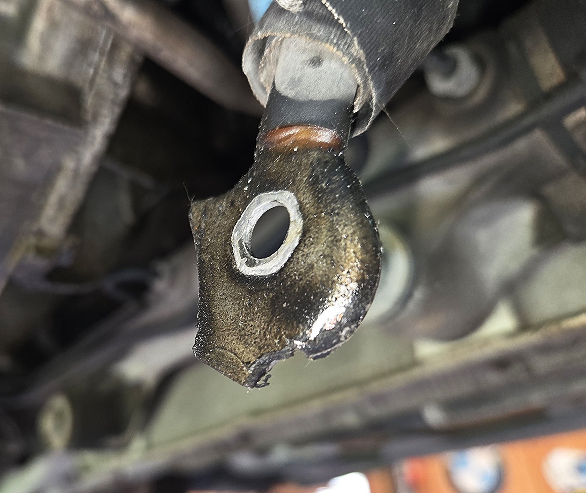

The other end of the engine ground strap is connected at the rear engine flange just below the starter motor:
Upon closer inspection, I found that the engine ground strap stud was wet with oily gunk. This is a 13 mm nut.
With the ground strap detached from the engine, it did not appear that the oil had seeped into the electrical contact area covered by the nut flange, but white oxide was clearly visible there.
The other side of the terminal was in similar condition but the white oxide in the electrical contact area was even crustier:
I used the brass-bristle brush to clean away all the oil and oxide and then flushed the terminal with contact cleaner.

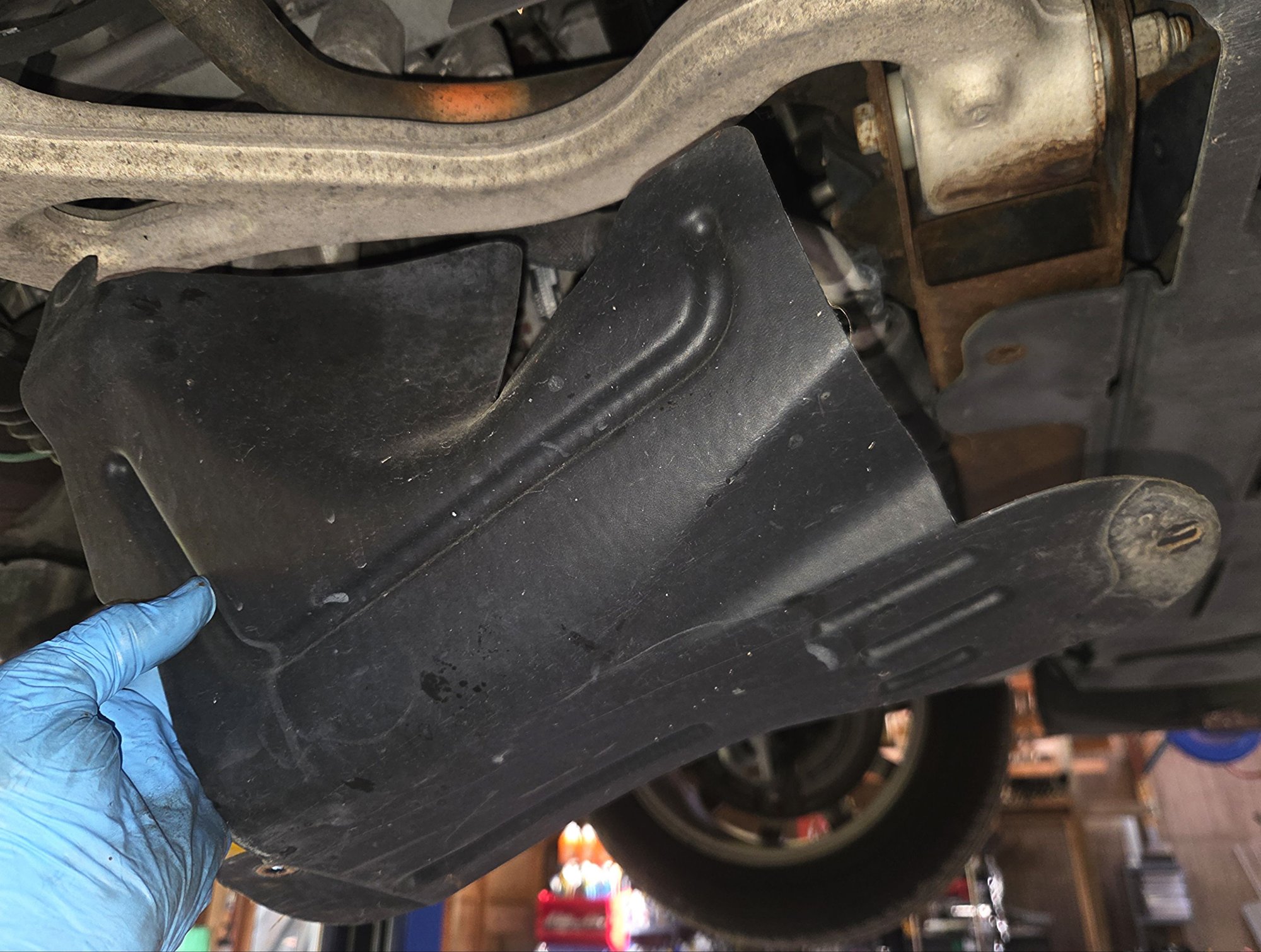

For access to the starter and alternator on this 2001 3.0L, a small supplemental wheel arch liner must be removed.

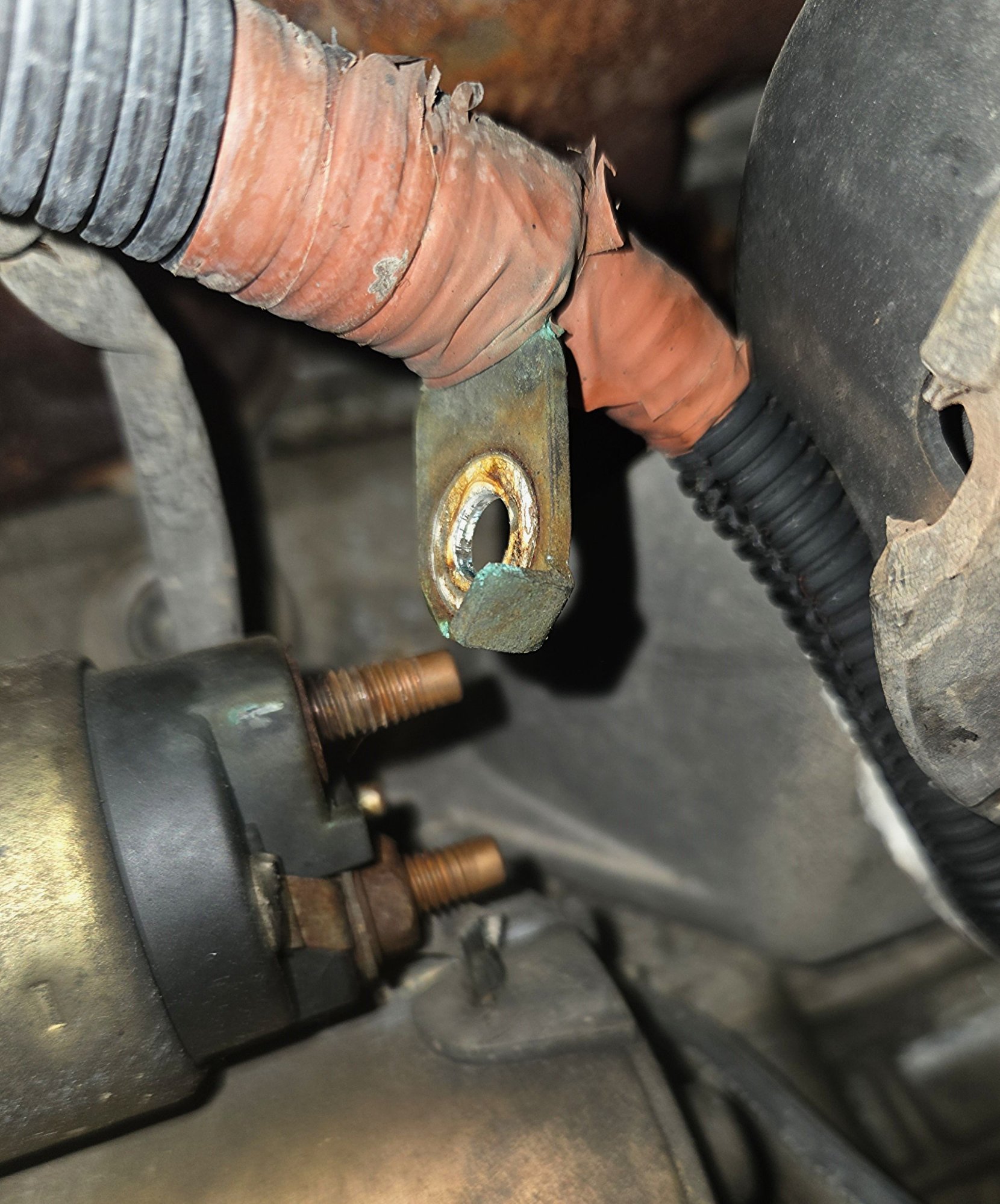

The starter electrical connections are protected by a red plastic cover that just pulls off:

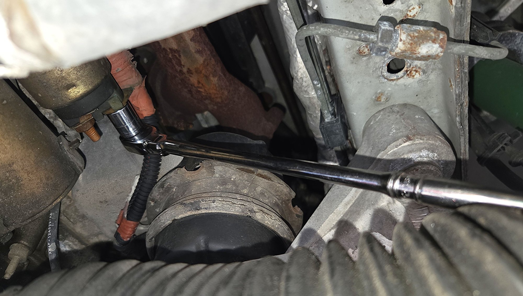

The battery power cable eyelet terminal is secured to the starter by a 13 mm nut. Various tools can work, but I used a ¼” drive long-handle flex-head ratchet and socket to remove the nut:
The battery power cable eyelet terminal was badly corroded with a trifecta of red rust, white oxide and green copper oxide.

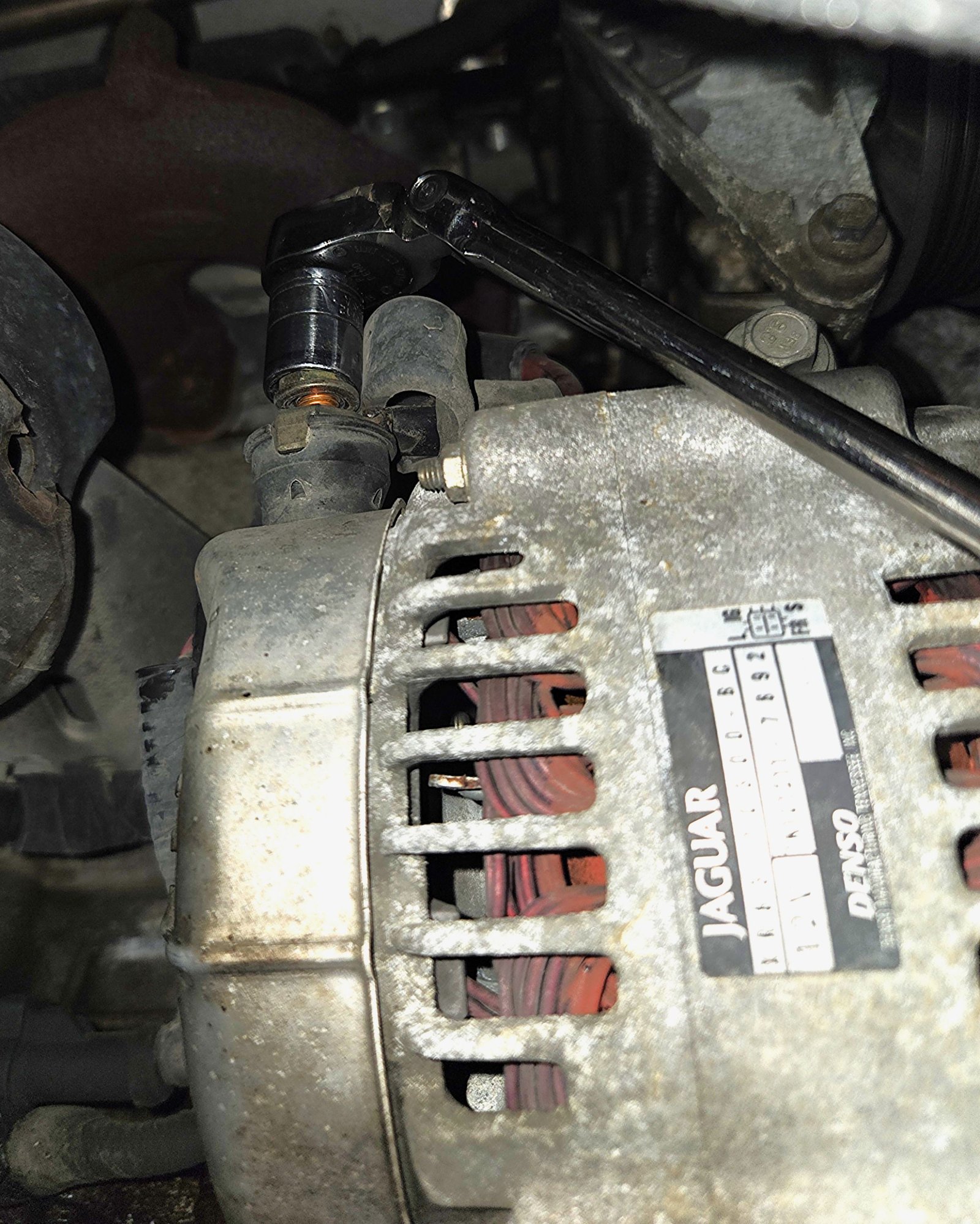

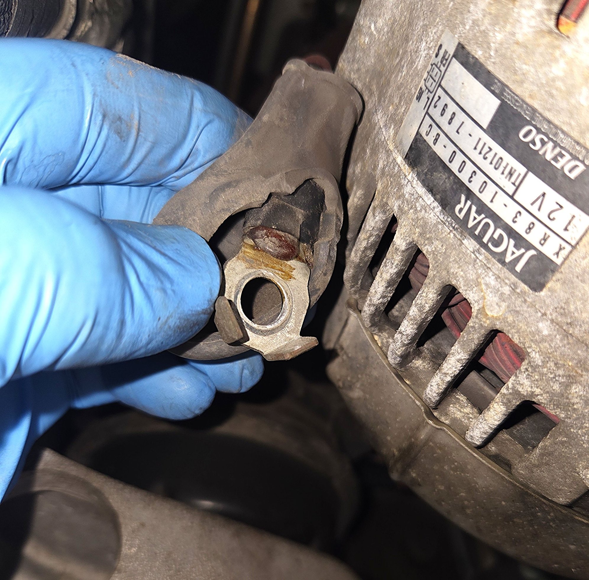

The alternator battery power connection is protected by a rubber boot, which can be pushed up the cable for access to the 12 mm nut.
I accessed the nut with my ¼” drive long-handled flex-head ratchet and socket.
The alternator power cable eyelet terminal was also covered in white oxide.
