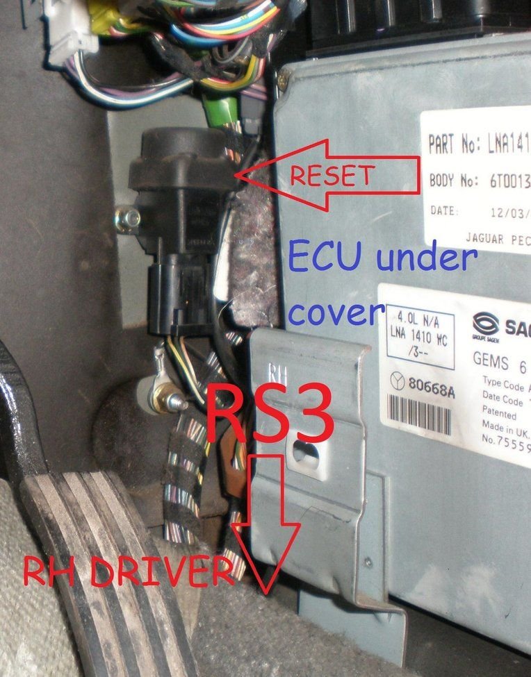

Ineria / Crash Switch can be fickle from reading others / kills fuel pump and engine , deos not always reset and can jumper the 2 white wires with a paper clip

Thanks V126man , The inertia switch will always be on the car's far right regaurdless if left or right steering model foward of the right hand door hinge under a up against the foot wall
This pic originated from another contributer and I snagged it but pics and files imposable to upload at this time
