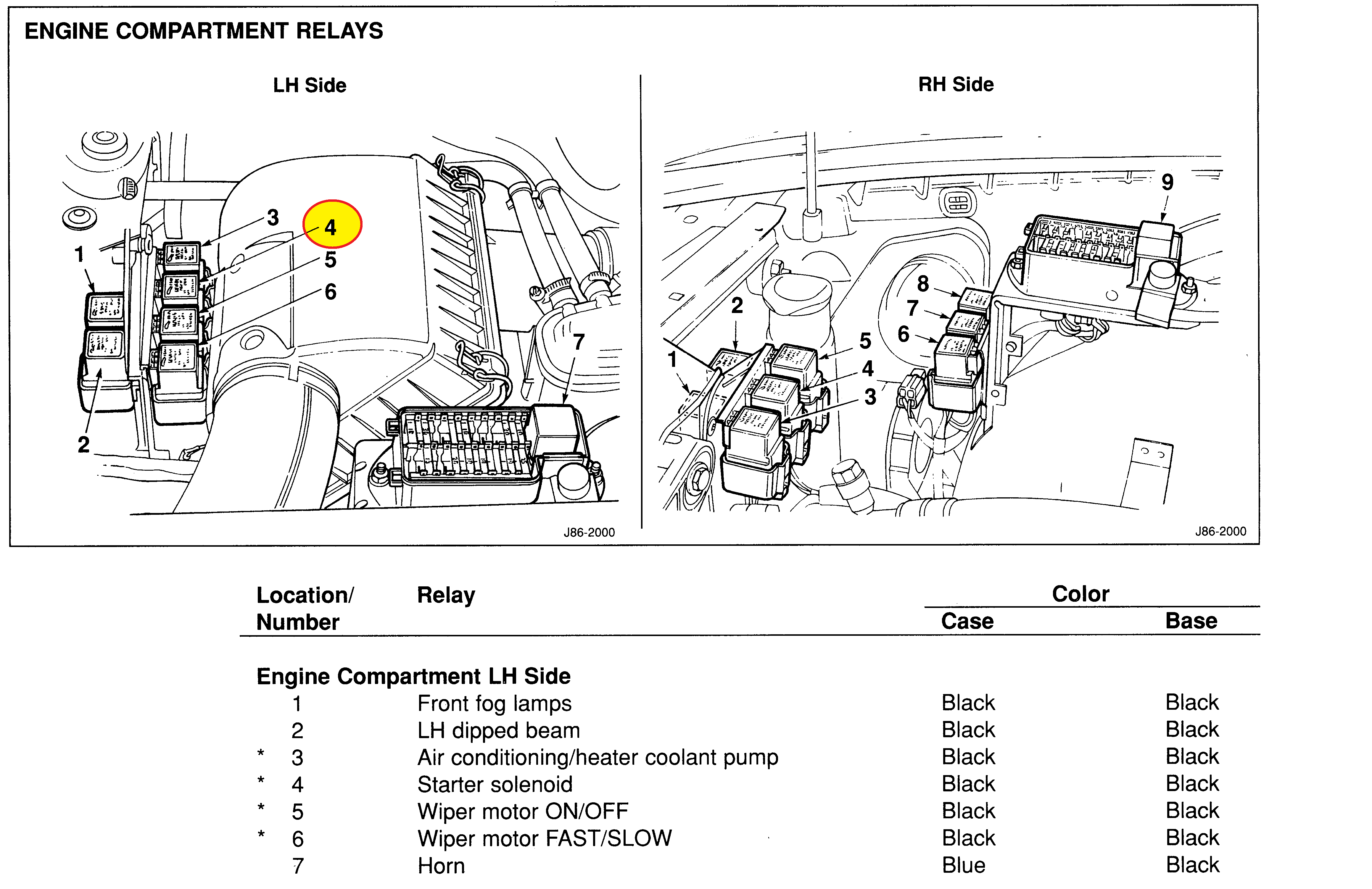

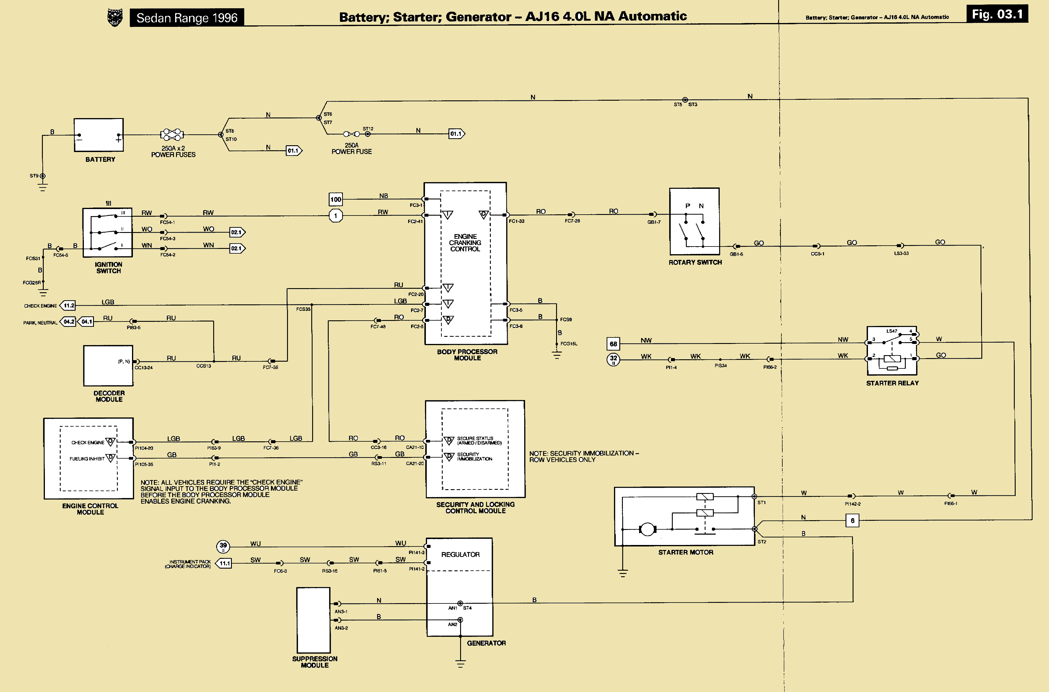

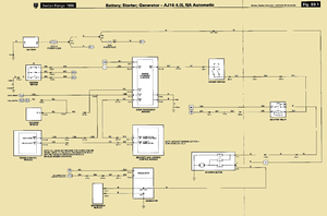

Starter Relay would be the first thing to look at . Can you tap on it ? Swap with same fog light relay . Spray with some penetrating oil as the plastic relay case sticks and is hard to get out . LNA6706AA can be found at local parts store
https://www.jaguarclassicparts.com/u.../relays/relays

try waggling the gear selector in park when it refuses to turn over. You may not have the selector adjustment quite right, and the starter inhibitor is not being disengaged. Waggling the selector often works pending permanent resolution.
