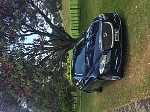

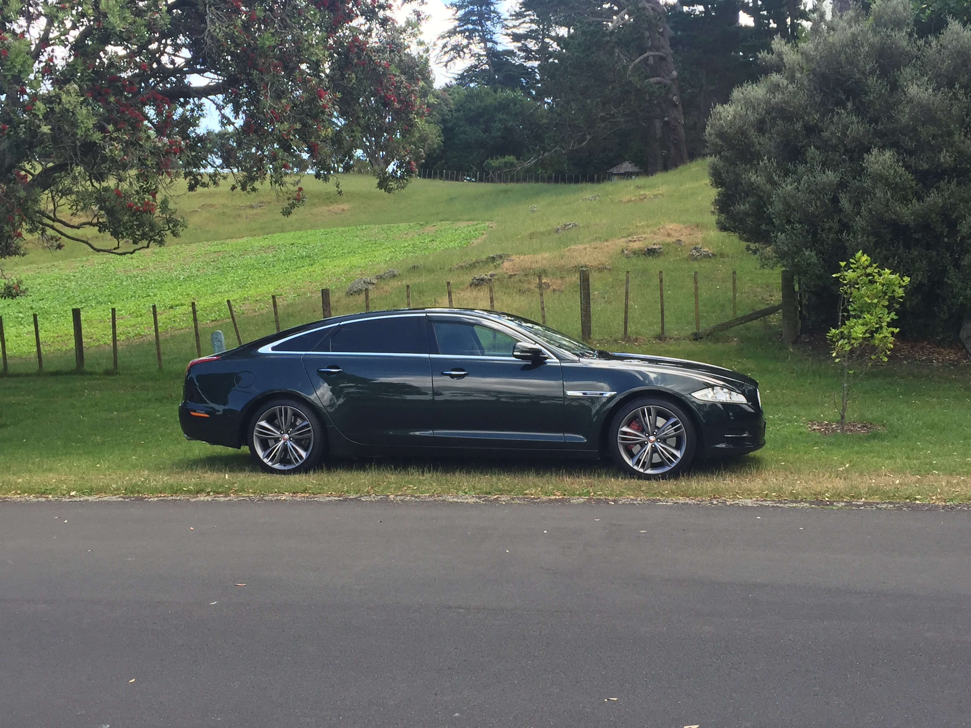

...or if I want more power, get this.
(2011 Supersport, 510 bhp)
Attached Thumbnails -16eea2da-7420-4116-8a47-9fec20f19fff.jpeg   -d88559be-1928-446c-8aa8-922ba5179b3e.jpeg
