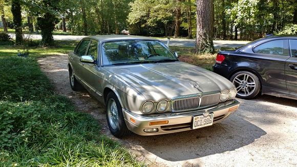

Are you in the USA or in the Netherlands? I know in the usa my 95 were SWB, even the Vanden Plas. A SWB Vanden Plas is a sexy beast......Here is mine.
It is a fantastic car..... Here is the thread I started after I bought it.
