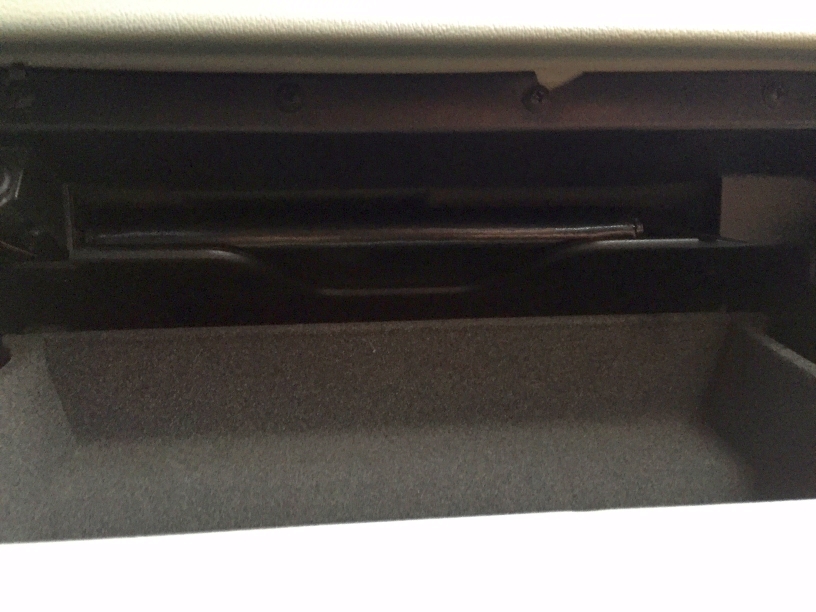

As can be seen in the "before" photo below, the upper plastic mounting surround for the glovebox often cracks around one or more of the four mounting screws. In looking at several examples on other cars I've noticed this is not uncommon. As the plastic ages and gets brittle this plastic trim cracks when the screws are tightened or vibration/shock stresses the area.

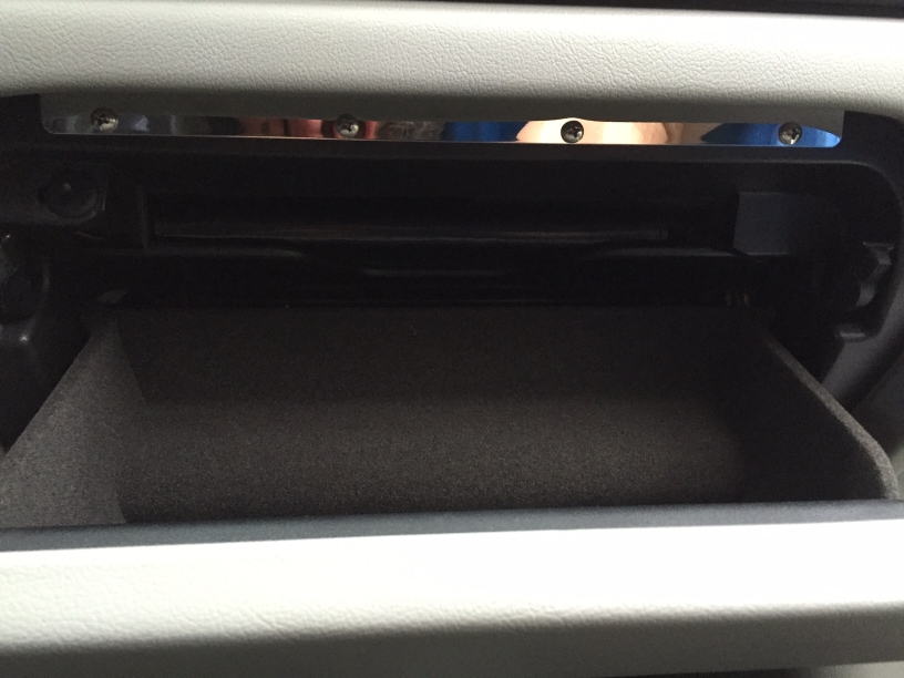

So I decided to cover and reinforce the area with a piece of fabricated polished stainless steel which I think fits well with the other styling details of the car. The piece covers the broken plastic, and also allows the mounting screws to be tightened down without breaking the plastic further.
If interested, I had "Stainless Supply" (www.stainlesssupply.com) make the part for about $2:
316L Stainless Steel Sheet #8 Mirror, 22G (.0293")
Width: 11/16", Length: 11" (26cm)
Cut Type: Shear
Round Corners: ABCD Radius: 3/16"
If I were to order again, I might get a slightly larger 3/4" width and get one gauge thicker so the part was a bit more stiff.
The total length of the piece is 11" (26cm) with all four screw holes spaced 8cm apart, with 2cm at both ends of the piece after the outside hole. The holes were placed 5mm vertically from the edge of the piece.
