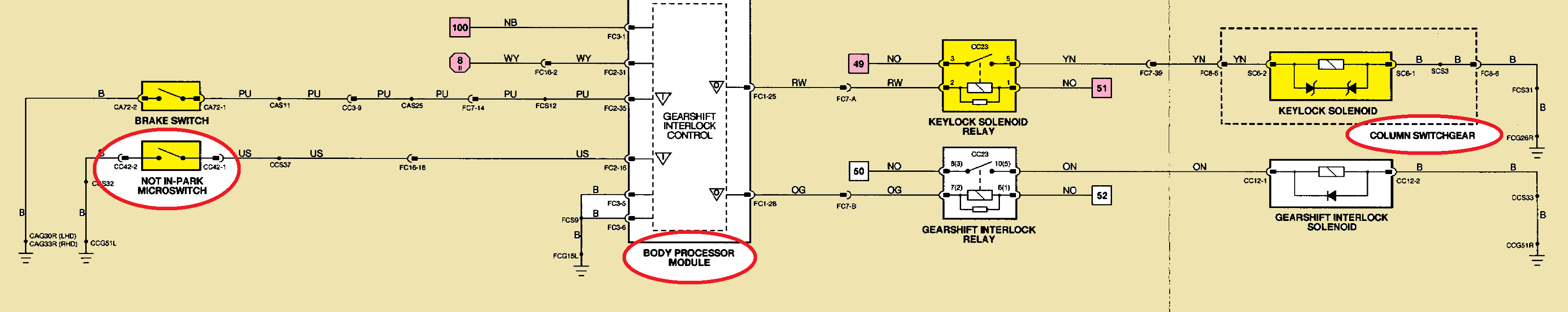

The connector above the fuel tank attached to the underside of the rear hat shelf could have migrated open as this will kill the starter enable . You can do a Jaguar " Hard Reset " of the Security ECU by removing the radio connectors first then turning the key to on , removing both battery terminals and touching them together for a few minutes then reinstalling on battery . Engine may be rough until it's ECU relearns the perimeters . You can put a paper clip in the inertia switch connecting the 2 white wires to bypass as that fails to reset .
https://www.jaguarforums.com/forum/x...dition-190492/
I'll get you a pic of the shift interlock relays later
Attached Thumbnails Turn key No Crank-x300-key-3-untitled.png   Turn key No Crank-x300-key-relay-untitled.png
