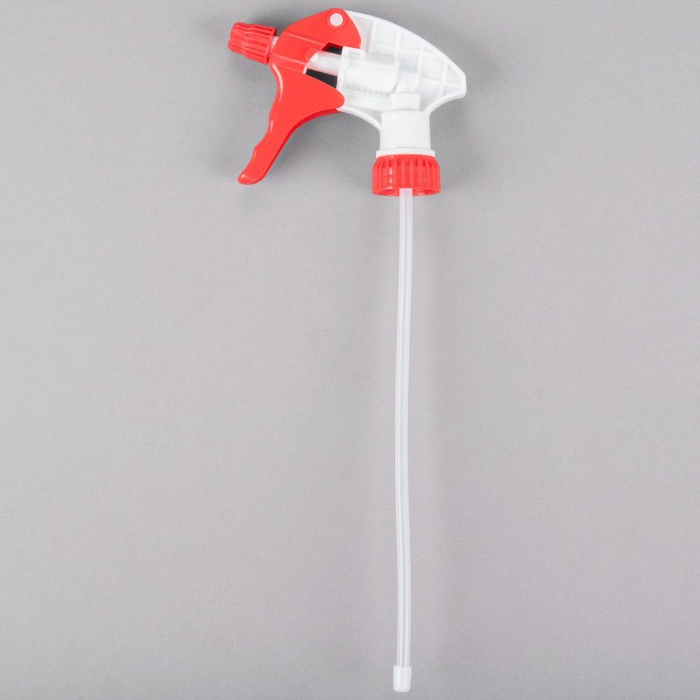

There are a few ways to remove the oil from the spark plug wells.
A Mityvac vacuum pump of the type used for bleeding brakes works well.
A similar method is to remove the trigger spray nozzle from a bottle of Windex glass cleaner or similar product. Insert the long intake tube down into the spark plug well, hold a doubled-over paper towel over the spray nozzle, and squeeze the trigger repeatedly until nearly all of the oil has been sucked out of the plug well and sprayed onto the paper towel.
A syringe with a length of vinyl or rubber tubing can work. I have some similar to the one in the photo below that are very handy in the shop:
If you don't have one of the above, you can wrap a corner of a paper towel around the tip of a long flat-bladed screwdriver, and while holding the opposite corner of the paper towel, insert the screwdriver down the plug well and into the puddle of oil. Allow the paper towel to wick up as much oil as it can, then pull it out by the corner you're holding onto and throw it away. Repeat with clean towels until nearly all of the oil has been wicked out.
When nearly all of the oil has been removed, you can remove the spark plugs and use the paper towel and screwdriver method to clean any residual oil from the wells. I usually finish each plug well with a spritz of carb cleaner, brake cleaner, electronic cleaner, etc., whichever is closest to hand. The solvent will help wash any remaining oil film into the cylinder where it will be quickly burned away when the engine is started.
