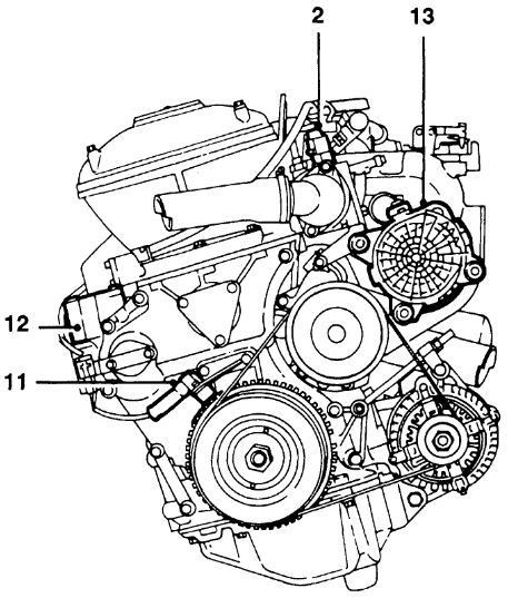

I didn't take the time to search JTIS but the parts diagram below is probably all you need.
Disconnect the battery negative cable and secure it away from the battery negative post.
Remove or disconnect and displace any components that obstruct your access to the alternator.
If you can access the electrical connectors on the back of the alternator, disconnect and displace them. If you can't access them now, you can do this later. I seem to recall that access to the rear face of the alternator is improved with the oil filter removed (working from underneath).
Loosen but do not remove nut 4/bolt 3, nut 11.and screw 14. Loosen the part 10 nut on the right, then wind the part 10 nut on the left down the adjuster bolt, part 9, toward its pivot eye. This will release the tension on the alternator belt and eventually you will be able to pull the belt off of the alternator pulley. Off the top of my head, I don't think it is necessary to remove the A/C compressor belt unless you are going to replace it. If so, it has its own adjuster.
Once the alternator belt is displaced, remove nut 4 and bolt 3 and screw 14, and if you were not able to access the wiring before, support the alternator now and turn it for access to the electrical wires that connect to the back face: Now you can withdraw the alternator from the vehicle.
