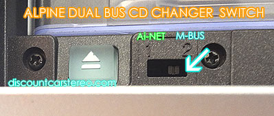

As you may already know, Alpine M-BUS (older) is very slow compared to the new Ai-NET BUS and is one reason M-BUS Radios are not able to control Ai-NE CD Changers, however Alpine did make some CD Changer capable of working in Ai-NET and M-BUS Applications, namely Dual Bus Changers. These changers have an Ai-Net connector which the ALP/Ai-F converts to 8-pin DIN. Alpine CHA-S634, CHA-S614, CHA-S607, CHA-S604, VPA-S001 are DUAL BUS and the ALP/Ai-F allows them to connect to an M-BUS Radio (e.g. CDM-9801) or factory Alpine derived radios in older Honda, BMW, Volvo etc. (CD Changer adapter required).
This cable is approximately 6-inches long and has a Male Ai-NET plug and Female 8-PIN DIN
Successful Application Example:
1. You have an Alpine M-BUS headunit (e.g. CDM-9801) and a CHA-S634 Dual bus changer. Purchase the ALP/Ai-F to connect the CHA-S634 to the CDM-9801 M-BUS Changer controlling radio. Note that the M-BUS cable (Sold separately) is also required and switch inside the Changer door must be set to position 2 (See detail images).
2. To connect the CHA-S634 Changer to a BMW OEM Radio: Purchase the ABMW35v2 (BMW-Alpine CD Changer adapter) and the ALP/Ai-F. Note that the M-BUS cable (Sold separately) is also required and switch inside the Changer door must be set to position 2 (See detail images).
