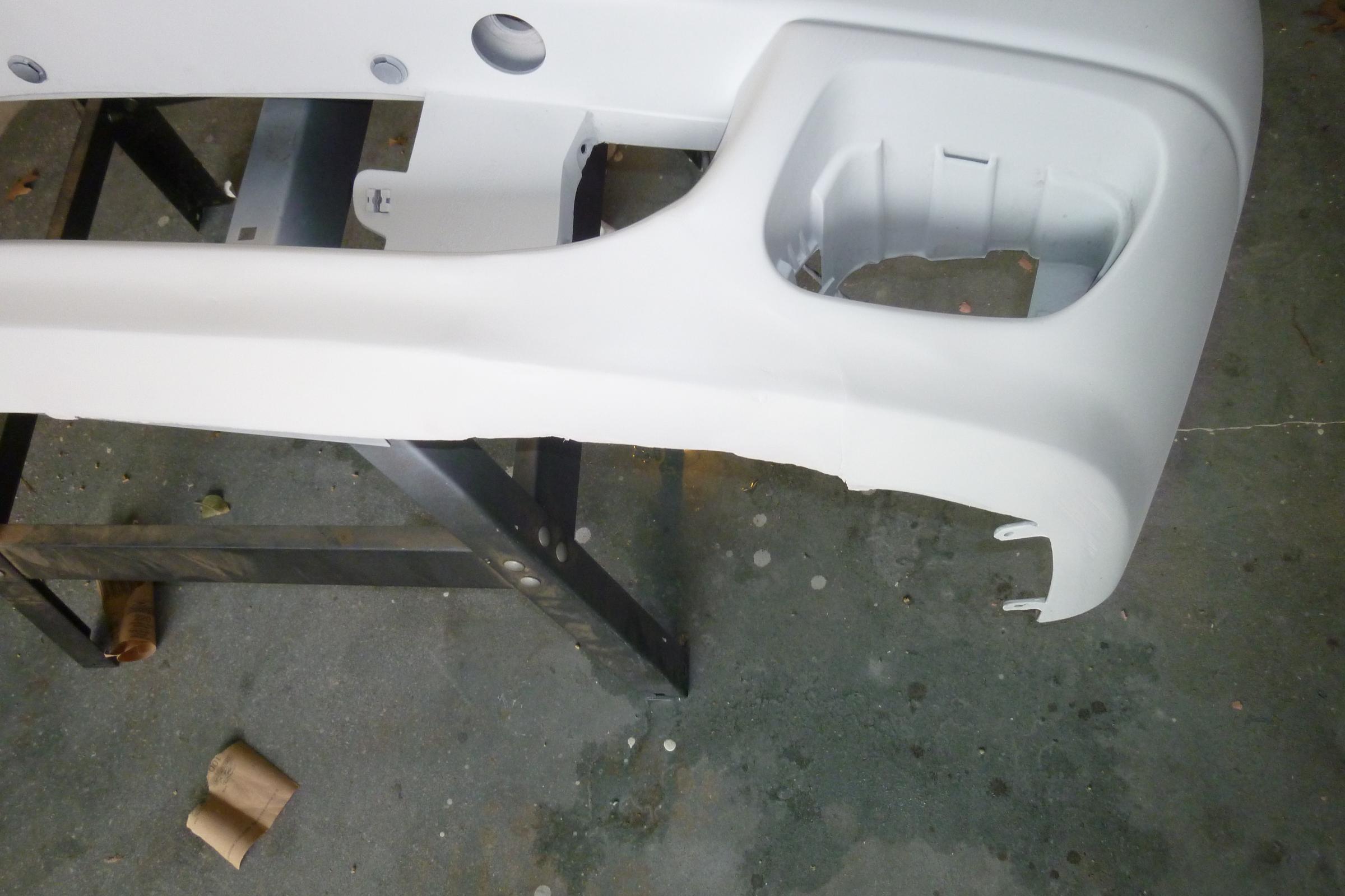

I just looked at your post.... wow It looks great, I'm curious did you have the complete repaint job? . I just repaired my front bumper after a snafu in a parking lot. you can see my posting below with pictures....... my car roof is suffering from "orange peel" on my roof plus some other dings and dents so a complete paint job will be in the near future..... any advice you have would be great.

Hi 95xjrblack

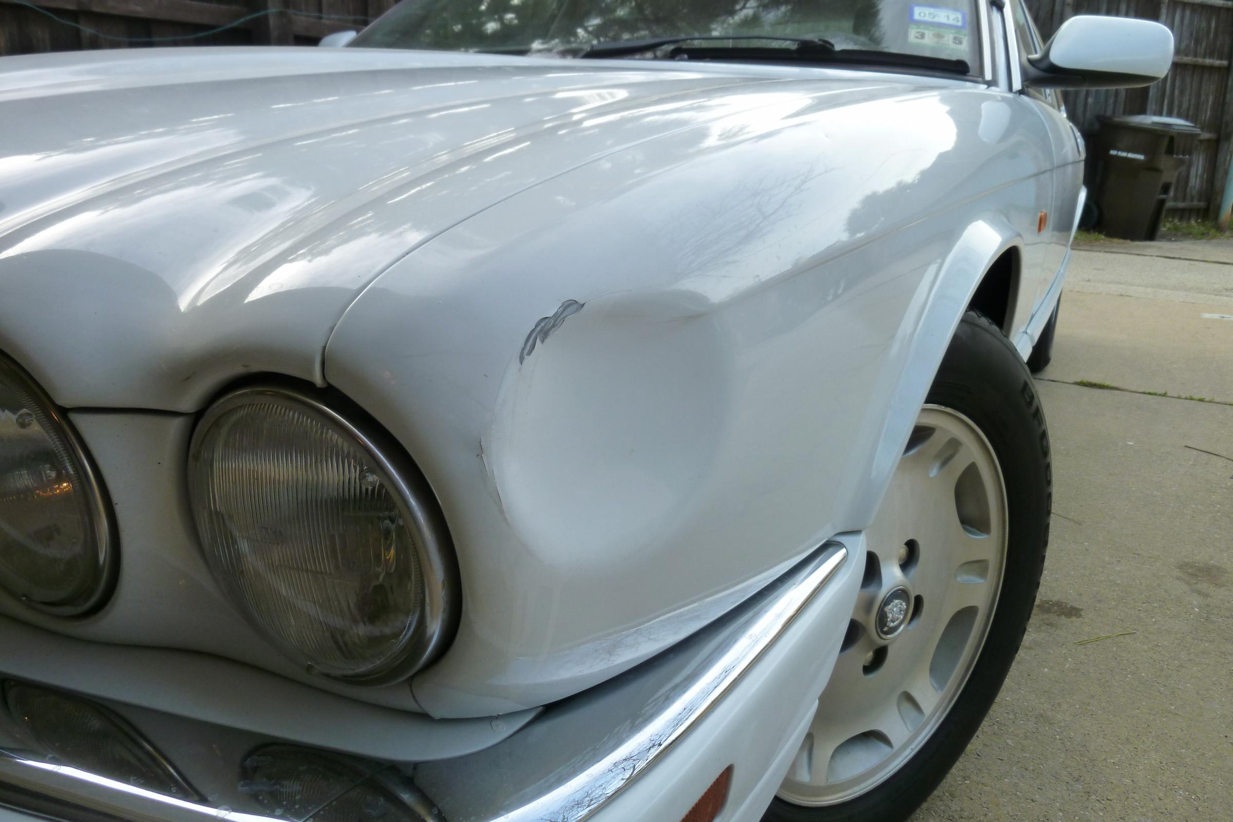

Thanks for posting those pics... I just finished repairing my front bumper see attached pics...... , I have serious dents on both LH and RH front fenders that I have to tackle plus a few minor dings. Then prep for paint. I have noticed orange peel on the roof..... So it looks like a full paint job will be needed. I will certainly give the boys on Story Rd a call since they look like they know what they are doing.. I'm in Plano so Irving is an easy option......

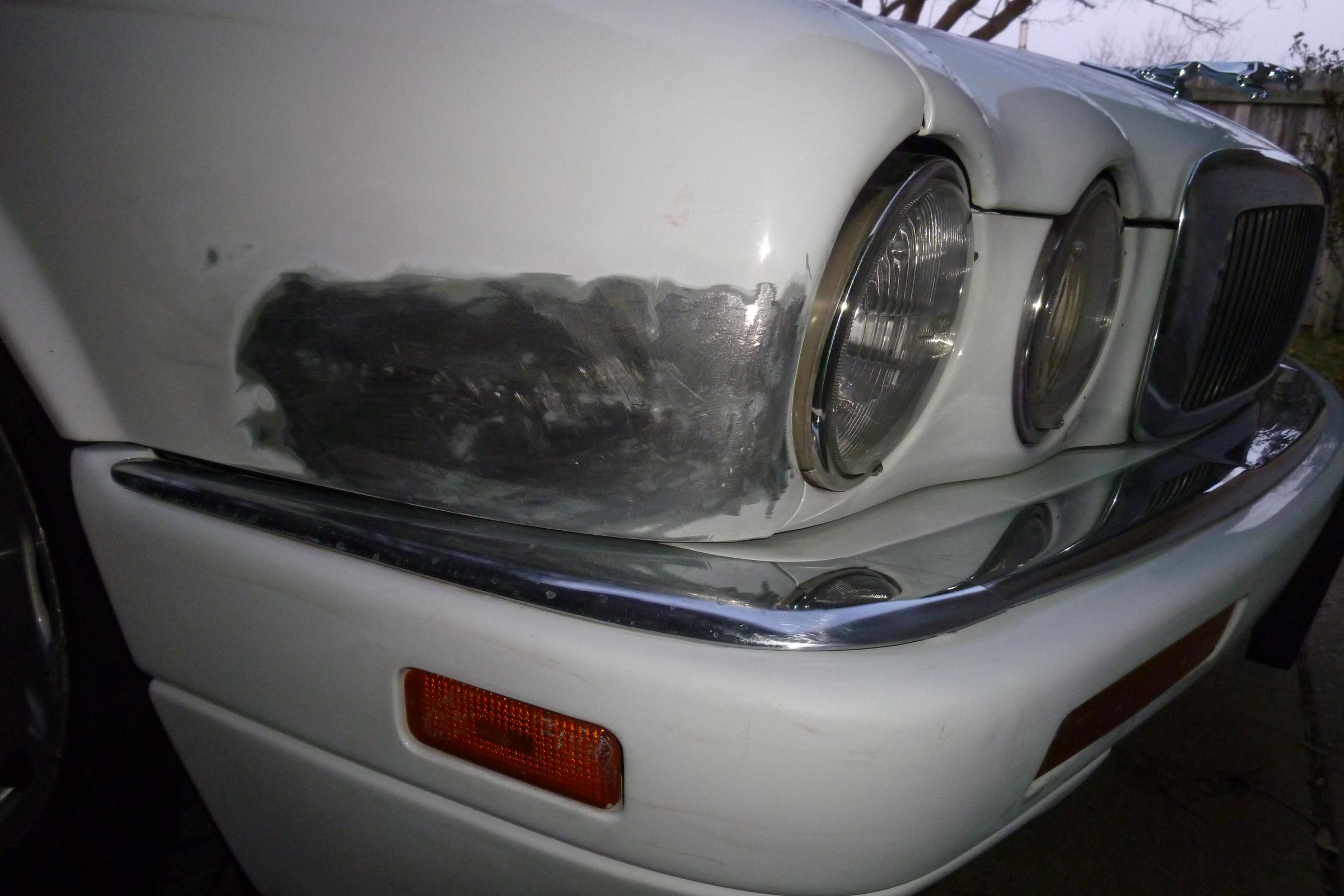

Just to follow up, I fixed my front bumper as per the repair pix..... I'm now working on the serious front LHS panel dent........ I know I'm not going to get the line perfect but close enough that I can live with it, see attached pics...... It's getting ready for primer.... and paint

Hey big boss, I see you're turning into a proper bodywork man!! You will get the line/finish etc. perfect, if you stay at it. Don't be in a hurry to see it finished, 'cos you'll be looking at any imperfections forever!
If you put on primer and it still doesn't look right, rub back, fill where needed, rub, prime etc. etc. You will get there and keep up the good work!

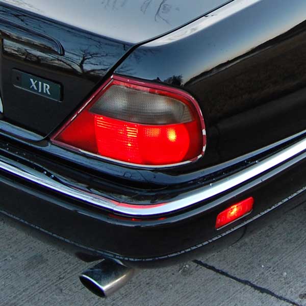

My tail light bezels were losing their red coating and looking pretty bad against the car's fresh paint. So I removed them did some careful masking, sanded off the old red paint and resprayed them with Valspar spray paint for plastic surfaces. The color is a bit brighter than factory, but think they turned out pretty nice. Cost under $10 and super easy!
Before:
After:
Before:
After:

WOW.... nice job....... You seemed to have nailed it correctly....... back to the factory finish. It looks very sharp.

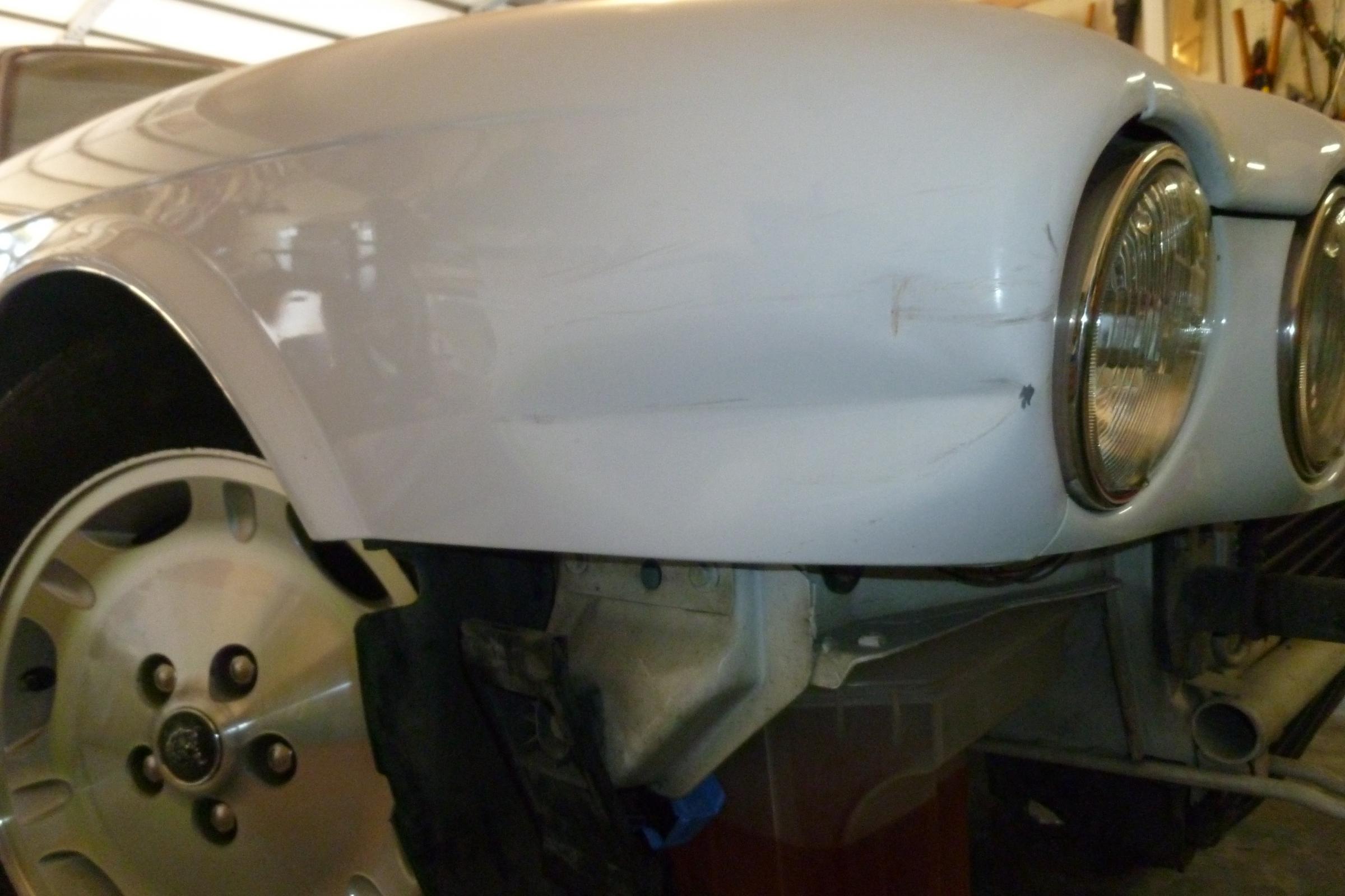

I'm working on my LHS fender/quarter panel getting out the dents that have bugged me for so long. I ended up removing the complete panel so I could get access to a dent up by the hood and the driver side door. It turned out not to be too difficult to do, since the panel is "bolted on" with 10mm screws,not welded on. It does require the bumper to be removed. I'm attaching some pics here for anyone that wants to know how it's done. Today I will remove and tackle the RHS panel and work on 2 serious dents on that side. Then prep, fill, sand to get ready for primer and paint. see attached pics. Now if I could only figure out what type of primer and paint to use? I'd be in business. So if anyone out there has any ideas on primer and paint I'd love to hear from you.

Thanks for the encouragement.... The dents were bugging me so I decided to tackle the job and get it done while I worked the "Bumper Issue".
I ended up removing the LHS Panel to get at a dent up by the hood (bonnet) and piller. I did make a small investment in a "Fender Hammer and Dolly" set". I got it for $25. So does that make a "Panel Beater" now? Who knows. There are so many great videos on uTube that show the techniques and details of how to do it. So today I will remove the RHS panel and work on dents there. Then get to prep, Fill, Prime and then Paint. Now if I could figure out the correct primer and paint type to use I'd be in business.

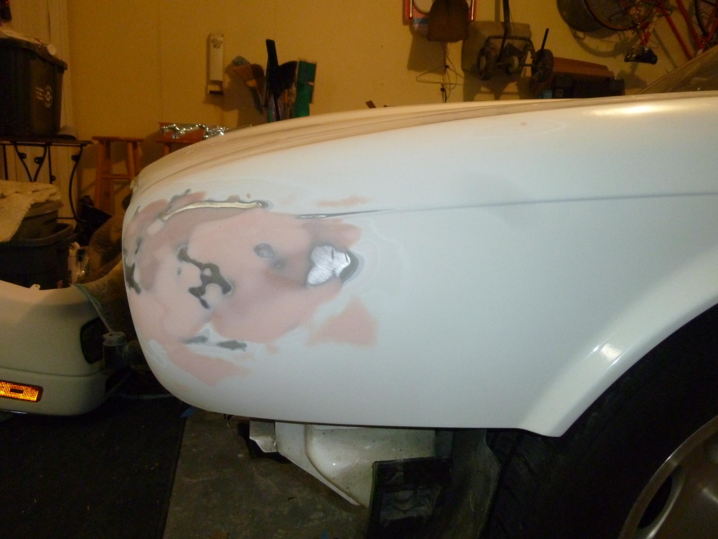

I removed the RHS panel yesterday and worked on the 2 nasty dents, see pics here. It took a little effort but managed to get them out and and sanded down to bare metal ready for prep, fill and prime.
