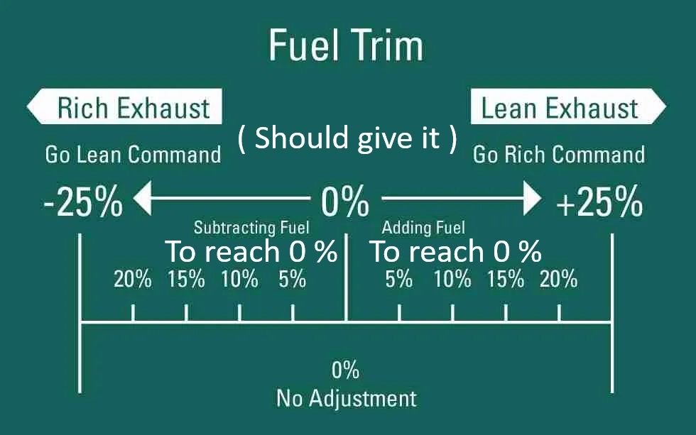

Can you read the LTFT from the OBD2?
It will help diagnose your issue...

Your LTFT and STFT is target 0 % although not perfect

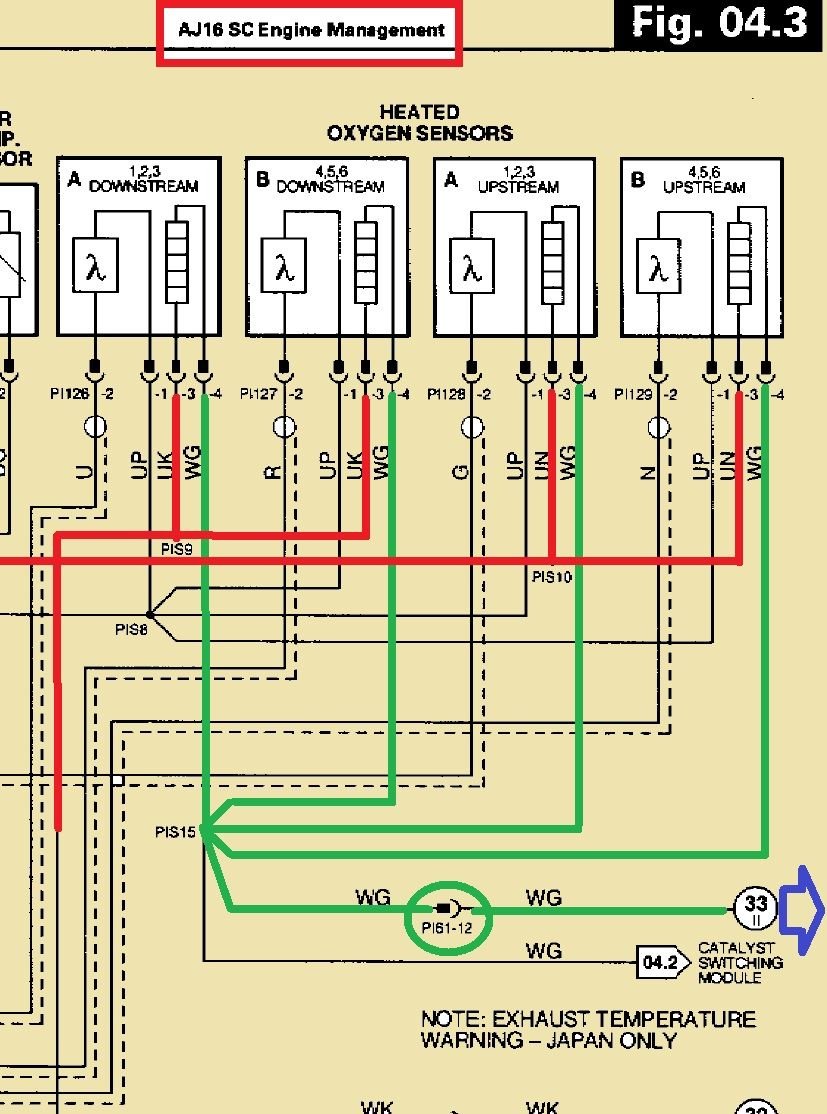

To read the heater on your hard to get to SC you can read them at the Engine ECU ( red connector ) of approx 600 ohms , and there is the Papa Indy 61 connector position 12 ( White / Green wire ) subject to a TSBs on corrosion , heaters are 1/ 2 the problem and can be easily read through the sensor and then you know

There is also the crossing of the O2 sensor connectors as they are physically the same , many have done and there where correction results
On the above O2 sensor wiring guide the 4th wire color is different on the car side , so you are looking at the U , R , G , N sensor itself return wire
You would have to use this pic to be physically following the pipes
