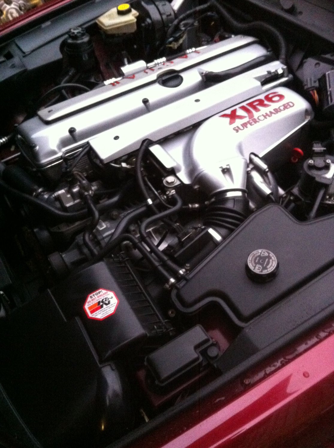

Getting the last 'good days' of driving in for 2014!
Found a break in the weather few days ago so took the jag out for a blast. Probably cursing myself by saying my car has not let me down in ages (apart from MPG!) it's had the usual coil pack and exhaust manifold issues in the past, so the only job planned for the near future is the top tensioner. (Slight rattle on a cold startup). Has anyone found the need to replace chains/guides etc, or should I just try the tensioner for now?
