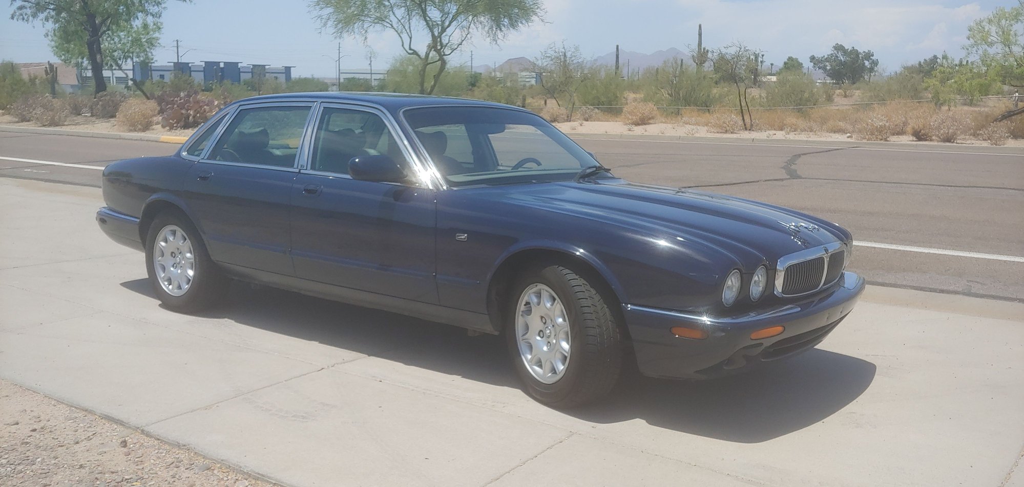

Read thru years-old threads of how to pop the hood open when driver side won't release. Can't believe it's such an involved process, including drilling a 1" hole. Anyone have an update, like a metal coat hanger under the back edge of the hood to pull it? "Hope springs eternal"
