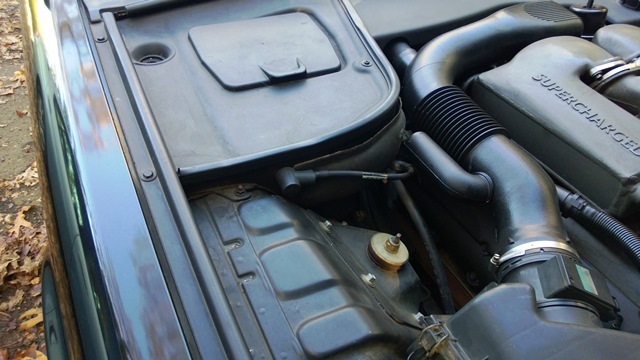

Default Positive Post and Key Hole
Probably a silly post, but I'm guessing the 1999 and 2001 are different in this respect? I've actually got a keyhole on the left of the XJR Emblem for the trunk.
And just for future, here is the Positive Post under the hood. I use this to connect a battery charger for my RC Airplanes and Heli's.
Attached Thumbnails 01 XJR Battery dead, keys won't open trunk-wp_20121124_001.jpg   01 XJR Battery dead, keys won't open trunk-wp_20121124_002.jpg   01 XJR Battery dead, keys won't open trunk-wp_20121124_003.jpg
