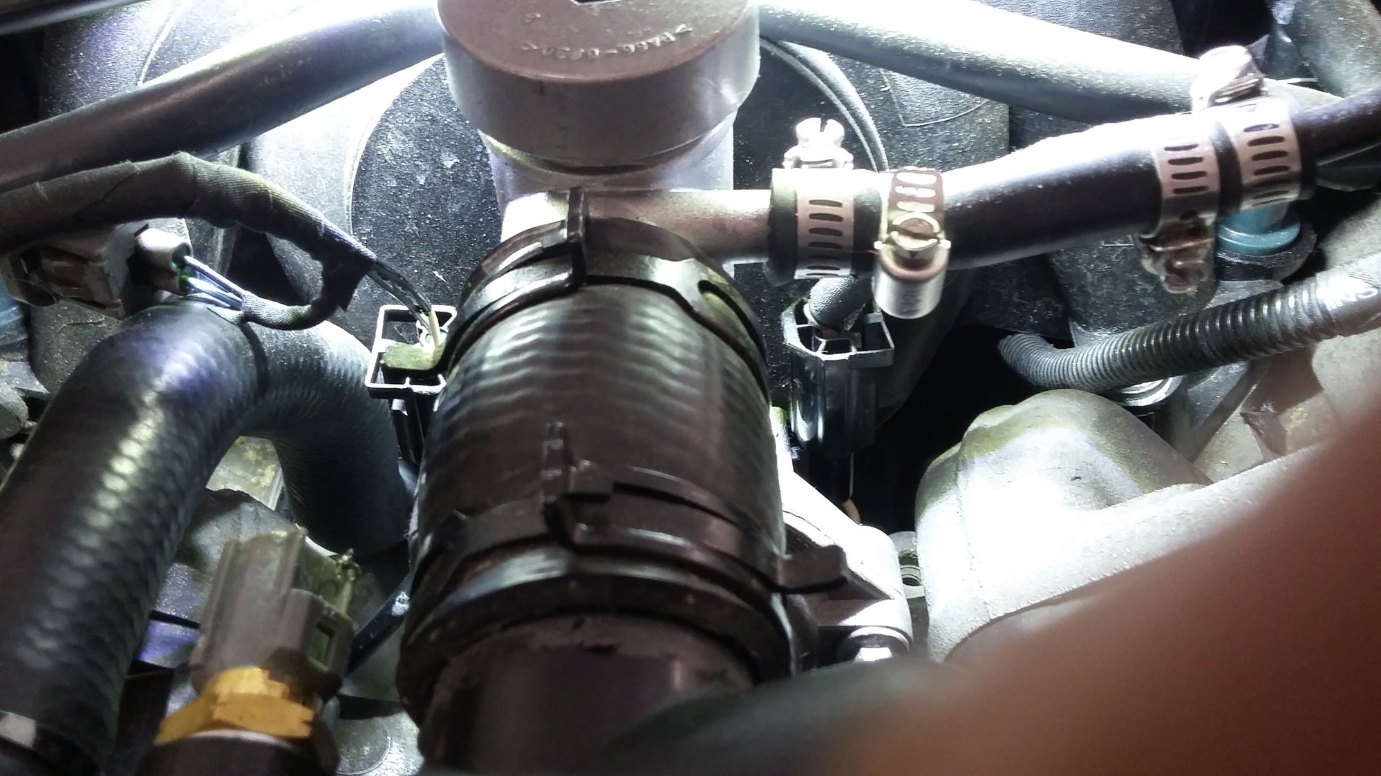

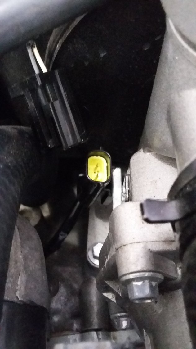

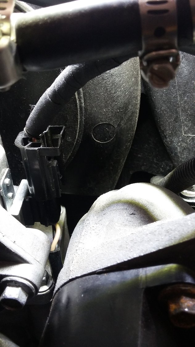

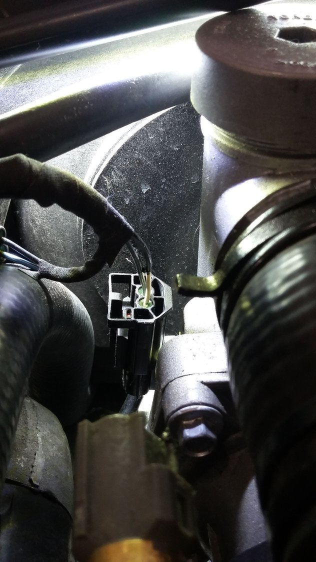

Do you own a multi meter? Any one that reads ohms will work just fine set it to a low scale and test the knock sensor.
squeeze the Connector and pull straight up. Test those 2 pins. One on each side the thermostat housing.
