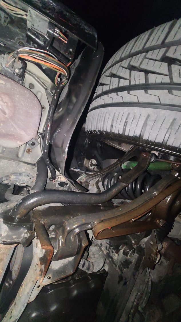

I’m a long-time Jaguar enthusiast and recently picked up a 1998 Jaguar XJR (X308, supercharged 4.0L V8), but ran into an issue mid-trip and had to leave the car safely parked near West Wendover (NV/UT border off I-80) Where you'll find the casinos.
The issue appears to be a failed water pump—once up to temperature, coolant builds pressure and pushes out of the expansion tank when rpms raise. I stopped driving as soon as temps began rising to avoid engine damage apon approaching Utah from Nevada (at night 1am).
Prior to purchase, the cooling system was pressure tested with no leaks, the car passed CA smog, and it was running well with no warning lights. Oil was just changed, alternator rebuilt, and battery replaced belts changed, brake pads changed.
The car has brand new tires, clean body, solid interior, and all electronics/speakers were working properly. Estimated ~139k miles (odometer replaced previously) only issues is one low beam bulb.
While diagnosing, the right-side hood hinge became stuck (common X308 issue), limiting further access. I had flown out with no tools and was 2000 miles from home, so I made the decision to leave the car rather than risk further damage.

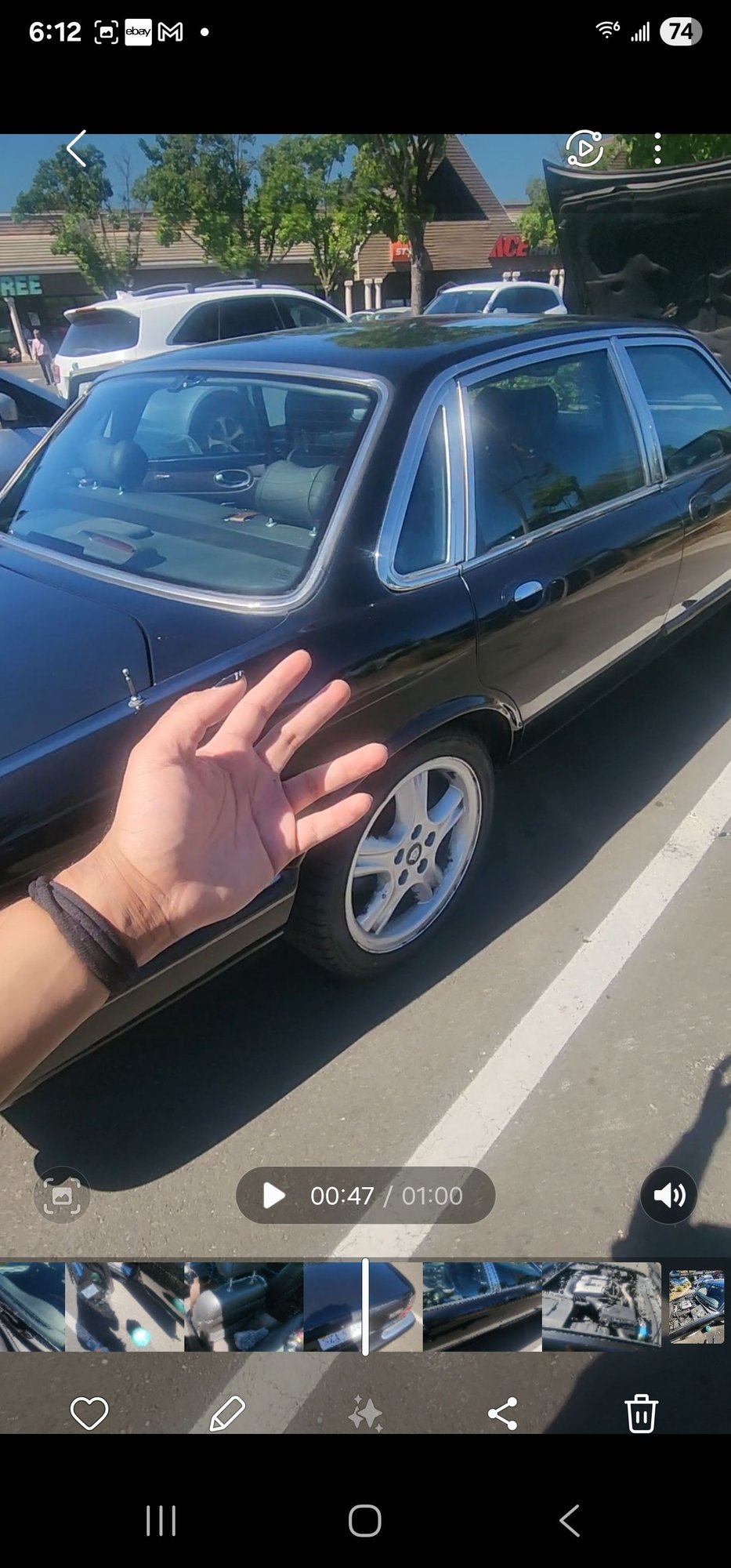

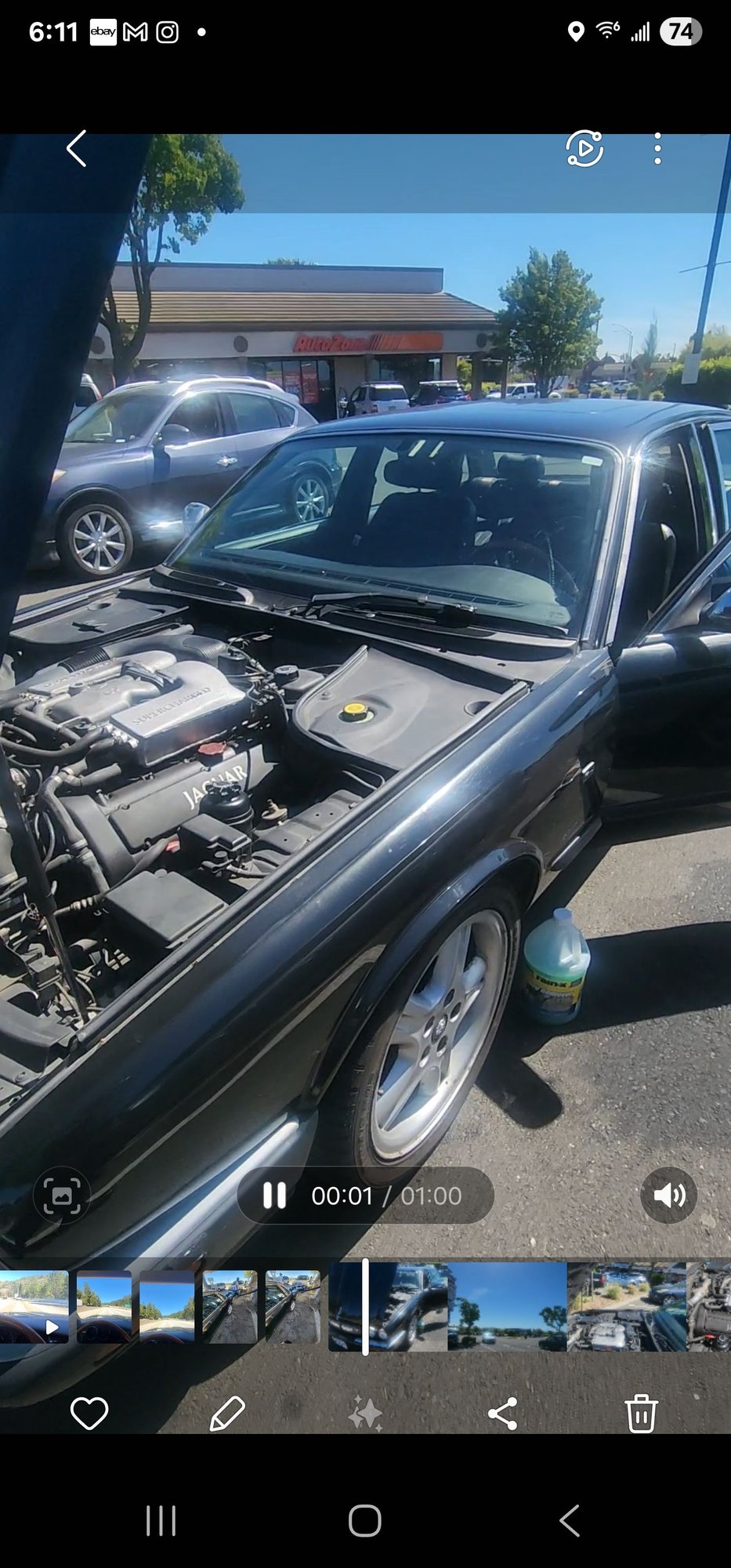

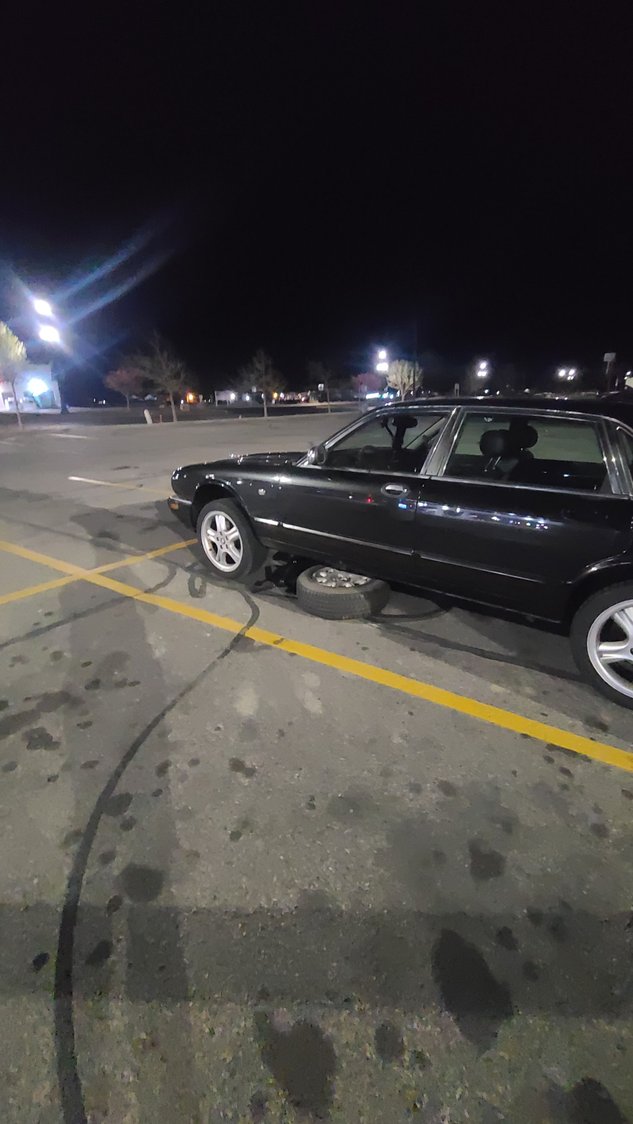

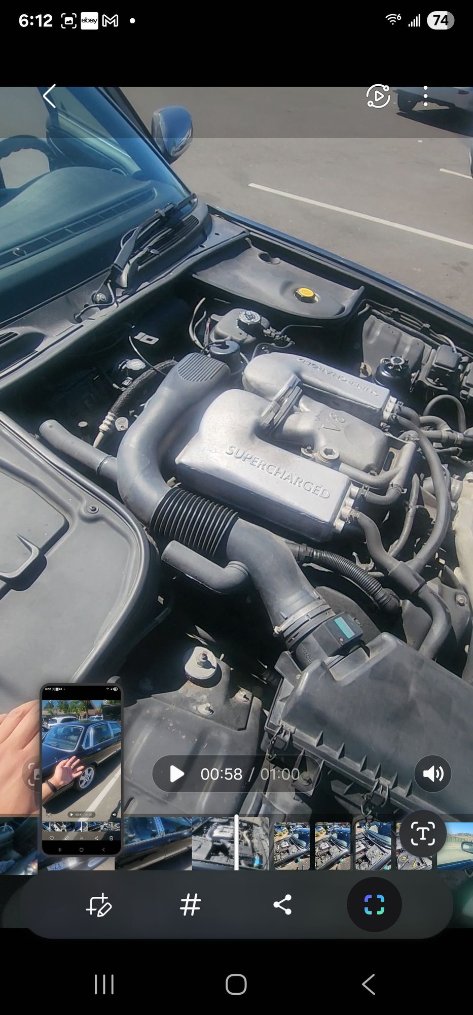

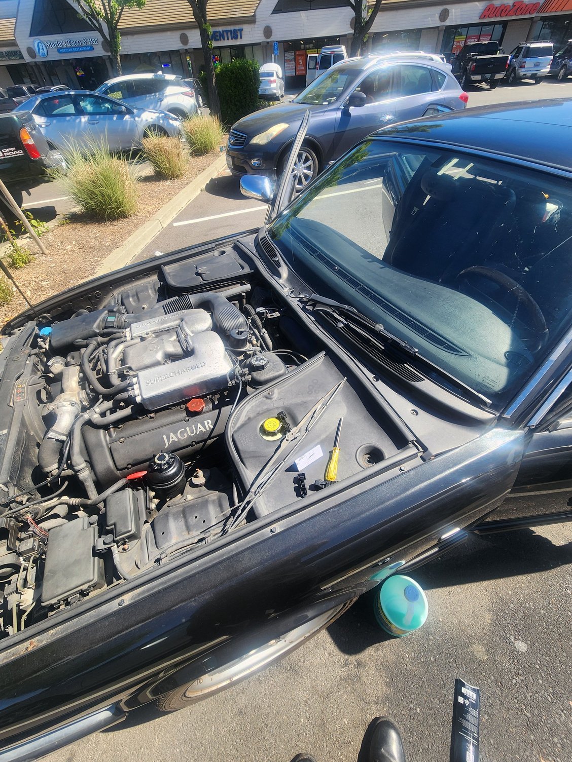

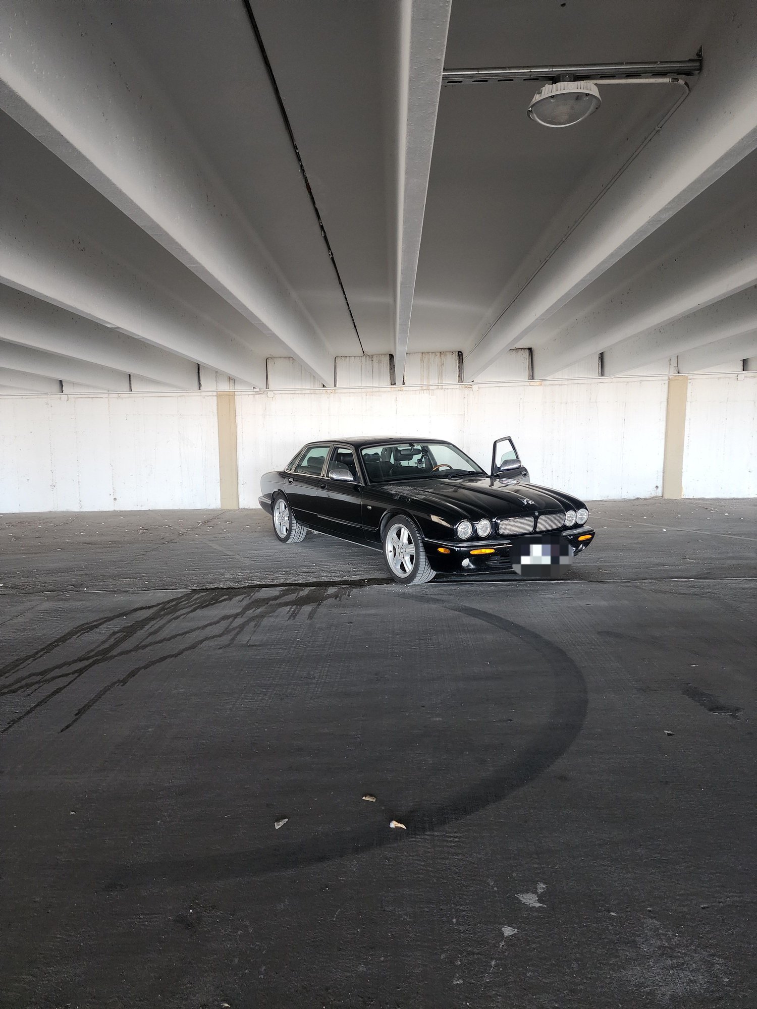

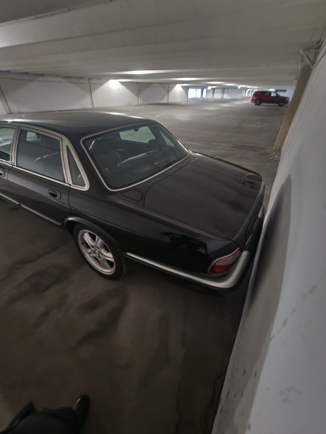

Below are pictures took before purchase, during trip-- and where it is now (all in order). If asking where exactly it is message me please.
After purchase during San Fran to Neveda
After Road Trip
Where it sits now till I find a solution for the next part of its life.

Maybe water pump (lots of coolant up front).

Make sure the coolant 'air-bleed' lines to the reservoir are routed correctly!!!!!!
I have seen MANY instances of the lines NOT crossed because 'it looks weird' and people install incorrectly.
I looked at the picture of the left front suspension and thought "lower part of the coolant hose" then remembered that OP said the coolant pushes out of the expansion tank, which would mean it's going to the overflow tank. If that tank is spewing coolant, yea, that's a lot. If the original WP is on there, then it's a good chance that it finally failed. The WP's with the (iirc) white impeller failed a lot and the replacement was a black impeller with the tighter fit on the shaft. There was also one with a metal impeller, but those didn't pump as well as the plastic ones.
Considering it lasted close to 700 miles and more than 4 hours of driving. I doubt the lines were wrong, it was a failure during the last leg of Neveda. I'm some what familiar with the coolant setup having the N/A 4.0 in the XK8 minus the supercharger
I believe it was the original, hoses were all in good shape but I didn't do my full due diligence to check if the water pump was upgraded. The shop didn't have the history on the pump, just alternator and some other things that I couldn't confirm from my inspection visually with my knowledge of jags and working on them

your photos show your hoses are correctly routed: I was about to send a photo to show the correct rout, then looked again at all of your pictures.

Attached is the picture showing the routing of the overflow hoses: what Bob was saying was if they don't cross over, you will spew coolant . . . but yours looks right.
