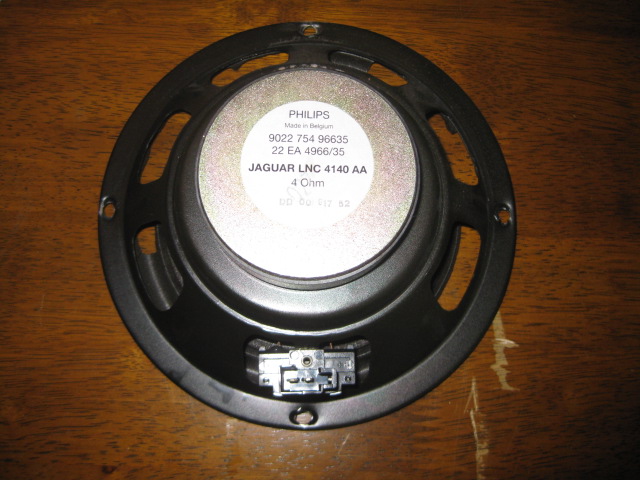

I have the base model xj8 tape deck, cd changer no sub and 5.25 4ohm door seperate speakers on the doors. I I am looking for a radio fascia and wiring harness to add an aftermarket radio in the console and I am wondering if there is wiring live already for adding the 6x9 subwoofer on the rear deck.

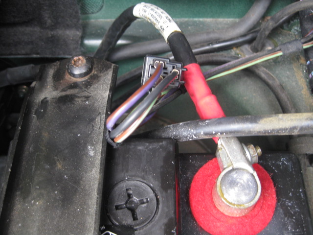

I found a 3 wire connector in the trunk near the battery and was wondering what is it.

That connector doesn't do anything- I've seen it a few times on multiple XJ8/Rs.

The 6x9 speaker harness may be behind the trunk carpet if you pull it away from the petrol tank, there should be 2 sets of wires as the original speaker is duel voice coil.
The wiring you show is either for aux 12v or for original shipment, a shipping module to protect circuits while the car is in transit/being shipped. This was removed at the dealers'.

Well, do nothing until you plug something to it.
It is an accessory connector ( the car has 2 of those, the other one is by the right kick panel).
Jaguar had a few accessories that were designed to use those connectors.
Each connector has 1 ground, 1 live + and 1 switched +
