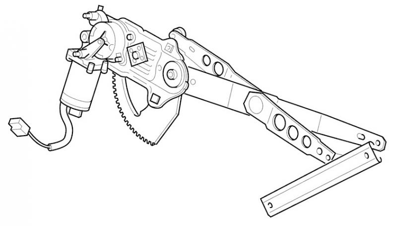

Hi guys,
Been searching for a few hours now with no luck so I will ask the All Knowing. How do you remove and replace a door window glass and power window motor?
With difficulty - it's not something I like doing!
First is to remove the door card, plenty of how to's on the forum using the search function.
Once your clear of that job, you'll need to remove the foam sound deadening and plastic rain guard, then you'll be able to see the window motor and quadrant.
With the glass all the way up, tape it to the top of the door frame with Gaffa tape so as not to let it drop down into the door. (unless glass is shattered of course)
Release the motor and mech bolts and wiggle it free and out. Glass, hmm, not easy.
It's a mornings work of sweat, swearing and tight fitting parts, good luck!

Here are 5 PDF Files that contain instructions on replacing front door window on XJ (X308):
2001 XJ Front Door Windows Regulator R&I.pdf
Front Door Trim Panel 76.34.01
https://www.jaguarforums.com/forum/a...l-76-34-01-pdf
xj (x308) Front Door Module R&I 86.80.34.pdf
Front Door Finish Panel 76.47.11
http://https://www.jaguarforums.com/...l-76-47-11-pdf
Front Door Armrest 76.34.22
https://www.jaguarforums.com/forum/a...t-76-34-22-pdf
