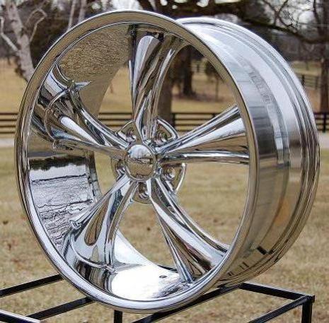

i think I going to sell my brand new wheels for exchange of these.anybody think these would look good in 20 x 8.5 and rears 20 x 10? on a silver xjr?

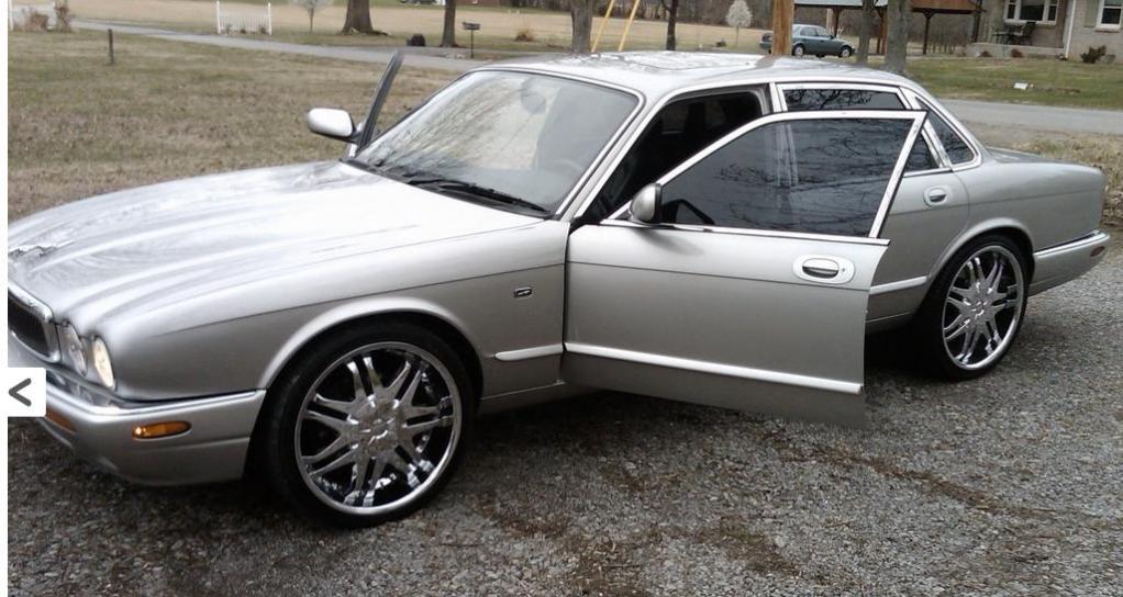

those are sweet, i was thinking of something like this, I dont want to be called some 'mississippi pimp' though.. I just like the chrome on these rides what can i say lol.
so jimmy you dont think 245/40/20 is possible without raising the car? Im guessing the 245/35/20 is pushing it as is?

I have been told 245 35 20 is it.
