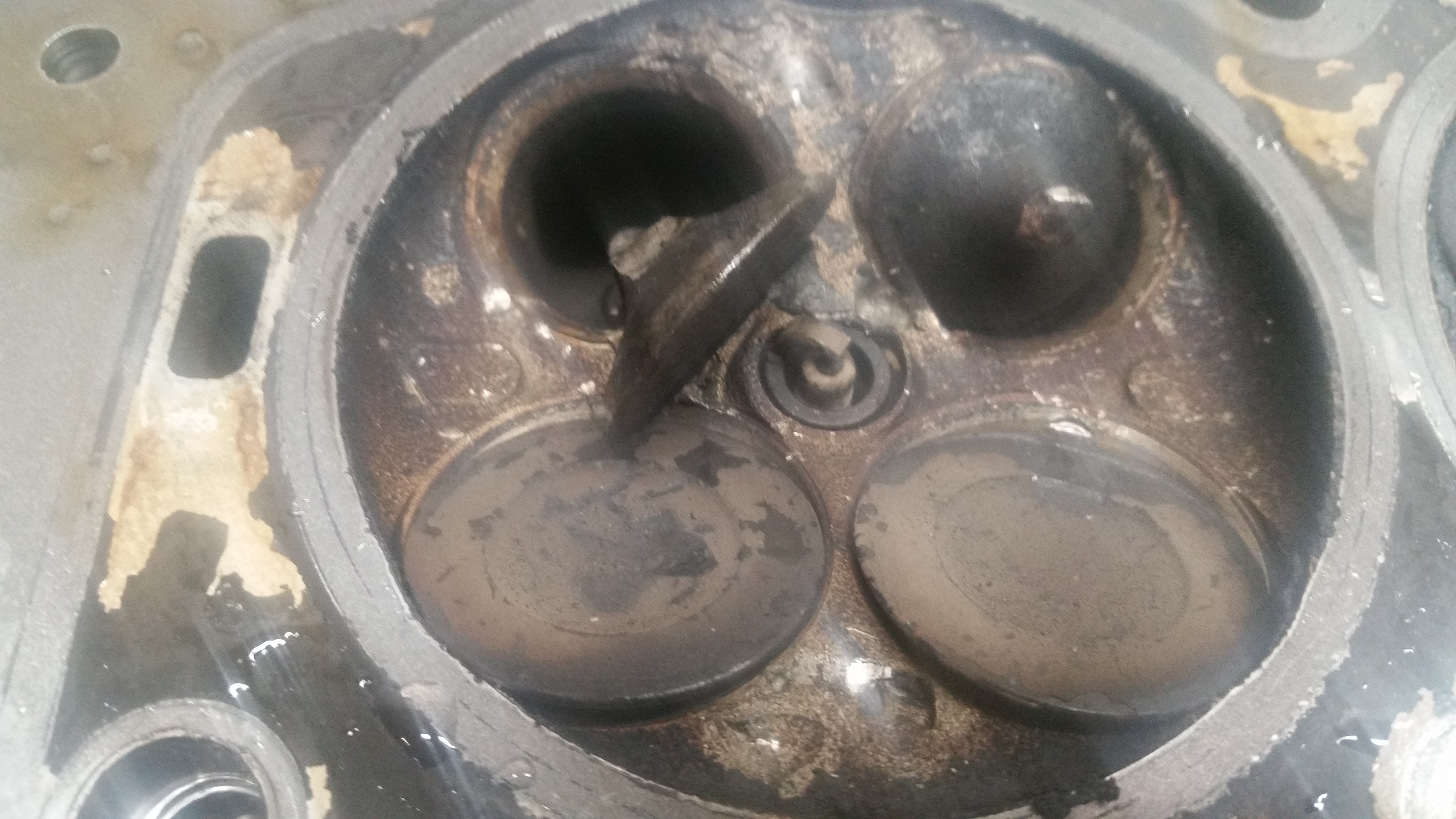

Pull the valve cover off on that side and take a look at the tensioner. 1234 are on right, passenger, side. You can tell if it's bad. Do not try to start the car again if you jump another tooth you lose the motor.

This is what can happen if you try to start it again. The guy I bought the car from had the same problem you do. He took it to a local shop that didn't know anything about Jaguar's. They keep cranking it to try to start it. Eventually it jumped another tooth and this is the result. It's an XK8 convertible that the guy just bought a couple of months earlier for $3700 and I bought it from him for $800. Let us know what you find out.
