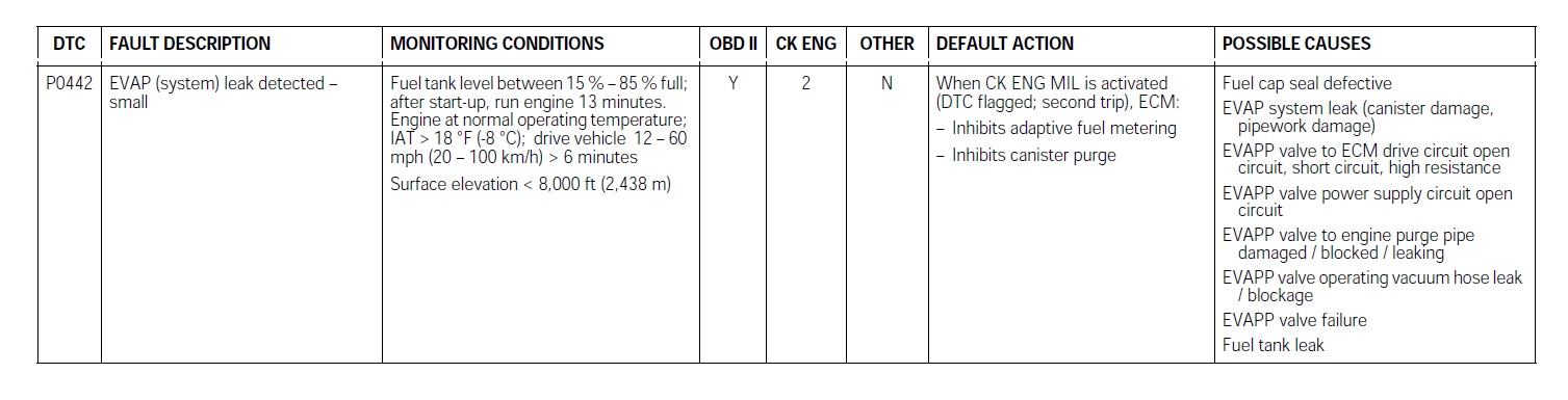

Any help in clearing the p0442 code thanks.
Old May 17, 2016 | 02:31 AM
I've moved your question from General Tech Help to X308 forum. This is the place to post technical questions about your model.
I assume by 'clearing the code' you mean rectifying the cause? Clearing codes is easy but they will return unless the underlying issue is resolved.
Here are the possible causes of code P0442 (EVAP system leak detected) from the Jaguar DTC lookup table:
