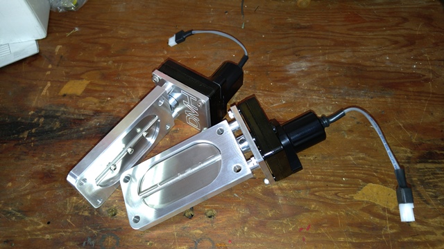

I put electric cut outs on my XJR 4 years ago, I am still very happy with them.
Open them a little or a lot, they can be OEM quiet or race car loud and anything in between.
More info and pics of the fabrication and install here:
http://s304.photobucket.com/user/its...?sort=6&page=3
https://www.jaguarforums.com/forum/x...ut-outs-71960/
Vector
Attached Thumbnails 2001 xjr exhaust upgrade-0621161023.jpg   2001 xjr exhaust upgrade-10-motors.jpg
