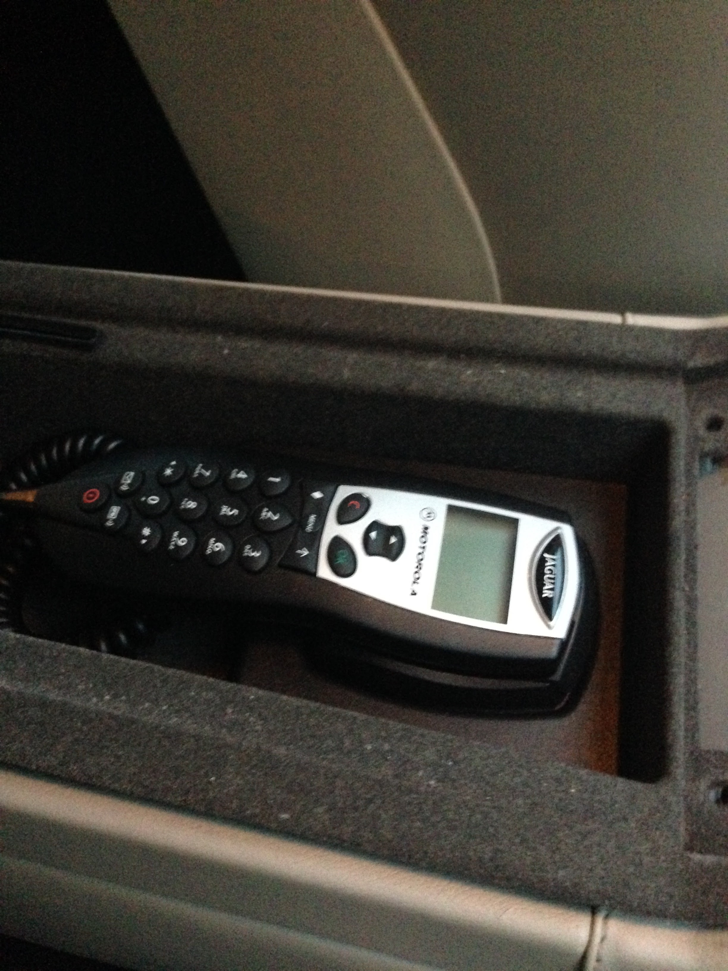

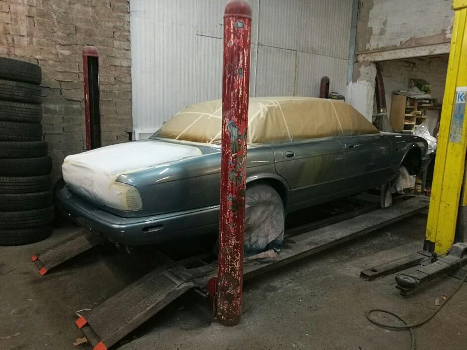

OK Whilst my car is in the body shop getting a makeover, I thought I'd do a quick post to show what I did to upgrade my sound system.

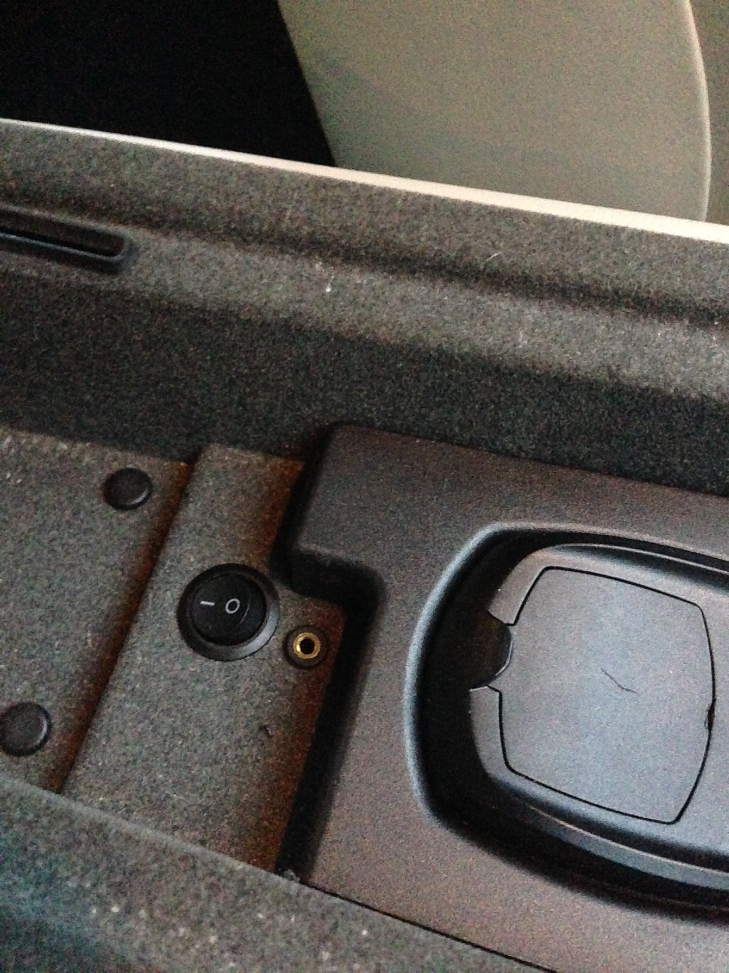

The car came to me with the Base ICE system, and I'd always wanted a premium sound system which is a rare option in the UK. Now I'm not one of these people who drives around with the music loud and the windows down, but I do appreciate a good sound system. The Saab 9-3 I had briefly had a factory upgraded system and it was very good!
So after much discussion with a friend of mine who knows his stuff about ICE I purchased a full set of Pioneer speakers which have specifications to work well with the factory amp. After removing the base ICE loom and fitting the premium loom, I was able to fit everything in place. The pioneer tweeters fitted into the holders in the A Pillars, and I secured them in place with my hot glue gun. The door speakers screwed straight into the factory holes, and I took the foam rings off the base speakers and glued them to the Pioneer units to provide me with a factory finish. I did however change the speaker connectors to the Pioneer spades to make it easier. The sub is also Pioneer, but not dual voice coil. It does work well and it's specifications are more than enough to work with the factory amp. I used a MDF spacer ring trimmed to the same dimensions as the sub to mount it with, a good solid mount.

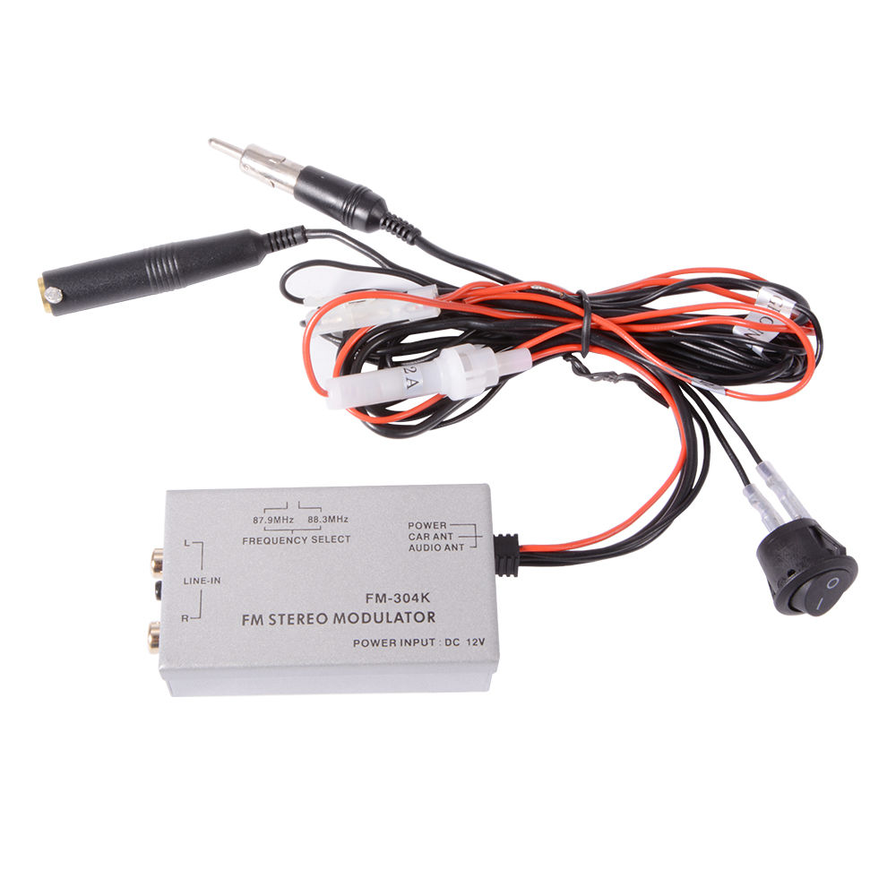

So far I'd achieved a nice factory look without having to butcher anything, but I did want to have a auxiliary connection facility. I was well aware of the CD changer hack, but I wasn't really in the mood for all of that messing around. After again speaking with my friend about it, he told me about the FM Modulator he has fitted in his car. It's a very neat little thing and installation is with the minimal amount of fuss. I bought one off eBay for £16 and installed it under the cubby box. To provide it with power I've taken the feed from the 12V socket at the rear of the console, and I've installed the jack socket and power switch inside the cubby box. I actually put them underneath the factory phone to give a nice clean factory look. The system works well and is, for me at least, a much easier option than messing about with hacking the CD changer.
So the end result is I now a nice crisp sound system, the injection moulded speakers are a noticeable upgrade by themselves without the amp. I can now plug in my iPod, iPhone or any other device to provide me with music or superior sound if I'm watching anything on my phone whilst parked up.

Well I got the car back from the body shop last Thursday and I am very pleased with the results. The car looks amazing now all the paint has been rectified and it's been polished. I drove the car home but didn't get a chance to start fitting body parts back on until Sunday because of the Weather and a prior commitment on the Saturday.

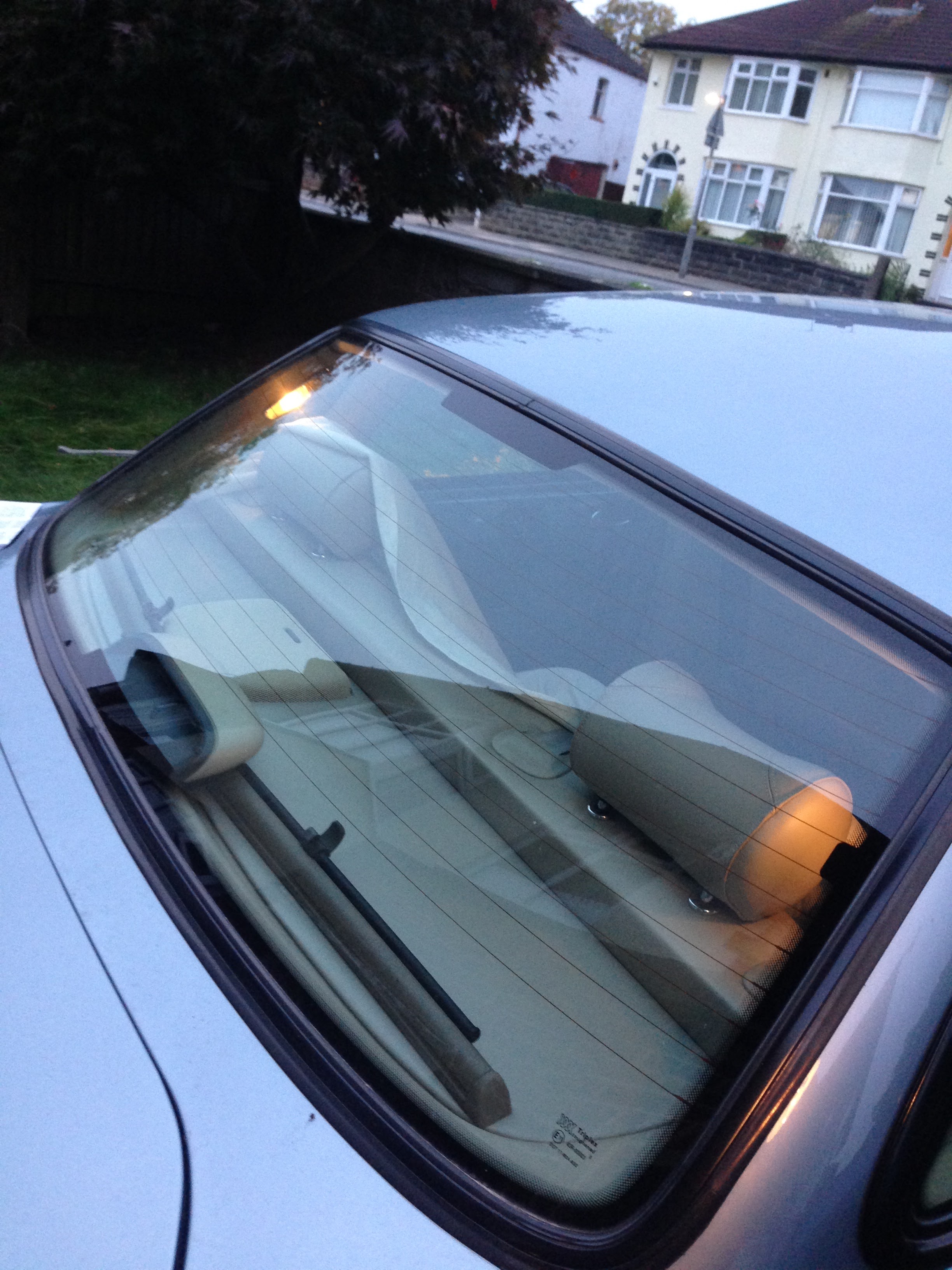

I then decided for some reason to dismantle my aerial unit, which I'm glad I did. The aerial itself was very dirty and there was a lack of grease inside the unit. I gave the aerial a good going over with the Brasso to get clean then a liberal soaking with WD40. The mechanism inside the unit got a clean and fresh grease, resulting in a smooth and quiet action on the aerial.

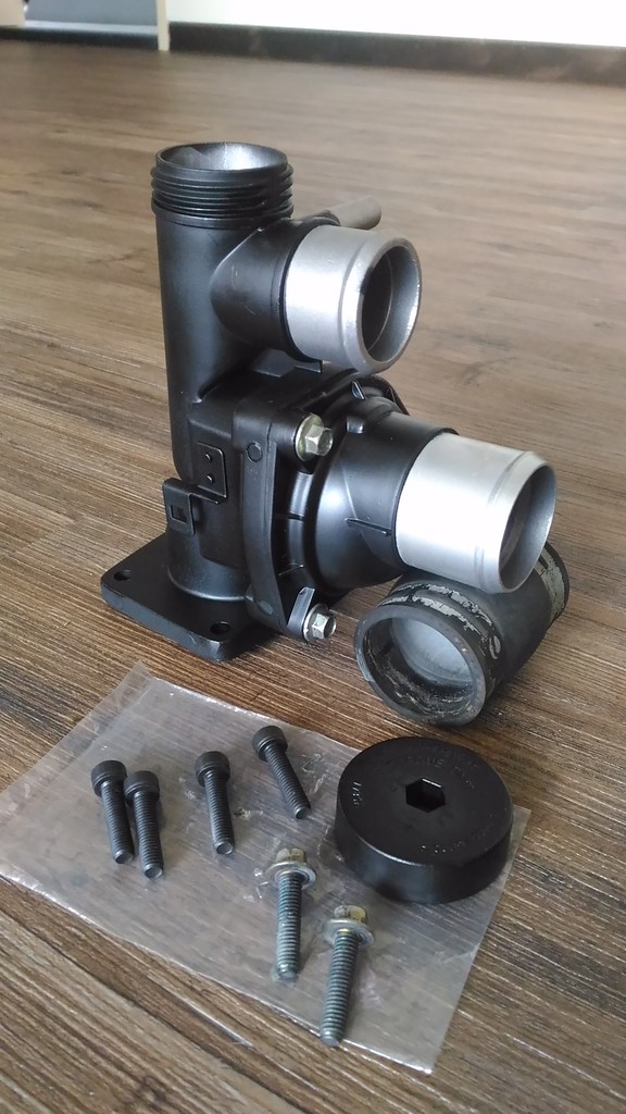

may as well if I'm fitting the alloy cooling tower.
I forgot what I told you, but I am glad things work.
If you paint the thermostat tower black (I used some heat resistant spray paint in a can), it stands out much less in the engine bay.

Already painted in anticipation, I gave it a few coats of primer and 3 coats of black. I baked it on using the oven, then had to act dumb later on when my girlfriend was questioning why the dinner tasted funny. LOL.
You advised me to back flush the system in another thread, I'll still do that though. I'm going to fit a new water pump whilst I'm in the area, may as well.

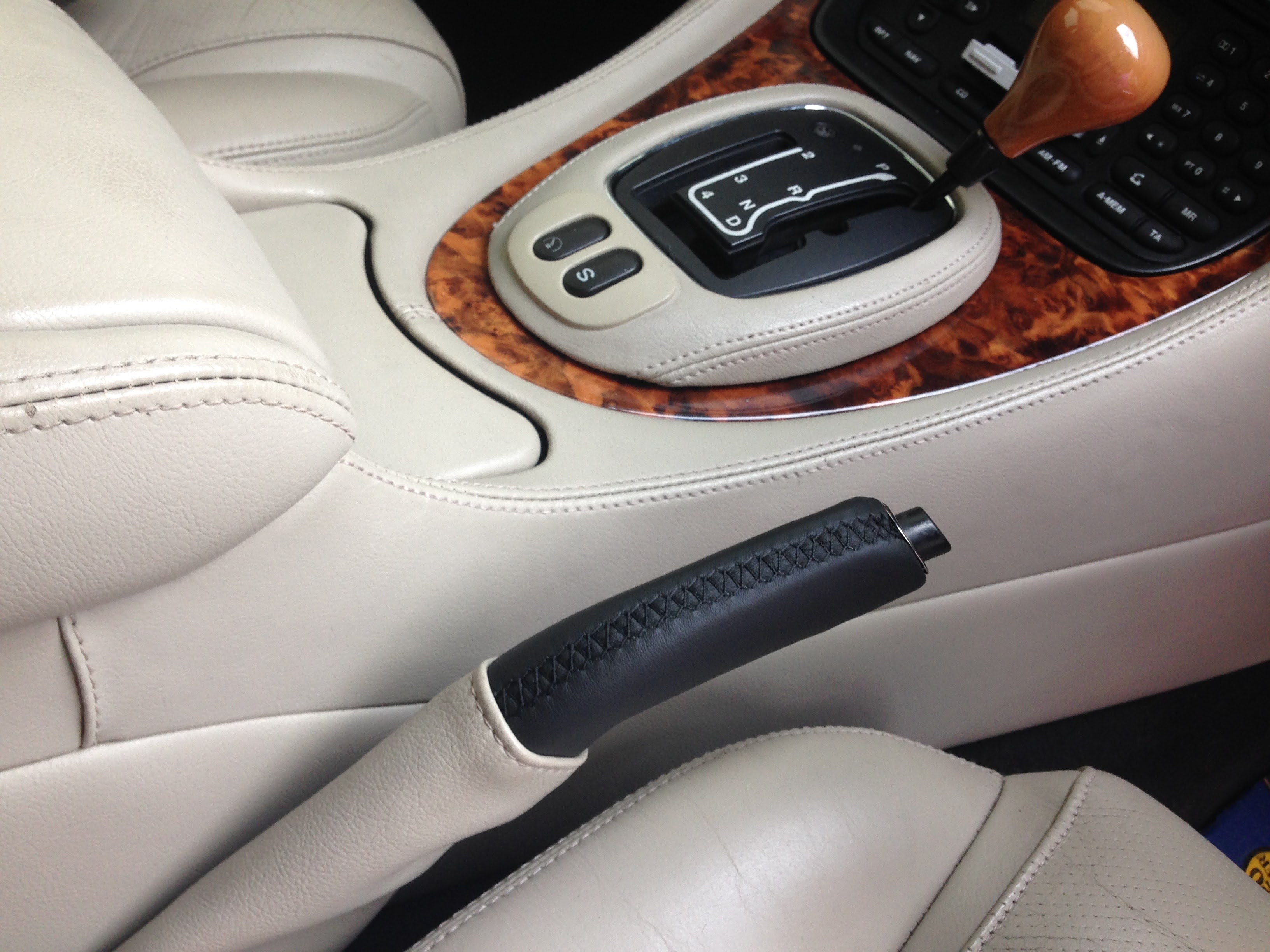

First thing to arrive was my refurbished steering wheel and handbrake handle. The wheel that came on the car was the grey stained type to match the grey stain dash. I've replaced that with the burr walnut set out of my first and second X308. The wheel from this car was sent off to be recovered with fresh nappa leather, the sport wheels should be perforated but I don't like that so I chose smooth. I also sent the handbrake handle off to be done at the same time, and when they came back I was pleased with the results. In the photos it looks like the airbag doesn't match the leather, but I've since steam cleaned it and scrubbed it with gliptone to get it back to it's satin finish and now they match well.
Wednesday I got a call from my local Jag dealer to say the parts I'd ordered via the Jaguar Classic Parts website had arrived. I went to get them on Thursday, I'm very pleased with them. Some bits can't go on just yet as I'm not up to that point but I've fitted my new badges to the rear. They look so good, really freshens up the back end especially with the new numberplate. Just need to get a nice set of exhaust tips and I'm winning.
My alloys are going in to be refurbished in March, so I've bought a brand new set of wheel centres for the wheels. The only way to describe them is beautiful. These centres are 110% better than the cheap items Jaguar are fitting to new cars today, they look handmade and if taken care of properly will shine forever.
So, as I'm writing this I've taken a quick look at my to-do list and there isn't much left now. The car is in a position where she can be taken for an MOT test, and there is no reason why she shouldn't pass. I'll be doing this in March when the weather is better, then I'll be giving the engine a full service and sending her in for her Transmission fluid and updated valve fitting.

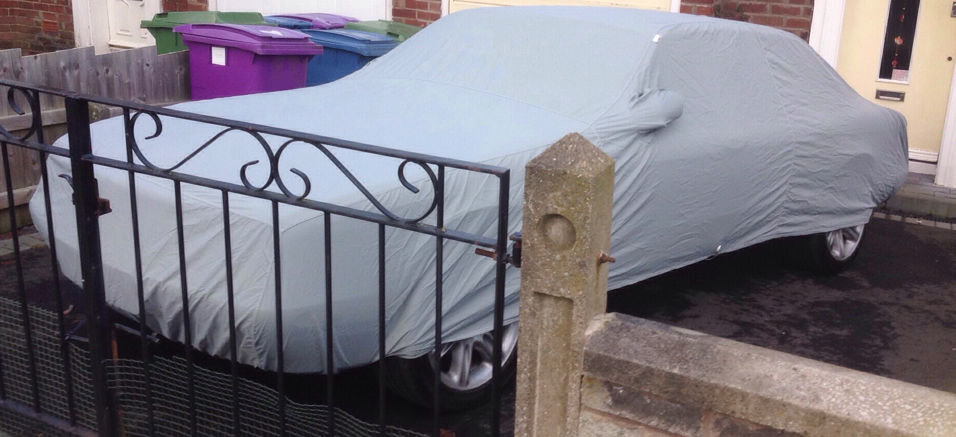

Whilst she waits, she's staying out of the bad weather underneath her new custom fit car cover. This was sent to me by a U.S. Friend and former X308 owner and JF member. It's a covercraft weathershield item, and water just beads off it. It fits like a glove and keeps the car safe from weather, dirt and prying eyes.
