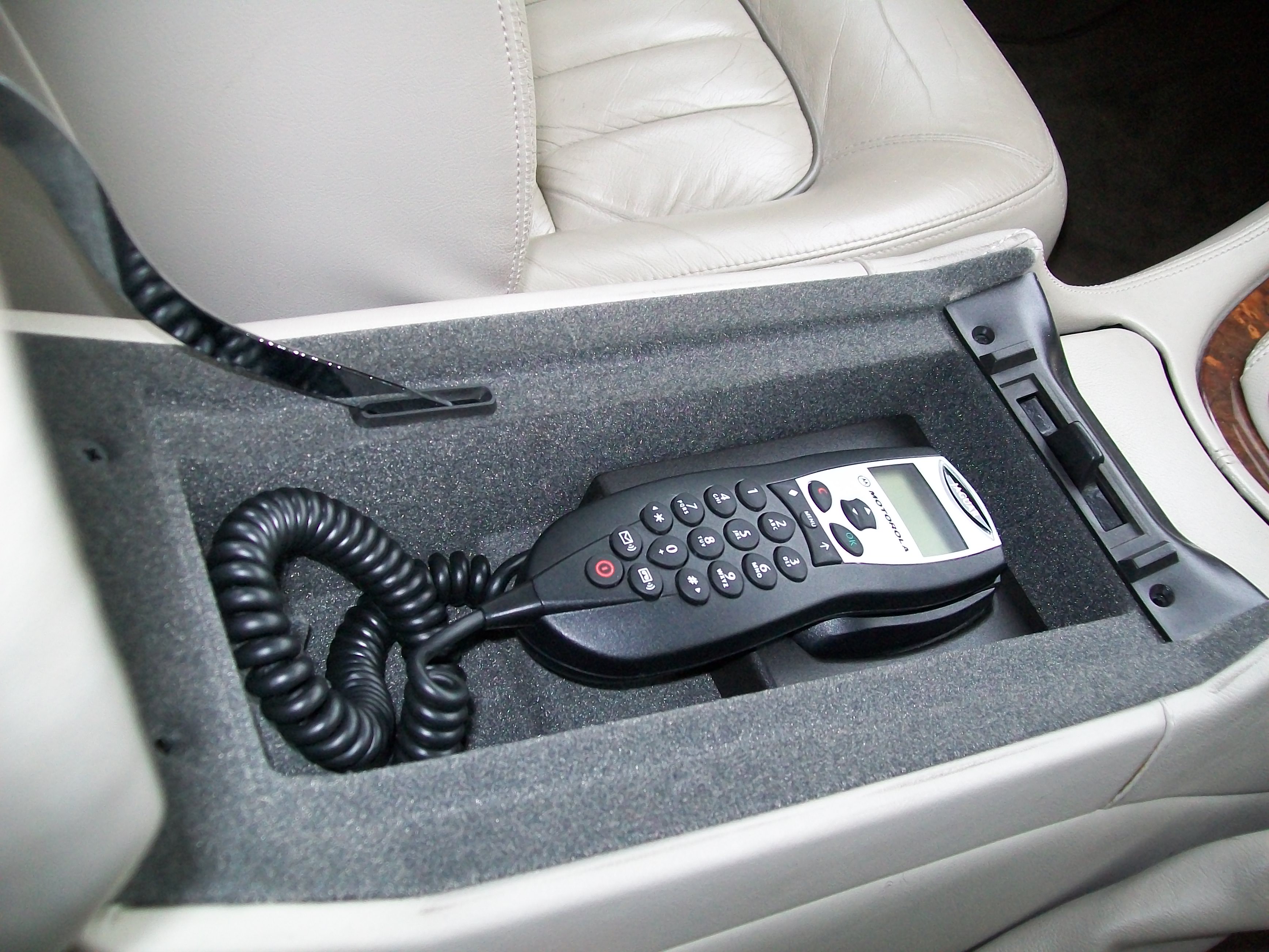

One other thing... I got my carphone reinstalled just for grins and giggles too. People give you the weirdest looks from that. : )

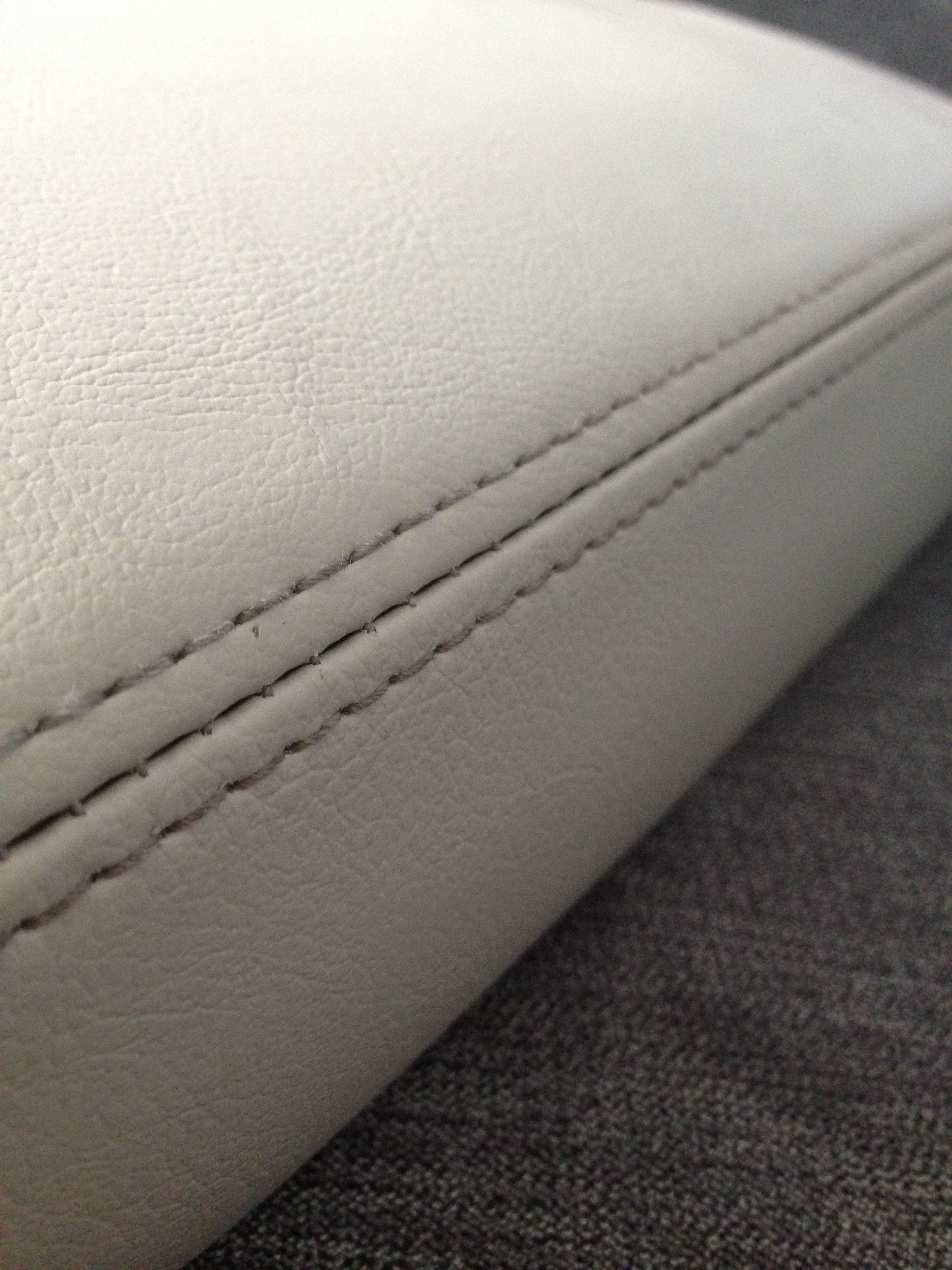

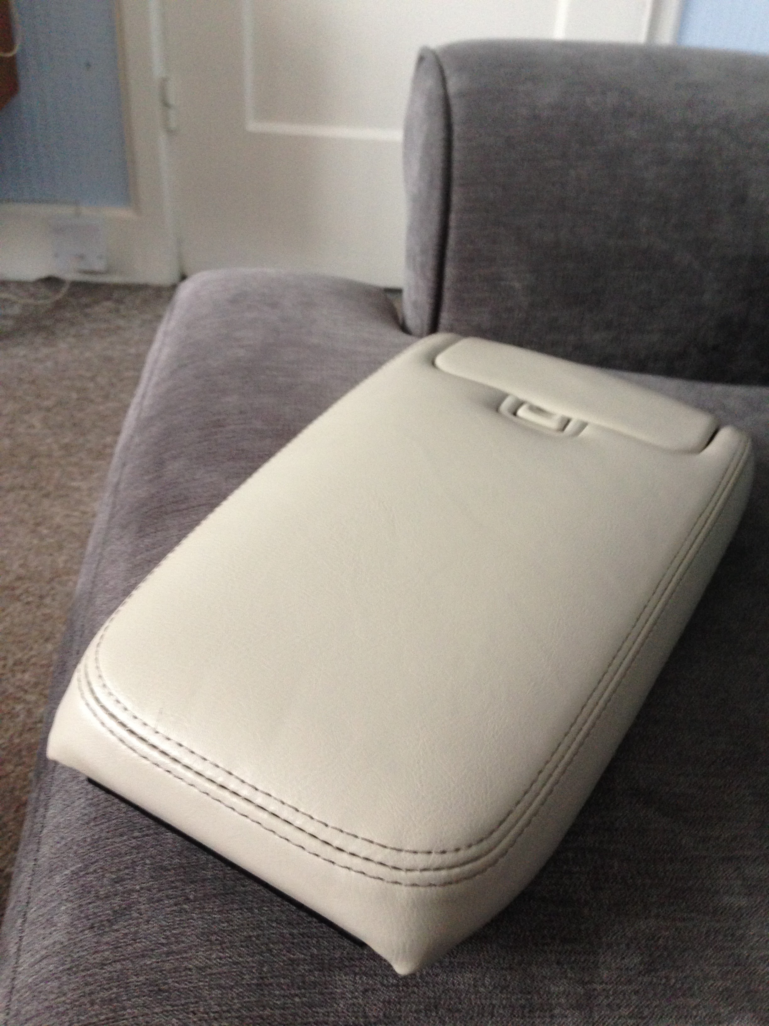

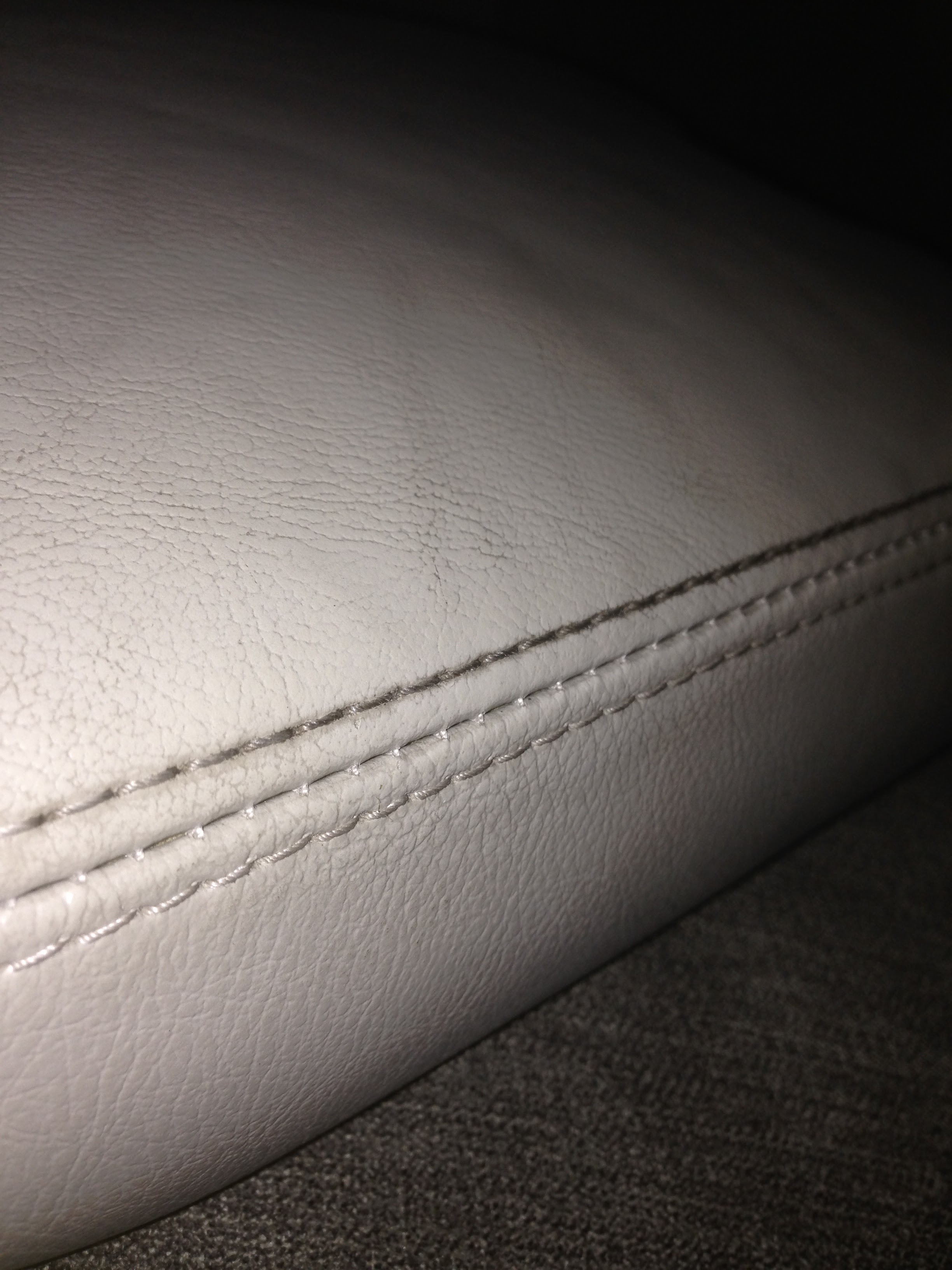

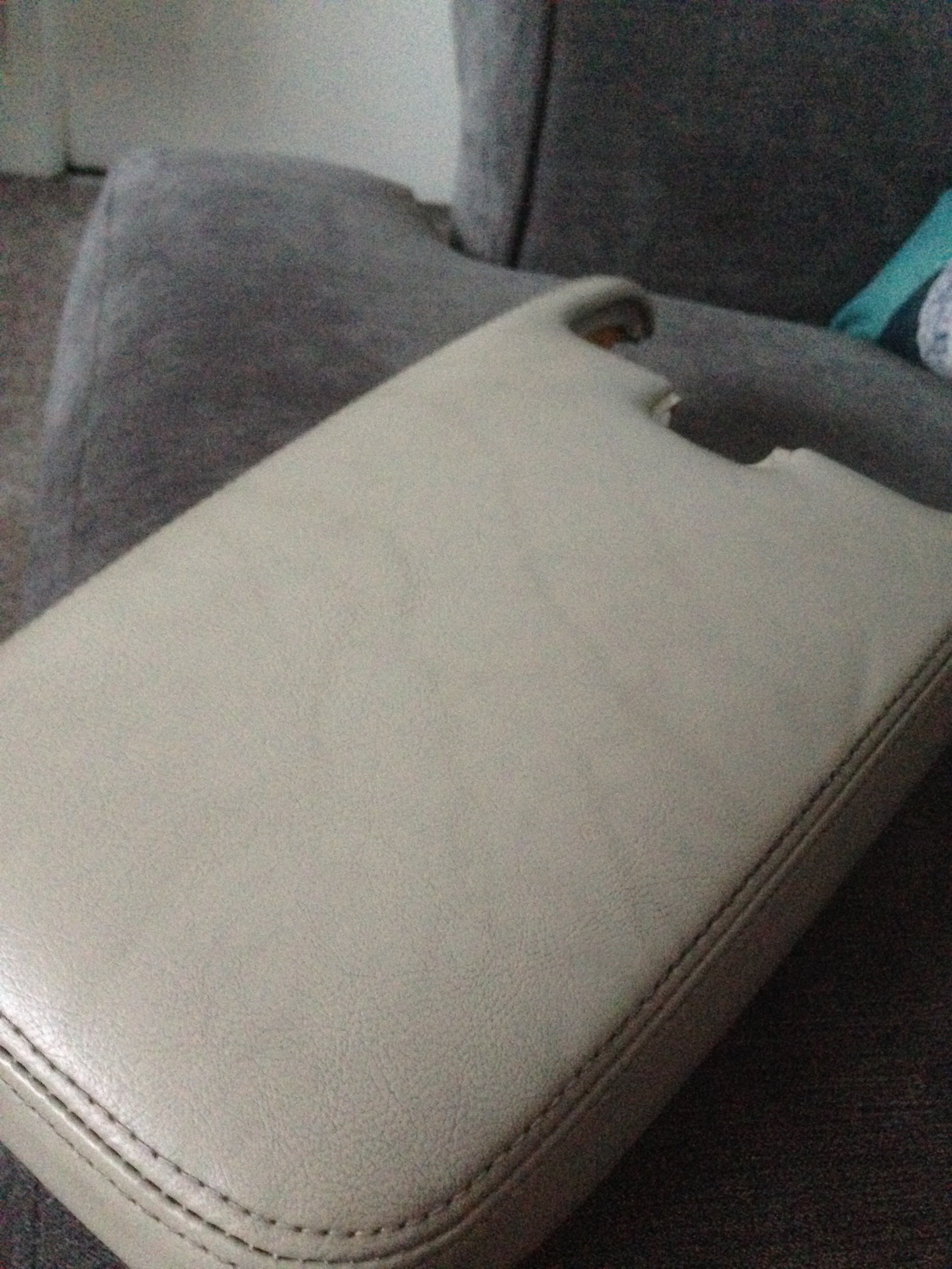

The car is just shy of 132,000 miles, I will do a secondary fluid change but it won't be within the same week. I've bought this car to keep nice and use for longer journeys, I have a little Ford Fiesta for my short journeys and "dirty work". This Jag will be properly pampered, one of the things I am going to get for it once I've finished is a high quality outdoor car cover.

Addicted2Boost I've added a photo of the phone from my old car, I don't know if its the same as yours. I like it though, and it's a period accessory that works!

That phone is different from mine, but yours is probably nicer. Mine being a 98' has a more aged look than yours. However, it is still funny when I show it to people.

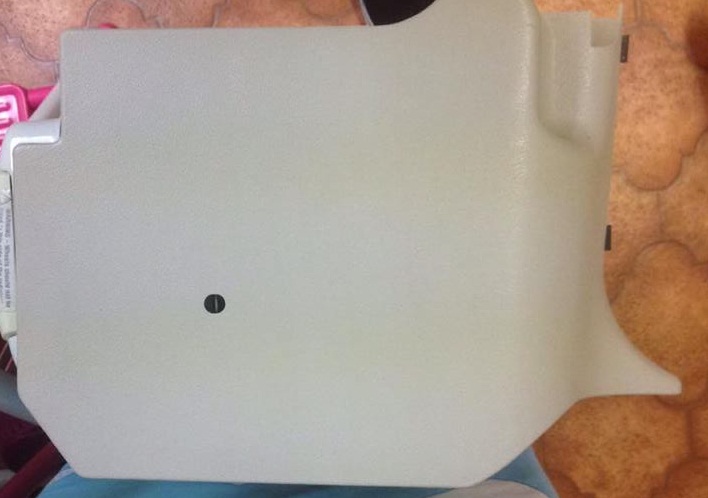

I wanted to upgrade the car to Premium Sound but needed to source the correct A Pillar Trims, Parcel Shelf, Amplifier, sub and the Premium ICE loom. After weeks of searching I've finally got everything I need in the correct trim colour too. I managed to lay my hands on the correct loom from a scrapper as well as the pillar trims and shelf. I removed the base loom and fed the premium loom along the correct factory route which wasn't hard, but dodging rain showers made it a long job. After popping the sub in place and temporarily placing the speakers in the car I preformed a test. I was pleased that it all worked straight away and it was an instant difference to the base system. I'll cover my speakers and such later on, I'm just pleased to finally have Premium sound which appears to be a rare option in the UK.

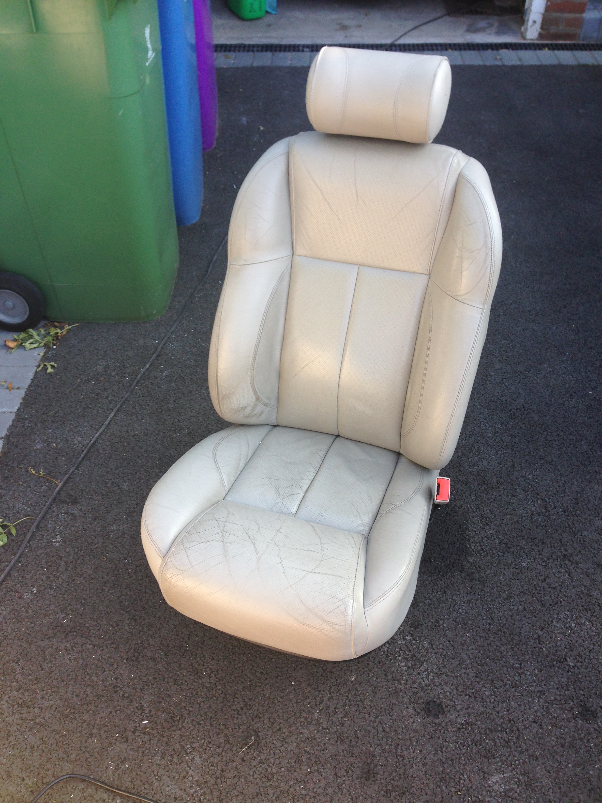

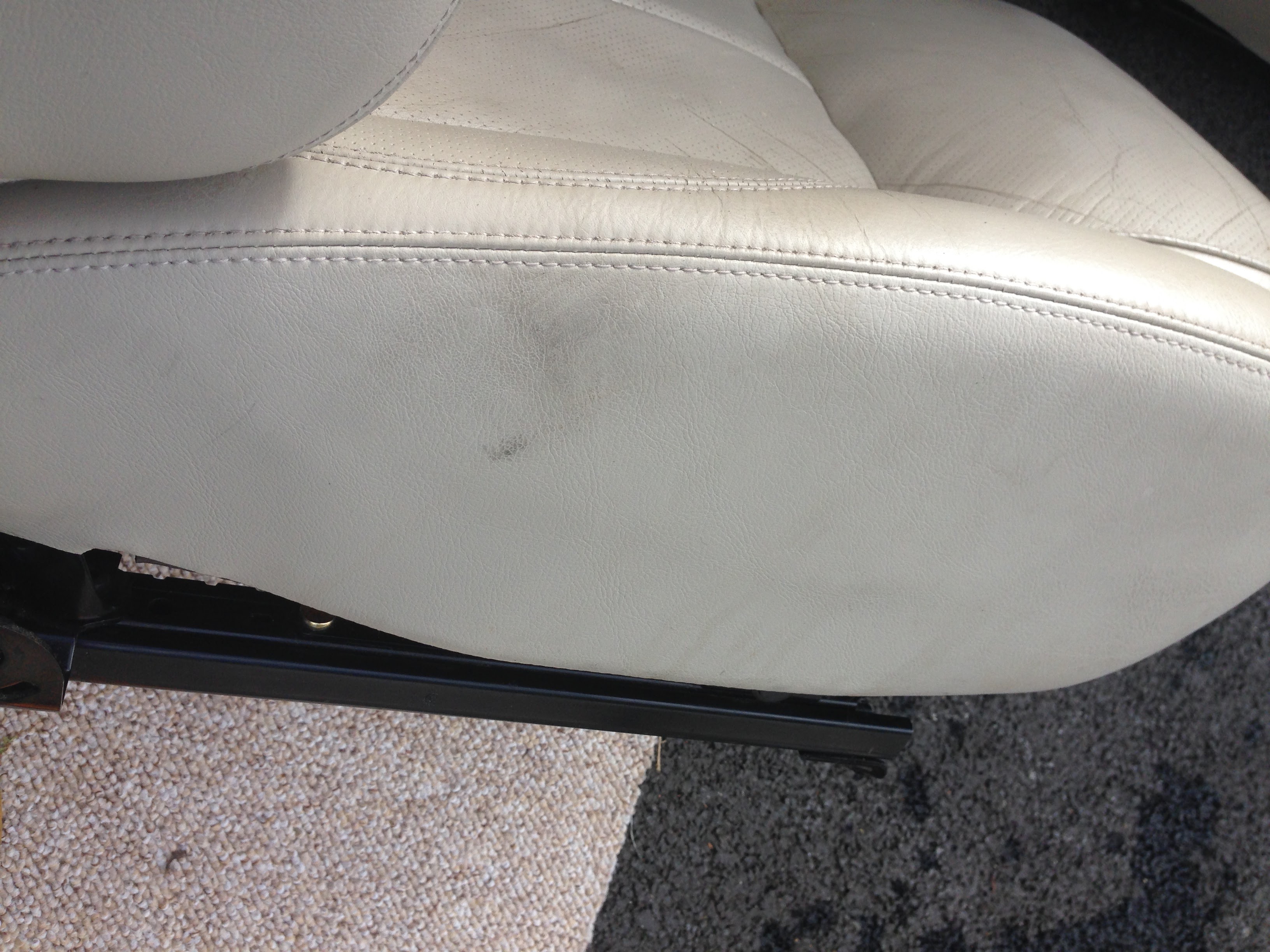

I managed to get some time to remove the front seats and give them a good cleaning up, the filth embedded in them was shocking. However I'm not 100% happy with my driver's seat so I've decided to look for a decent replacement. It would seem that one (or more) of the previous owners of my car was "quite a big individual" to put it politely and the seat has suffered. Not only is the bolster fairly worn, but also the cradle the seat controls sits in is shattered and the creases have cracked open in places. The passenger seat is much better though, so that can stay unless I find a decent pair. Ideally I'd like to find a sport trim passenger seat from a LHD car which theoretically will have less wear than a RHD driver's seat, but realistically I'm looking for a good condition one be it LH or RH drive. I've added some photos of the seats being cleaned up.
