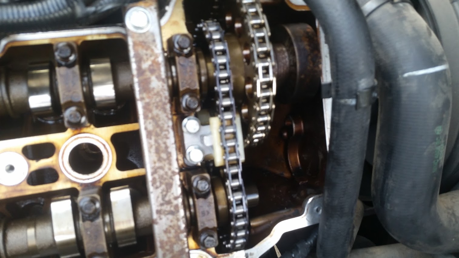

What is your option of the chain connector link ? I have seen them used in industry ..
I don't think the chain with connector is a good idea for long term use. In the attached pic you can see my new secondary chain to the left (with bicycle-like connector) and the much heavier primary chain to the right. There's no comparison and as soon as I can I'll be performing a complete refit of OEM chains, tensioners, thermostat and water pump.
But for today? The car is running perfectly. Genuinely fast, very comfortable and as soon as the engine was determined to be good I spent about three hours buffing out the paint. Best Sunday ever. Thanks again for the kind advice given. It's a thrill to bring a vehicle back from the dead and I could not have done it without this forum.
