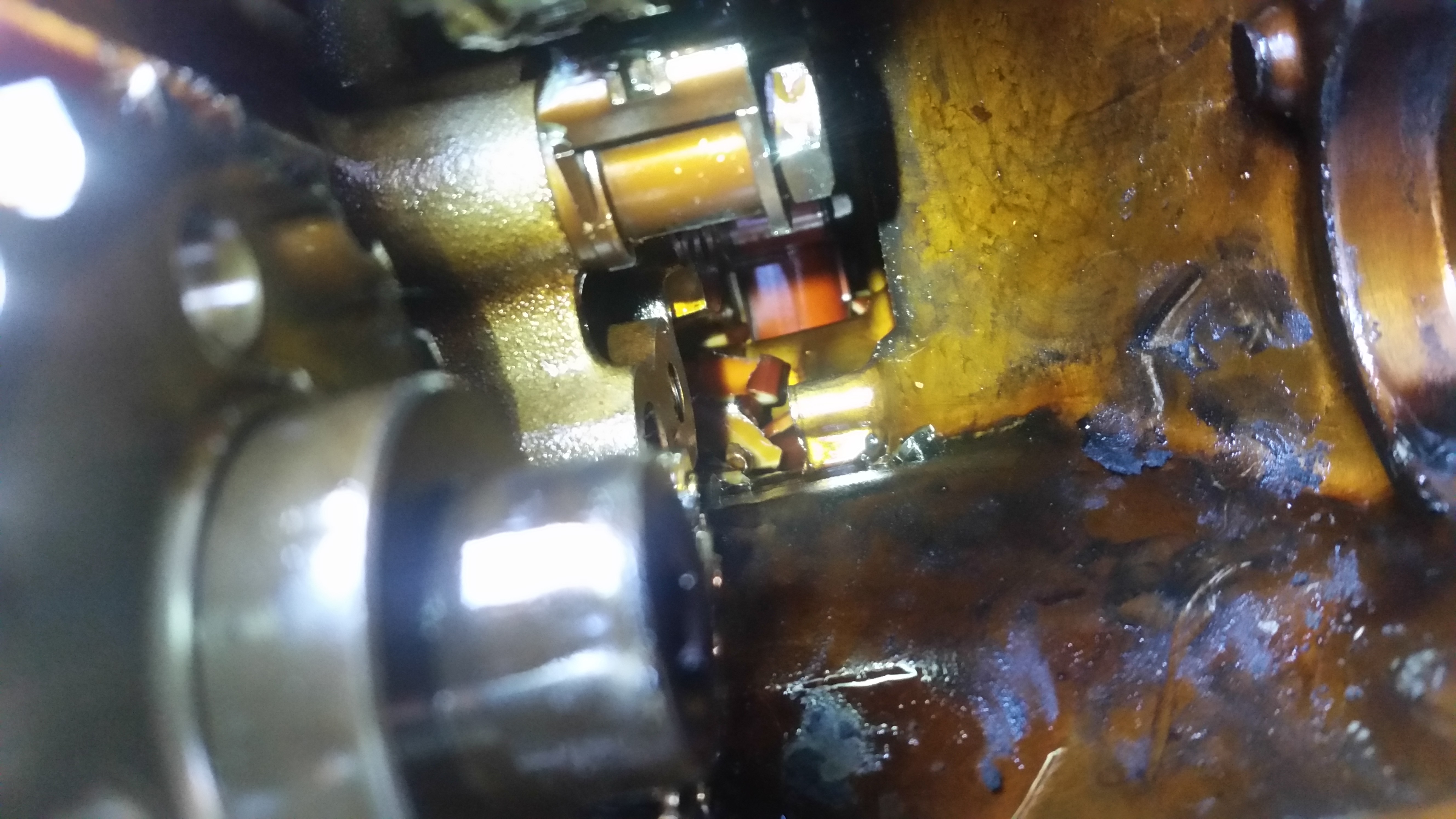

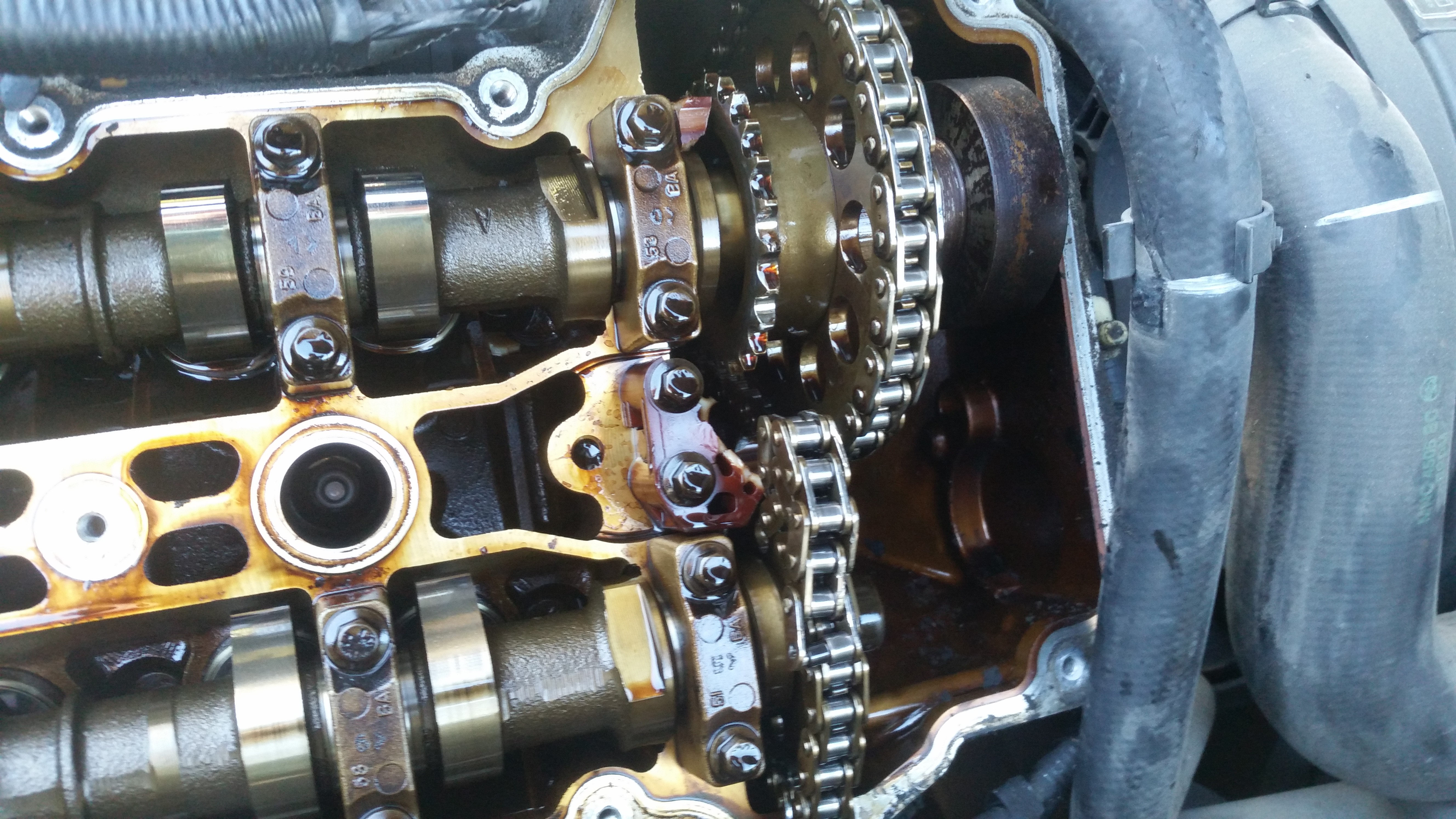

Default It's not the O2 sensor!
What a mess. I can't believe it even ran. Next steps?
Attached Thumbnails 2002 XJR consistent cylinder 1,2,3,4 misfire codes-20161019_100514.jpg   2002 XJR consistent cylinder 1,2,3,4 misfire codes-20161019_100528.jpg   2002 XJR consistent cylinder 1,2,3,4 misfire codes-20161019_100954.jpg
Old Oct 19, 2016 | 01:10 PM
RJ237's Avatar
Joined: Dec 2010
Posts: 8,836
Likes: 2,924
From: Douglasville Ga.
Take the head off. The pistons are probably damaged, but the head is almost certainly destroyed.

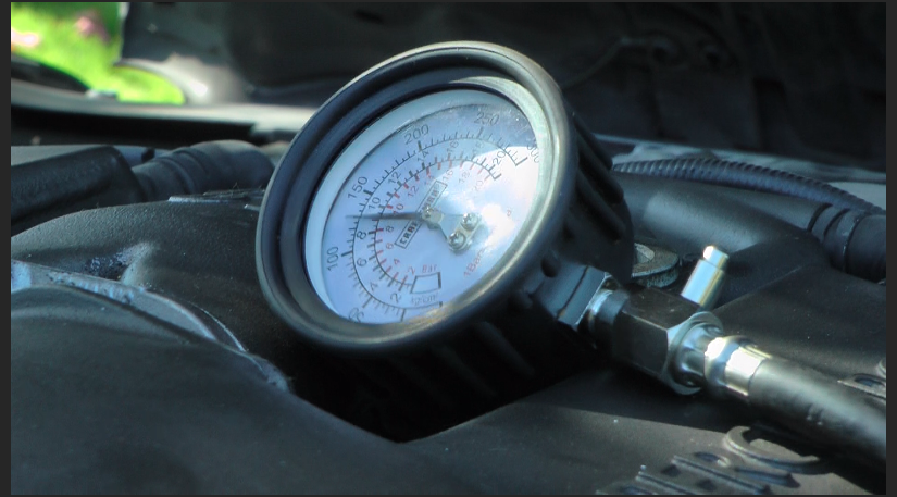

STOP!!!!!!!!!!!!!!!!!!! You are NOT the luckiest person if the vales are not bent. You are one of the about 50%.
Remove the exhaust cam and perform a compression test. I have a 1999 XJ8L that I bought for $500. One of the secondary chains broke and the owner did NOT want the car anymore.
I pulled the exhaust cam and performed a compression test. I got low readings but NOT ZERO.
I replaced ALL timing chains, guides, tensioners.
The engine is still running normally 5 years later.
The exhaust cam can stop in a safe place and NOT bend valves. This usually happens at a low RPM (idle).
When I worked at the dealer I found that the odds of bending valves when the secondary chain broke is about 50/50.
The intake cam does NOT stop rotating so you only have the exhaust cam stopped to worry about. It CAN stop in a HAPPY PLACE.

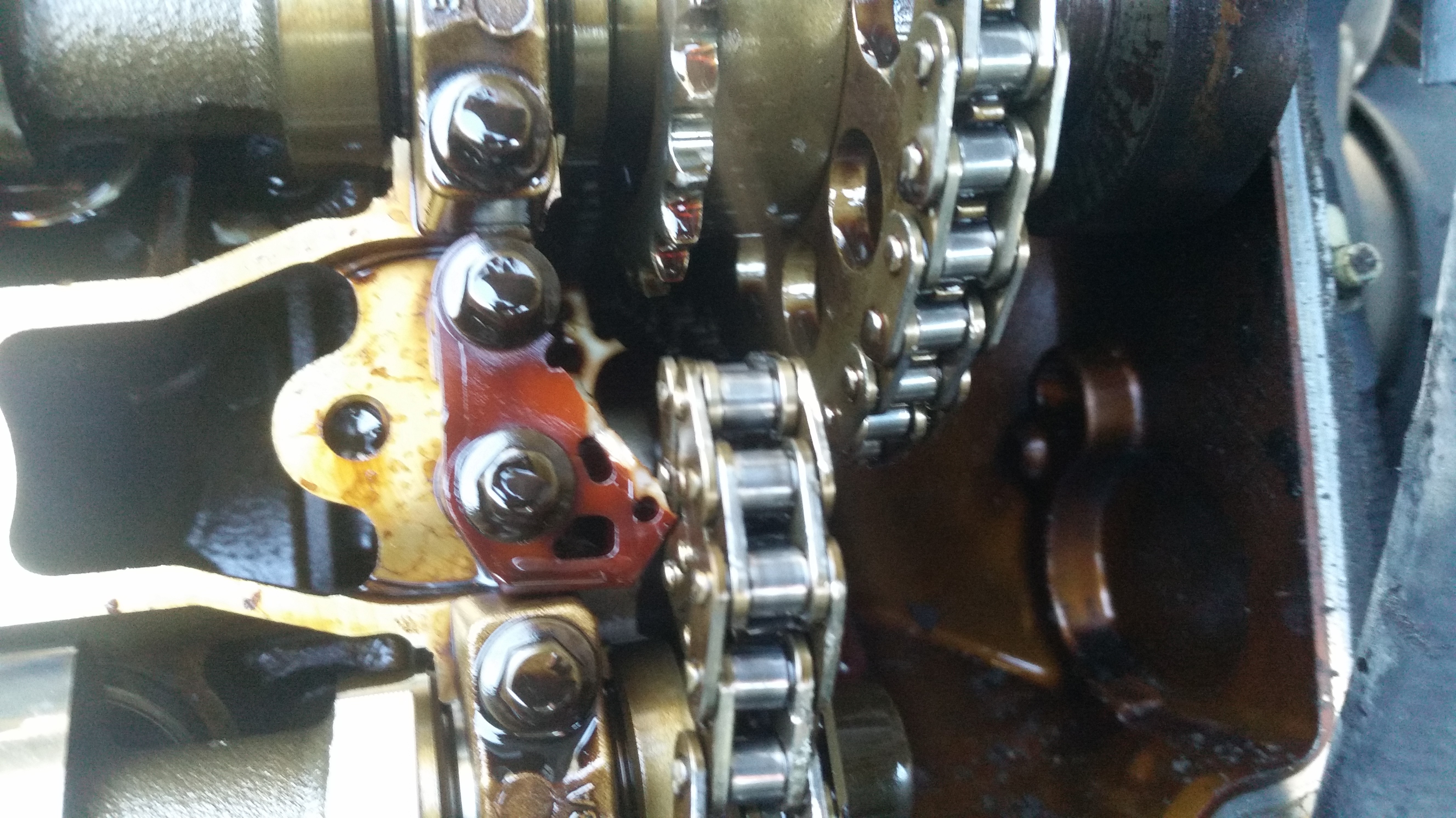

Sorry I haven't been on to respond, family stuff, all good now. I see the cam flat is almost sitting TDC, maybe there is a bit of "luck"?....fingers crossed Pricebill.

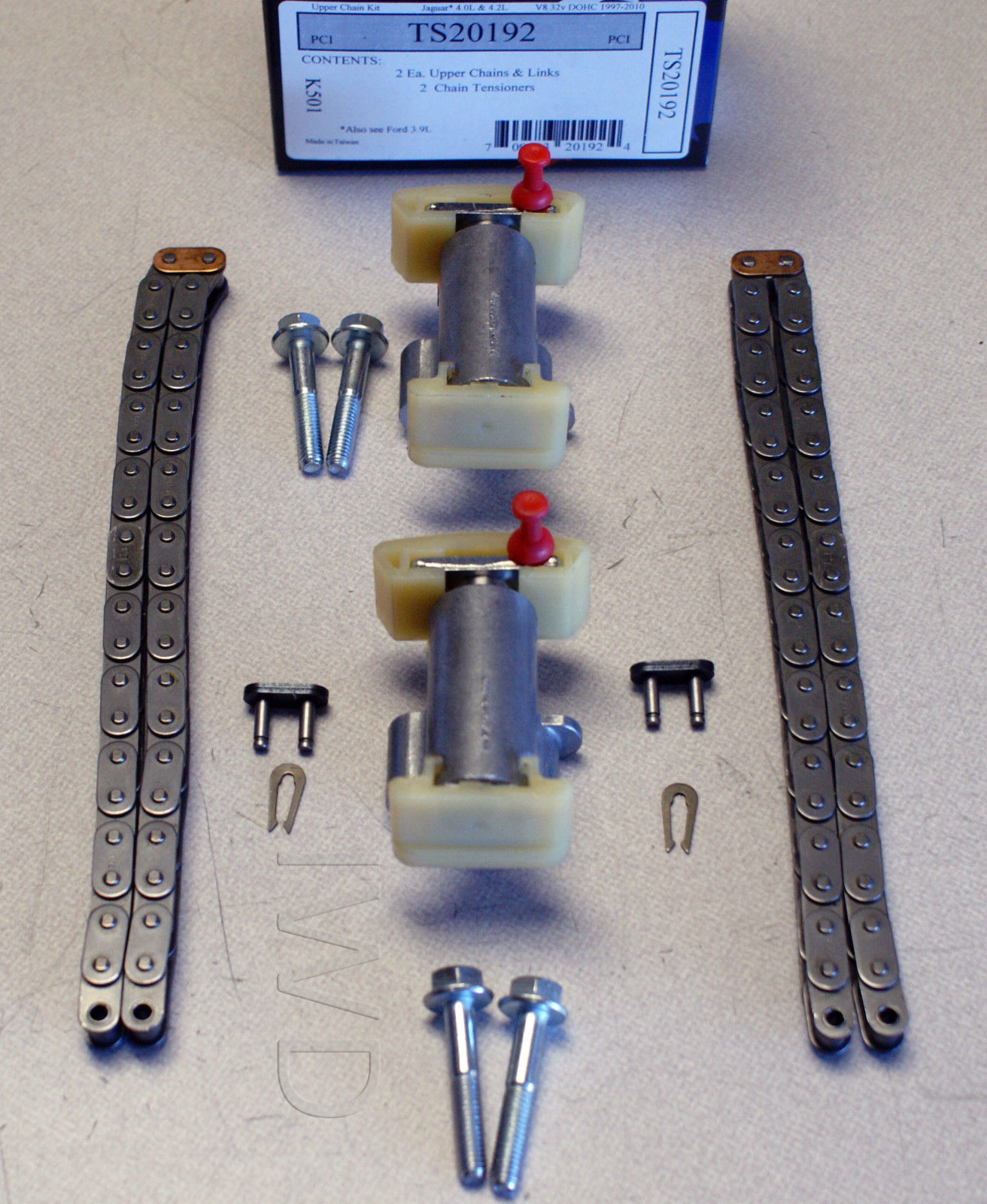

I pulled the exhaust cam and executed a dry compression test on all four cylinders. About 130 across all four. I felt so encouraged by these numbers I machined two pieces of 1" square metal bar to provide cam lock once I position the engine at TDC. Now all I need is a couple of metal tensioners and at least ONE replacement chain.
I purchased a kit via eBay and it arrives in the morning. Here's a link.
JAGUAR V8 2001-2009, UPPER SECONDARY "UPDATED" TIMING CHAIN TENSIONERS w/CHAINS | eBay
It goes together like a bicycle chain around the secondary gears. I can't imagine anything more ridiculous to keep this engine running forever but certainly good enough to determine if I'm the owner of a grenade.
Here is my plan; please assassinate at will.
- Hand rotate engine to TDC. Bolt on (homemade) cam locking tool on left bank.
- Bolt on (homemade) cam locking tool on right bank with care.
- Install new tensioner on right. Leave pin in.
- Do everything above but now on the left. Pull pins to have the tensioners take up the slack on secondary timing chains.
- Hand rotate engine to see if I have done everything really wrong and stupid.
Did I?
