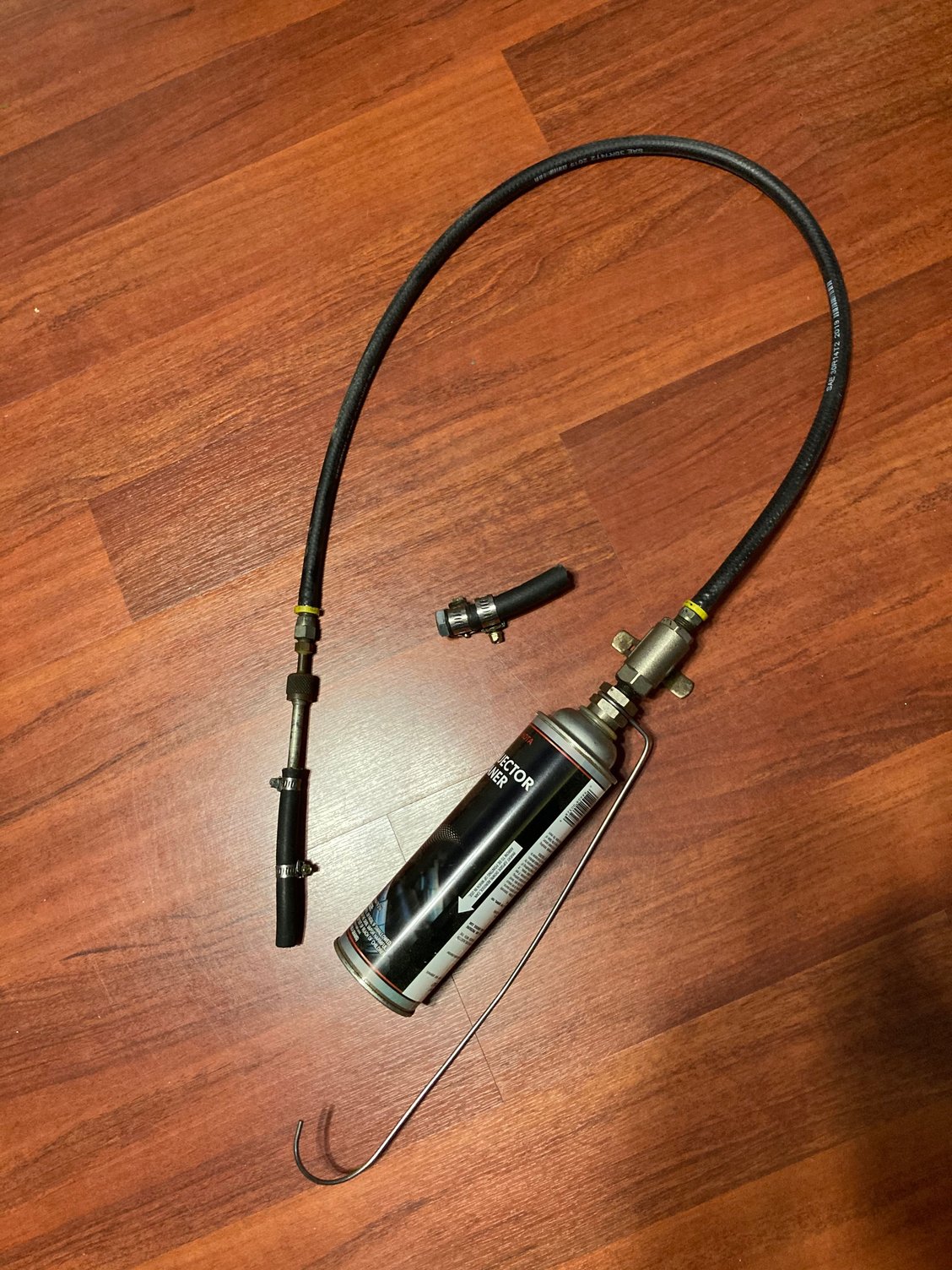

Without having to look in your old threads related to this issue...
Have you tried running a can (or 2) of pressurized fuel injector cleaner? Just an FYI, don’t get the pressurized efi cans from Napa! Get them from the Toyota dealer.

Never heard of that. But I'll look into it! Old thread was about running rich at odd times. Which the MAF connector fixed.
