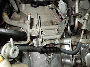

... I came across this one while looking for an FPR for my '02 XJR-100, figuring that I would replace it while I had the SC off. I too ordered the NCA 3007 CA from Gaudin a couple of years ago. I took it to my local Jag dealer since I was having them do some work that I didn't want to do, and they didn't know what to do with it. They tried to remove the hard rubber hose from the old FPR, gave up, and told me that it was working fine. My original is stamped Denso 2901 96JV-9C968-EA which appears to be the same number as the NCA 3007 CA; but mine has a hard rubber hose that runs all the way under the intake elbow then connects to the return line behind the bank 2 head. So, I'm wondering how this one worked out for zubizar. I have attached a pic with the FPR still in place. (I tried to get a pic of the Denso part number but my camera wouldn't focus properly.)
Mark
2002 XJR-100

Hispeed42: I have the same hose/regulator in a 2000 XKR. I ordered NCA3007CA, the regulator looks to be the same but the hose does not fit! The hose is substantially different. AJ81480 is the original hose and regulator part # that is on our vehicles. The problem is it seems to be discontinued with no new part revision and it doesn't look like we can buy the fuel pressure regulator without the incorrect hose attached (NCA3007CA). At this point it looks like I'm going to have to fabricate the hose or order a used part.
Attached are photos of a brand new AJ81480 (now discontinued) part, so you can see what I mean.
