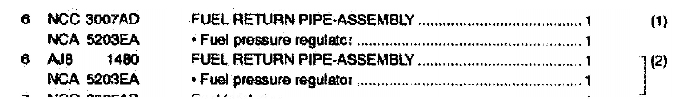

The parts catalogue shows:
where the top pair is up to VIN 835511 and the bottom pair for VIN from 835512 onward. It appears that, for VIN up to 83551, the pipe NCC3007AD (short) and the FPR NCA5203EA were initially available separately but later "merged" into one assembly under NCC3007AD (NCC3007AD plus NCA5203E). This appears to be the reason why, if you try to order NCA5203EA, you are directed to NCC3007AD which now represents the whole assembly.
For VIN from 835512 on, the parts catalogue shows that the pipe and FPR are sold as a set (the square bracket at the right in the catalogue) under AJ81480 and shows that this set has an FPR NCA5203EA, i.e. the same FPR as on cars with VIN up to 835511. The problem is that, if when ordering the FPR for your VIN 835512 and later, you use p/n NCA5203EA shown in the catalogue, you are directed to the whole assembly in supersession for the earlier VIN-s (up to 835511) and not told that, in the case of VIN from 835512 and later, you should go for the set AJ8148 (FPR plus a long pipe).
AJ8148 appears to be available from Barratt at GBP 97.24.
The insertion into the text did not work. The Parts Catalogue shows:
