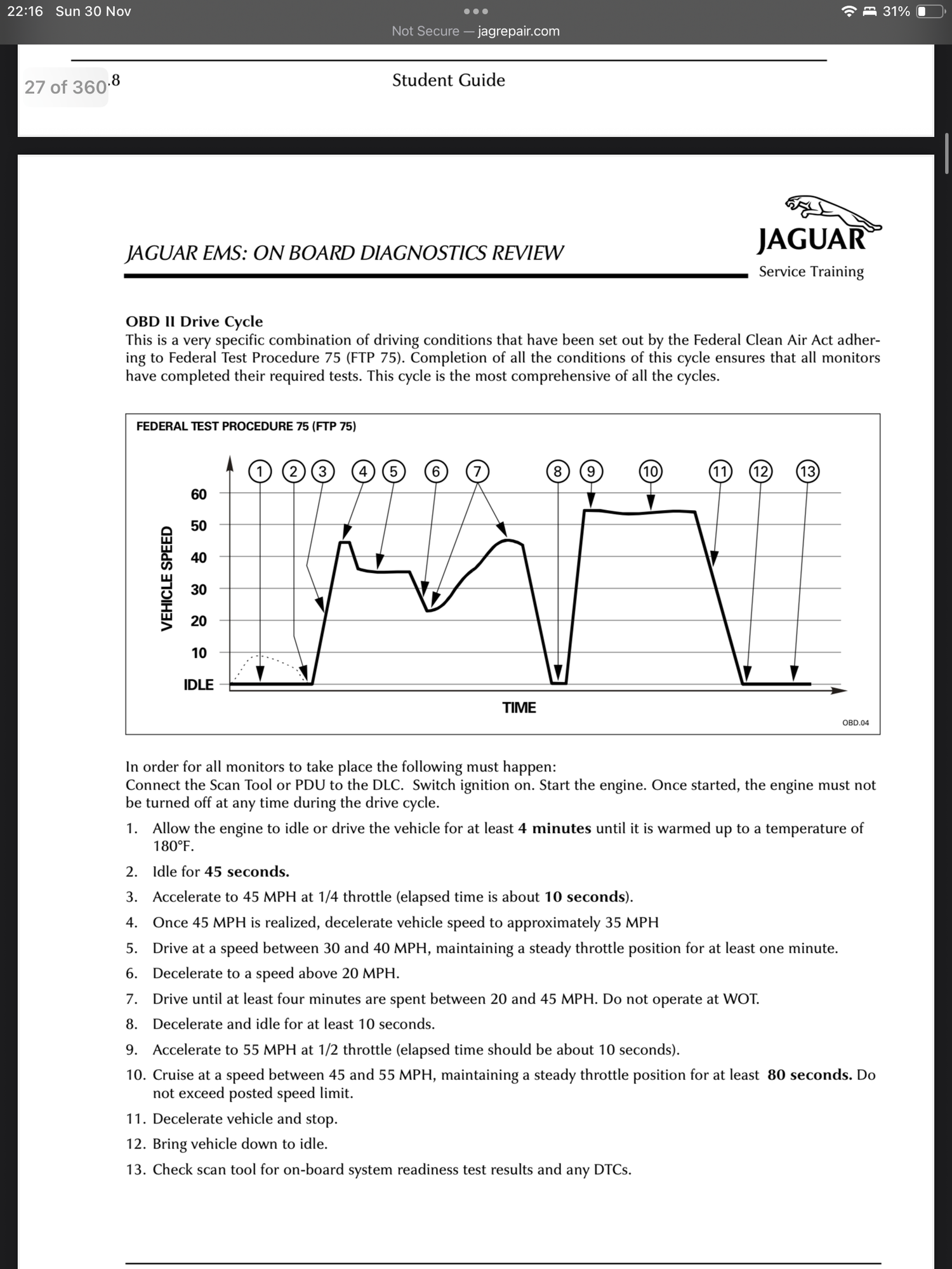

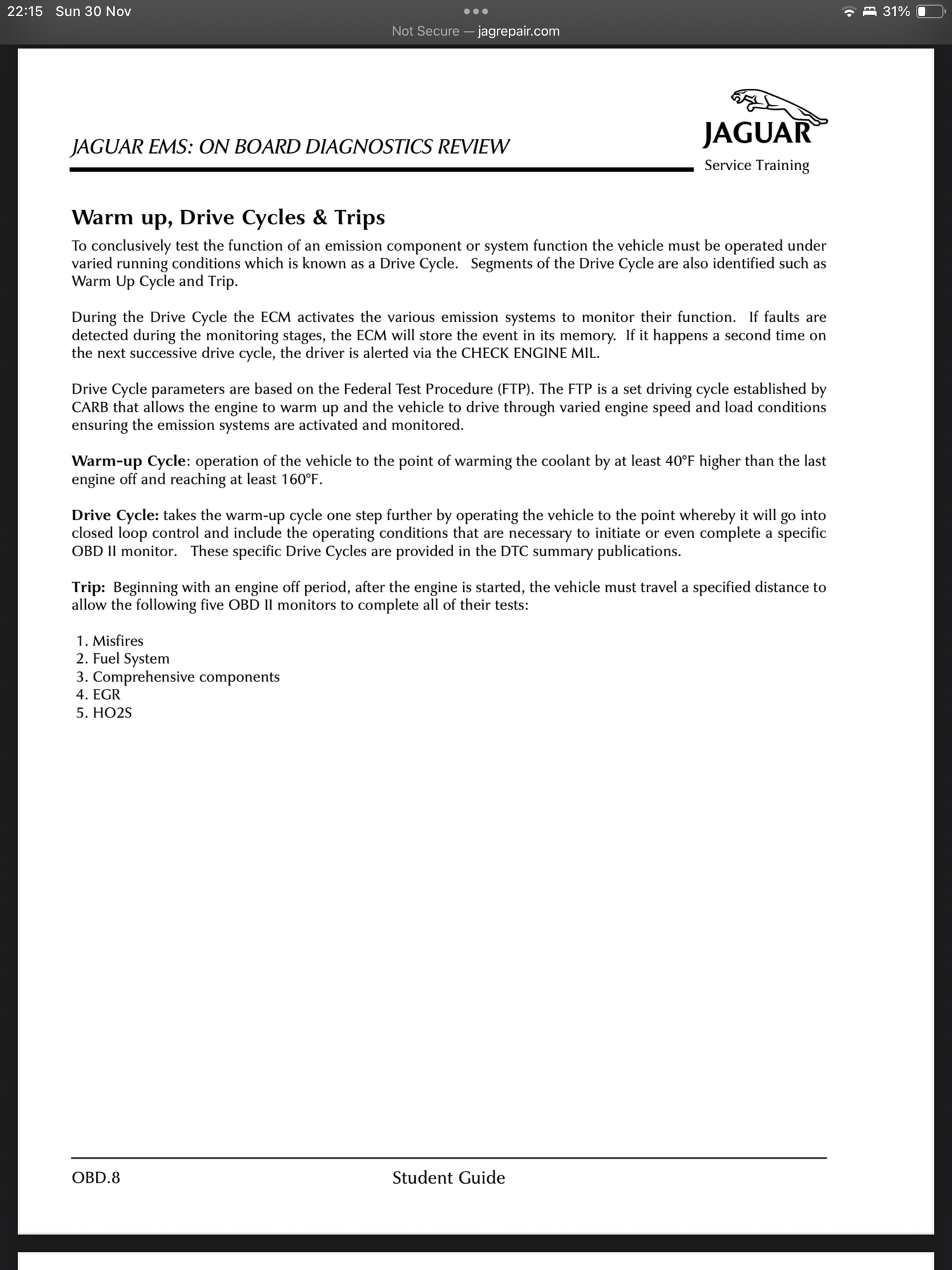

Looking at the student guide http://www.jagrepair.com/images/Trai...20-%202000.pdf
It lists a very torturous order of things which are probably likely to happen on a city commute not on the highway!

Thanks for the fast reply, although I've found that exact list before and on three separate occasions completed the check list to a tee. I'm wondering if I potentially have an ecu problem.
