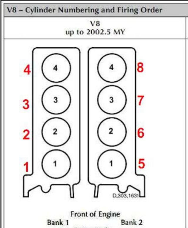

Old Apr 9, 2024 | 03:42 PM
Hotdogger52's Avatar
Joined: May 2023
Posts: 10
From: Irvine, California
I'm confused by this diagram. This indicates it is up to 2002.5 model year and shows two banks which are numbered the same (1,2,3,4). I have a 2003 model year (4.0 L) and all diagrams I've seen show cylinders marked as being numbers 2,4,6,8 on the driver's side starting from the engine front (on a US car), with 1,3,5,7 on the other bank. A diagram I reference, shows a heading for "Cylinder Numbering Diagnostic Reference- V8" (used by engine management software for DTCs and datalogger) and it shows this as being for the current AJ-V8 to ISO standard. Just below that is another listing: "Alternate V8 Cylinder Numbering" (for some S-types and XK AJ-V8 before 2003 MY as well as V8 XJ before 2004 MY. Well...mine is a 2003. Do you see my confusion?

Old Apr 9, 2024 | 04:55 PM
Jhartz's Avatar
Joined: Apr 2013
Posts: 3,800
Likes: 1,074
From: Virginia beach va
Although you have a US 2003 model for licensing, it is really a 2002.5 (last of the 308 series) -- in the UK, the 350 series with the 4.2 engine was marketed in 2003. Your 4.0L motor is 1 - 4 right side (looking forward), 5 - 8 left side.

Old Apr 10, 2024 | 02:10 PM
Joined: May 2023
Posts: 10
Jim, thank you so much. I kinda feel like an idiot. I'll just walk around to the other side of the car then and do my inspection way over there. Much obliged and thanks for setting me straight, sir.
