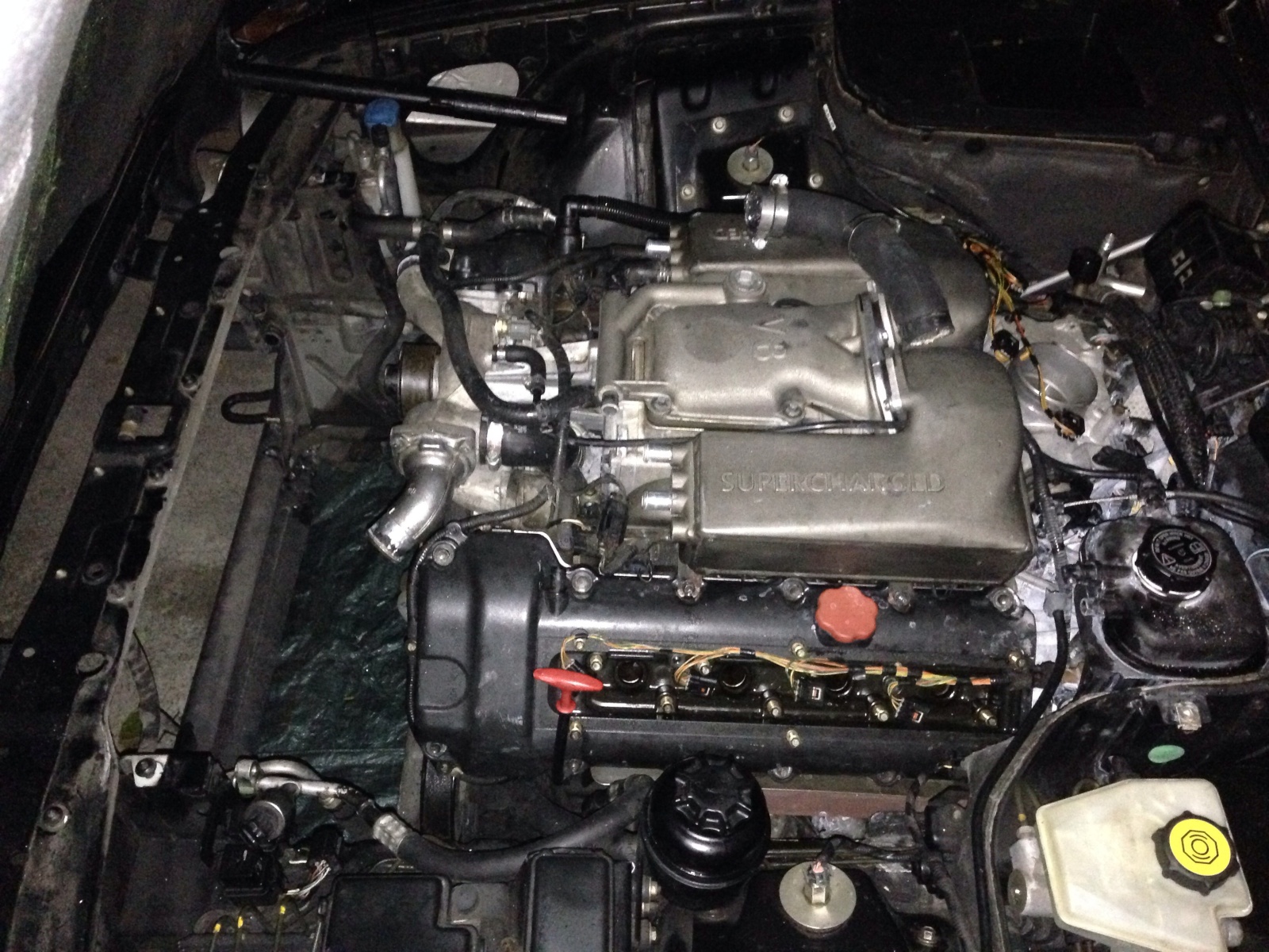

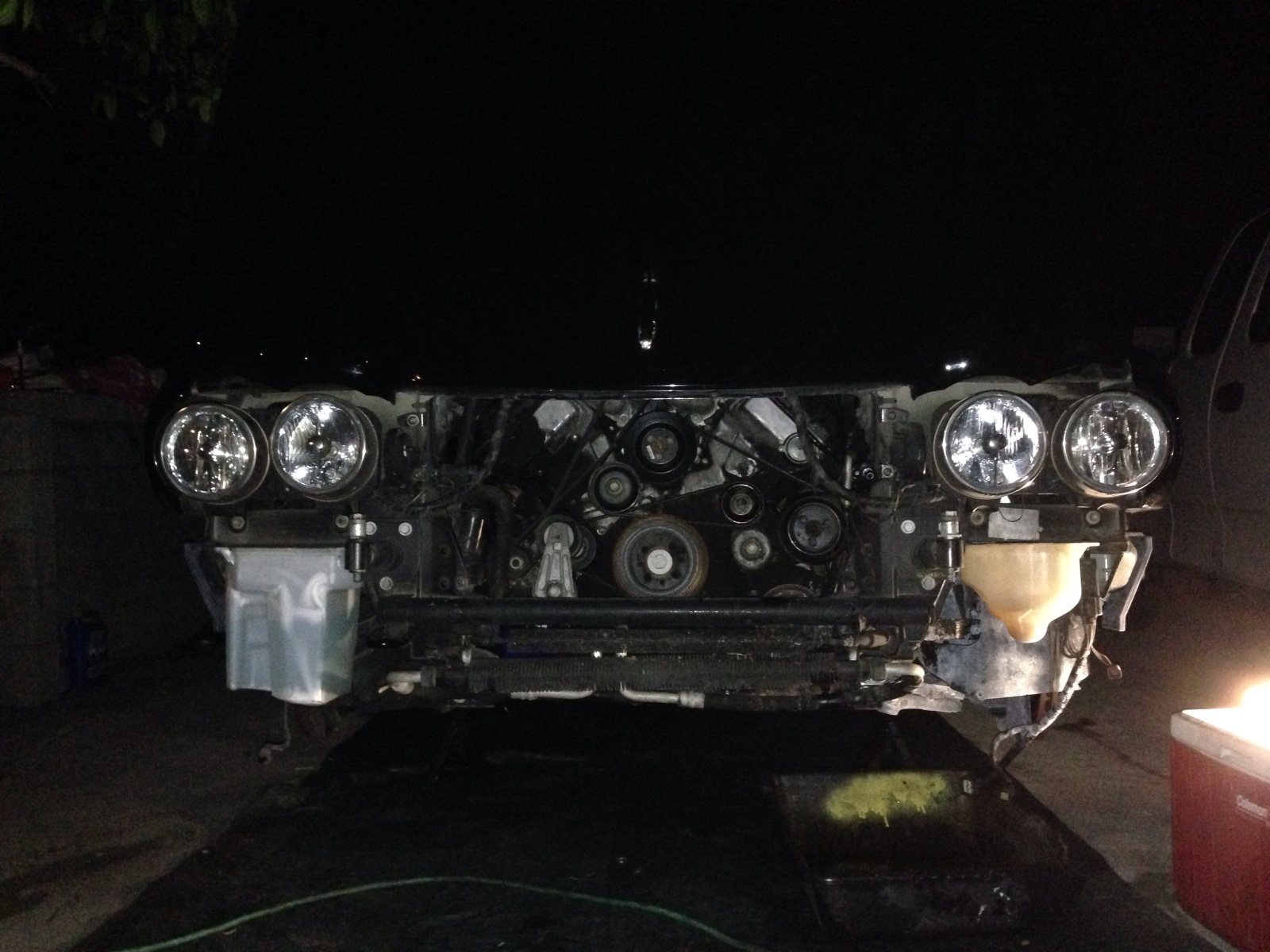

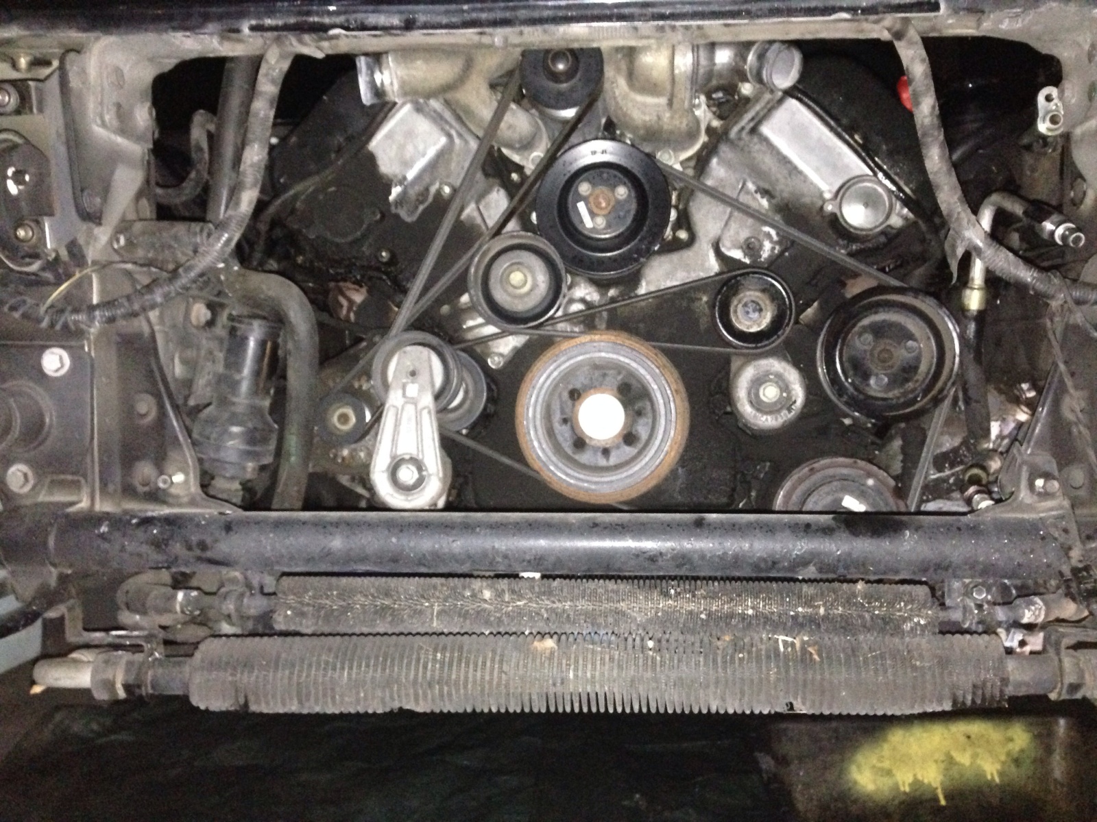

Originally Posted by XJR Prototype
Awww maannn! But i'm in for a build thread!
only progress from today:
Attached Thumbnails is this 2003 XJR worth buying?-2465g07.jpg   is this 2003 XJR worth buying?-24g1668.jpg   is this 2003 XJR worth buying?-bdv90k.jpg
Old Jan 1, 2014 | 08:44 PM
  #39
Ericbilt25's Avatar
Joined: Oct 2013
Posts: 148
Likes: 6
From: California
The cooling system had some sort of metal particle glazing so I removed the cooler and everything to have it pressure washed internally and externally.

Supercharger looks abnormally clean or maybe it's because it only has 100k?
Look's like she's in good hands now! I'll be updating my thread soon too.
