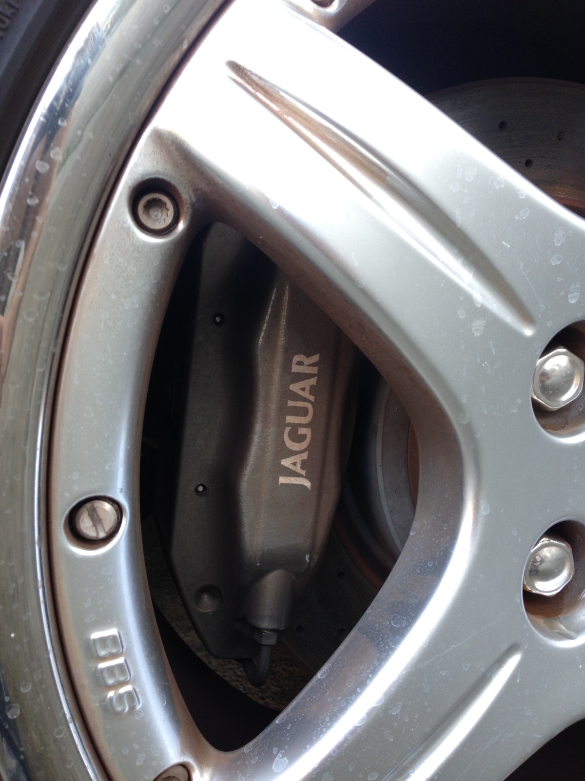

What kind of brakes do these model jaguars use? They have nice calipers. Anyone have a link on information about this particular xjr model I can read up on?

the X350 aluminum body car has Brembo brakes front and rear and electronic parking brake caliper in the rear in addition, a very nice touch. These are great brakes.
RyeJag
No, not all, only the XJRs, I think. Mine are pretty standard, non-Brembo, and thank goodness for me because Brembo stuff is very expensive. All cars have the electric hand-brake, of course. This can be expensive to fix if it goes wrong.

It looks pretty, and with a picture, I can tell you that is an X308, with a steel body, and no CATS suspension. No electric park brake.
If you take a picture of the brakes, we can tell you what you have. It's a great car, although I am biased, of course!

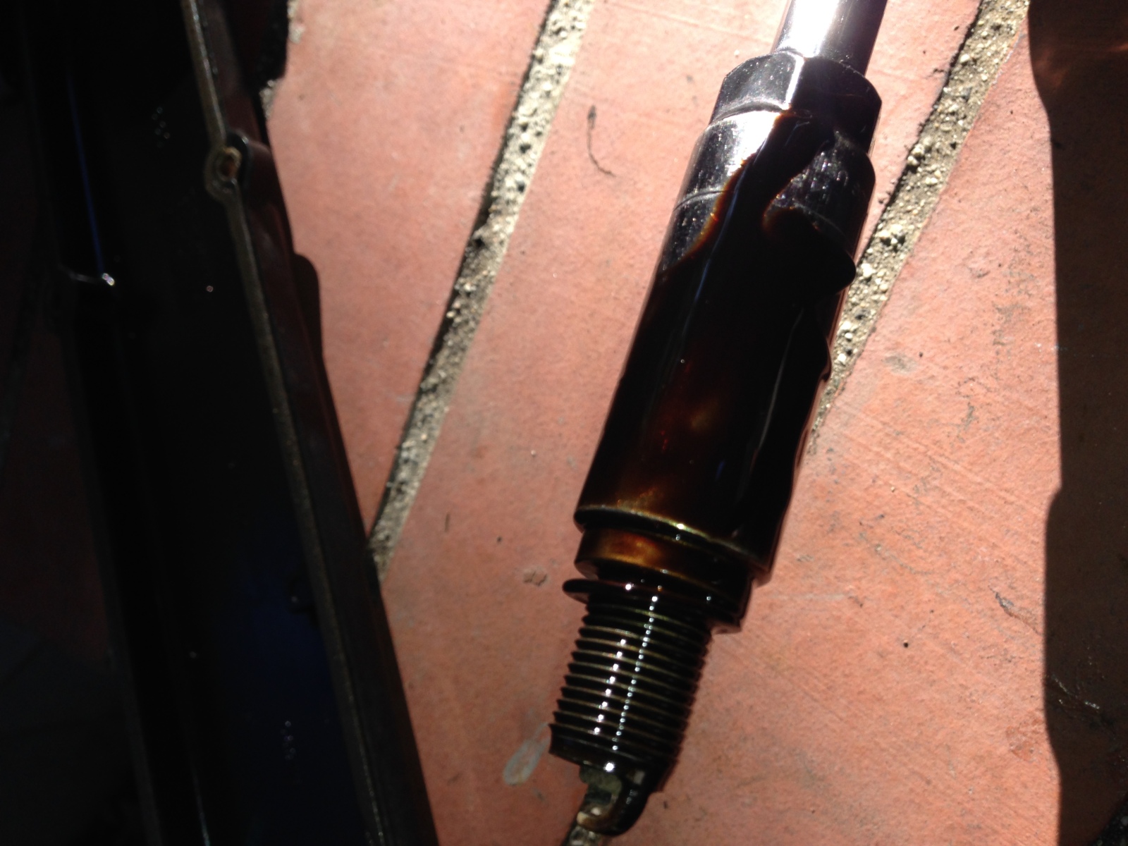

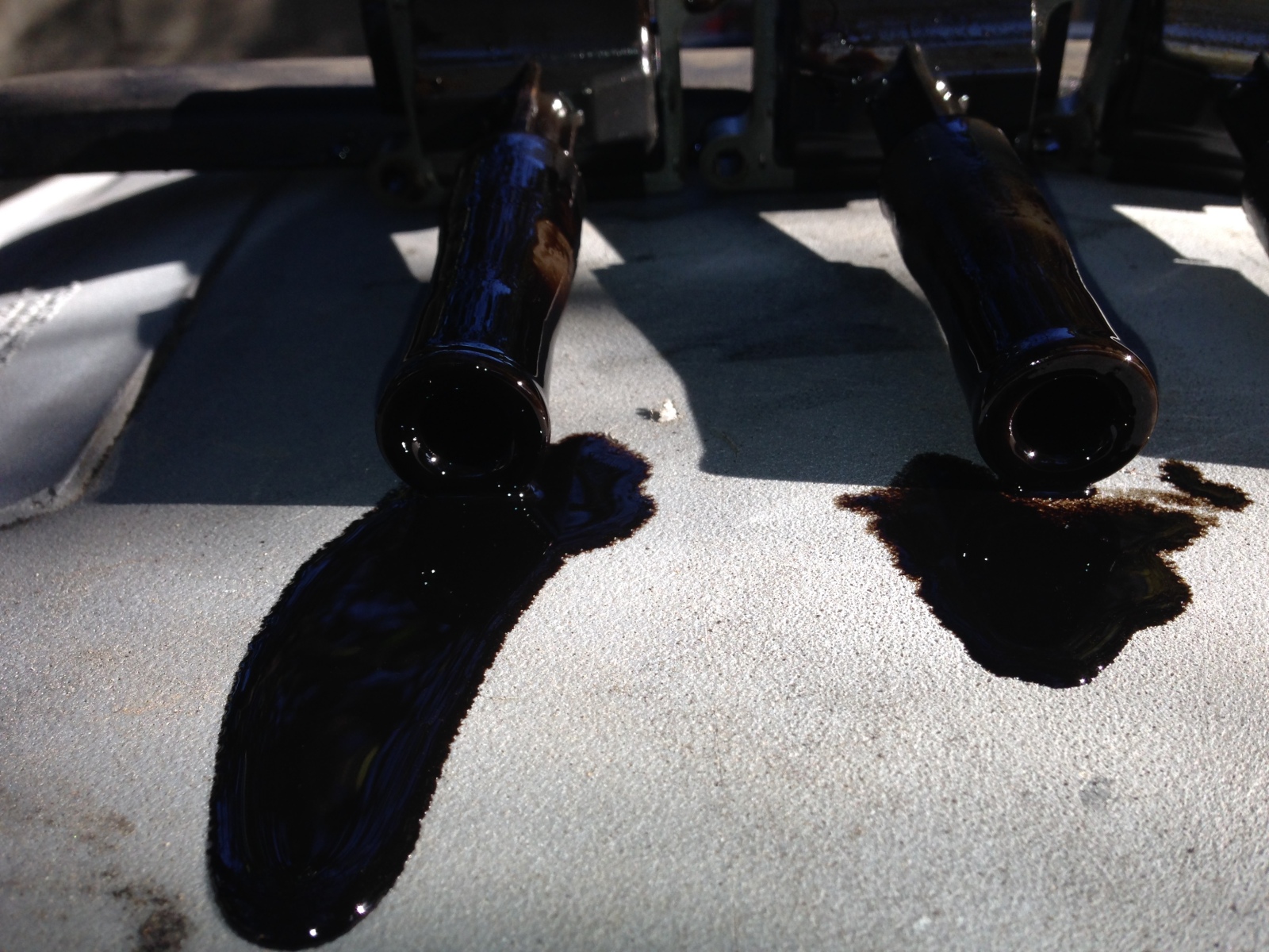

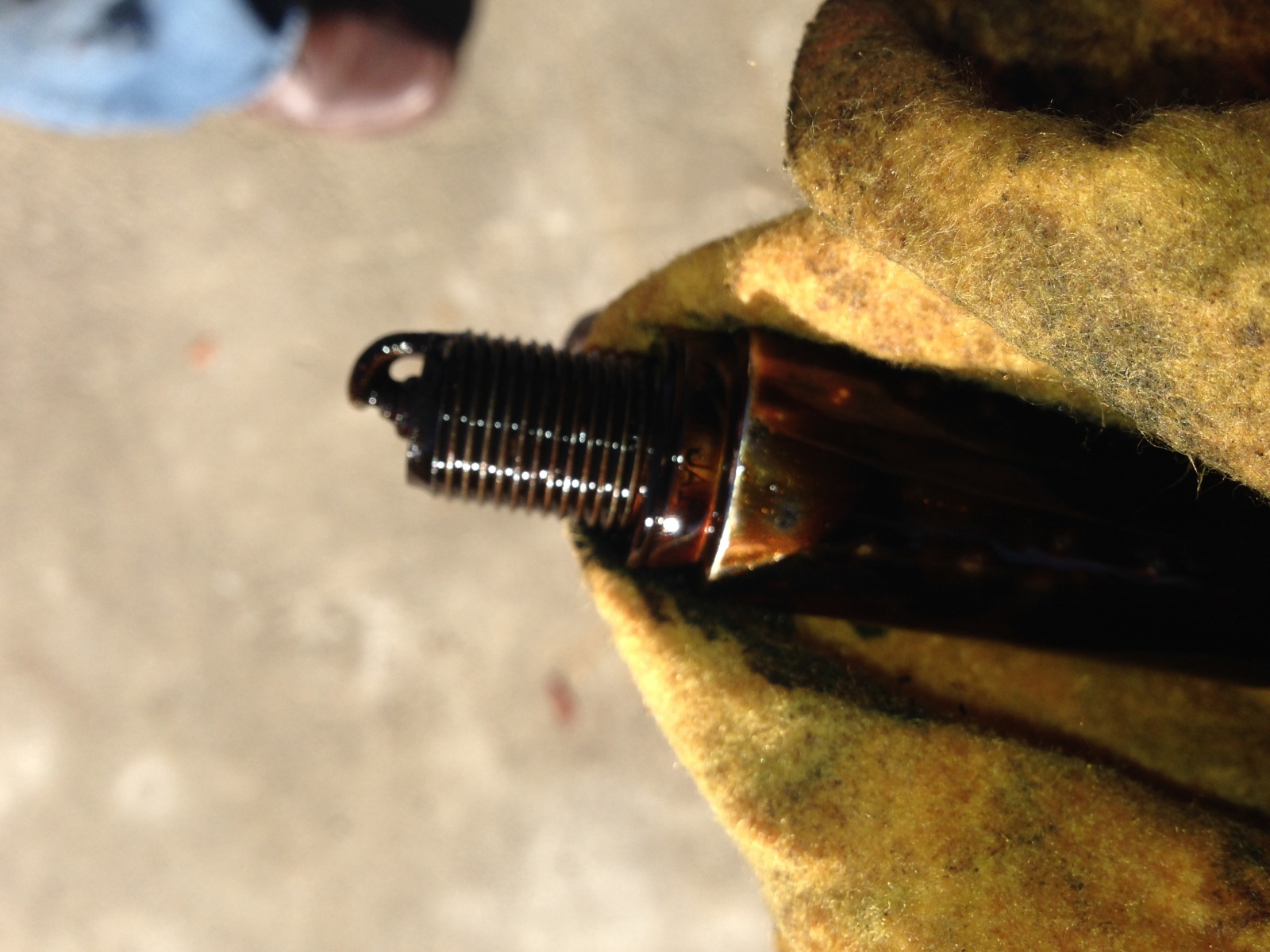

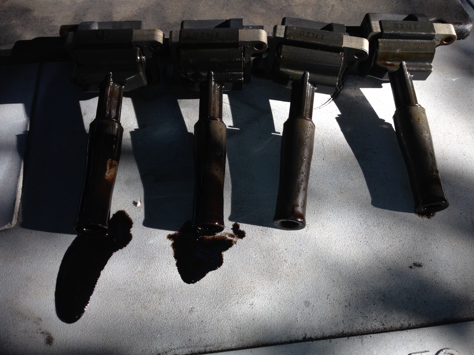

I scanned for codes and the car has 11 codes for cylinder 1-8 misfire & multiple misfires. The car starts & runs, but very rough.. almost on 4 cylinders. I took the coil plugs off & spark plugs and found a puddle of oil on the coils and spark plugs. I think it has CATS suspension? There is a plug on the front shock. These are the best pics I can provide at the moment. I went ahead and ordered 2 valve cover gaskets, spark plug rubber o-ring gaskets, new thermostat, and 8x spark plugs. I'm not sure if they sell individual coil plug boots, but I may remove the old ones and clean them well before re-installing.
FRONT
REAR
Here is a video of how much oil can be heard on top of the spark plug...this same issue occurred on the 1997 XJR and It's obvious lack of maintenance.
View My Video

You stole that car. Brembo's/wheels alone are worth more than you paid.
Coil packs are a problem with these cars as well, you may have gotten very lucky if that's the case.
Enjoy I would have bought it and dropped a 4.2 in it if it was me
