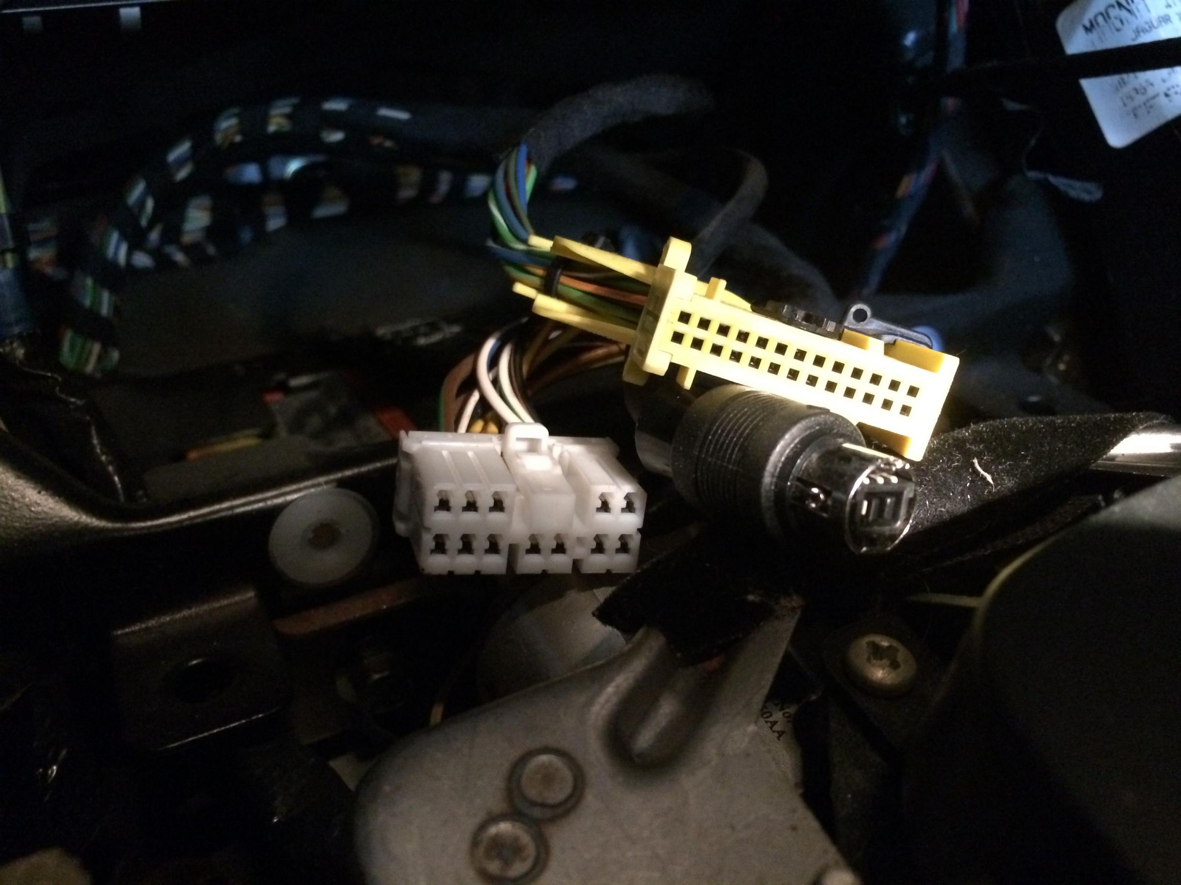

I purchased the harness and stalk adapter mentioned in the thread above (got it from NEXXIA in the UK).
CTSJG001.2 - Jaguar XJ8 1998-2003 Stalk Adapter).
It does not fit my 2002 XJ8 Sport. Apparently Jaguar changed the Alpine unit in 2001. The later models have a funky 12-pin white plug and a 26-pin yellow (Ford) plug. Neither of these match the plug in the adapter kit. (I found that out $60 dollars later)
I've been hunting all over the internet for the opposite plugs so that I can build a harness adapter to my new Pioneer DEH-X6700BT stereo but so far have not had any luck. If anybody knows where to find them please reply to the thread.
Below is a picture of the plugs used in my '02 XJ8.
PS: I have the face plate from HardToFindJag installed. Looks great. I would have loved to put in a double-din unit but didn't want to hack the vehicle. I also looked at the flip-out screen units but they are likely to hit the gear shift unless you remember to put it in Drive first (and some of them come out automatically when you start the vehicle).
