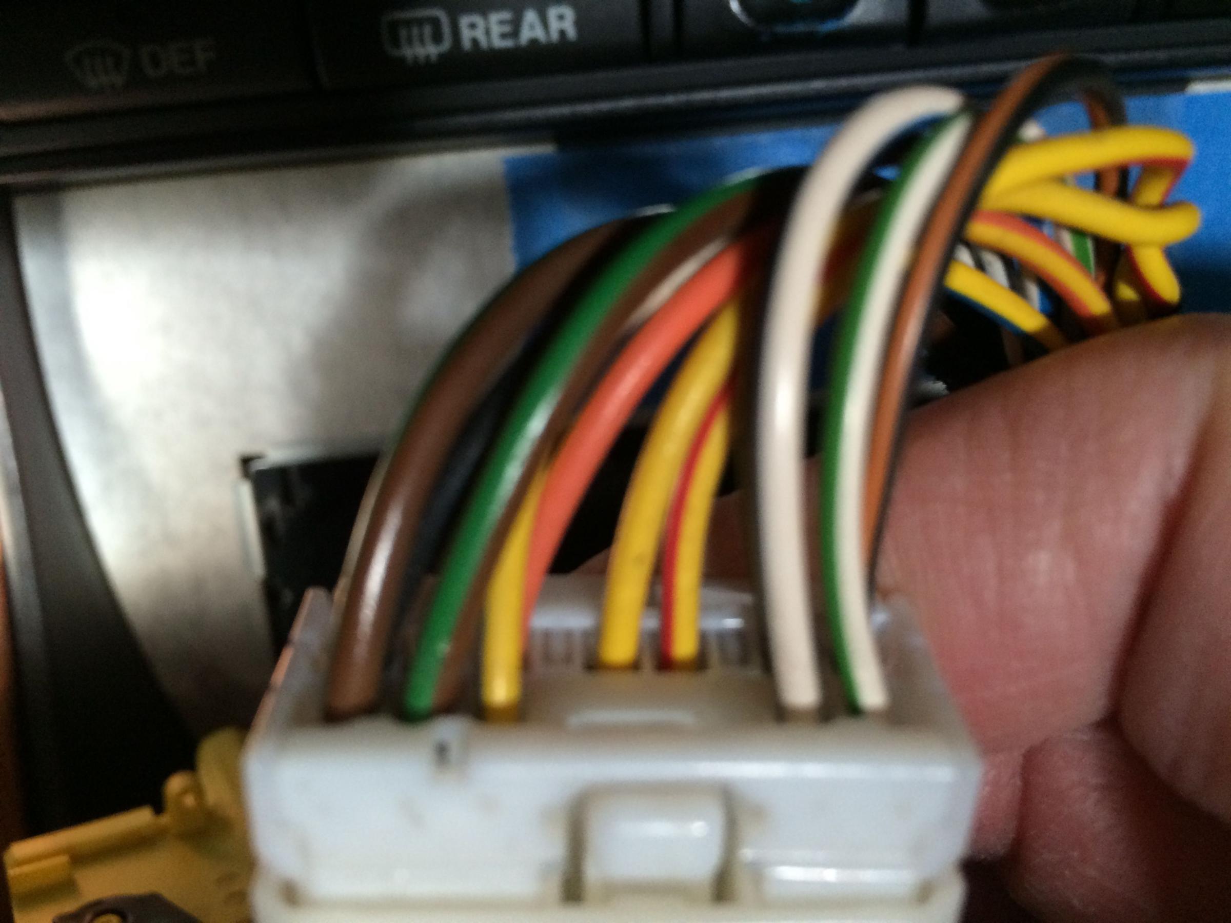

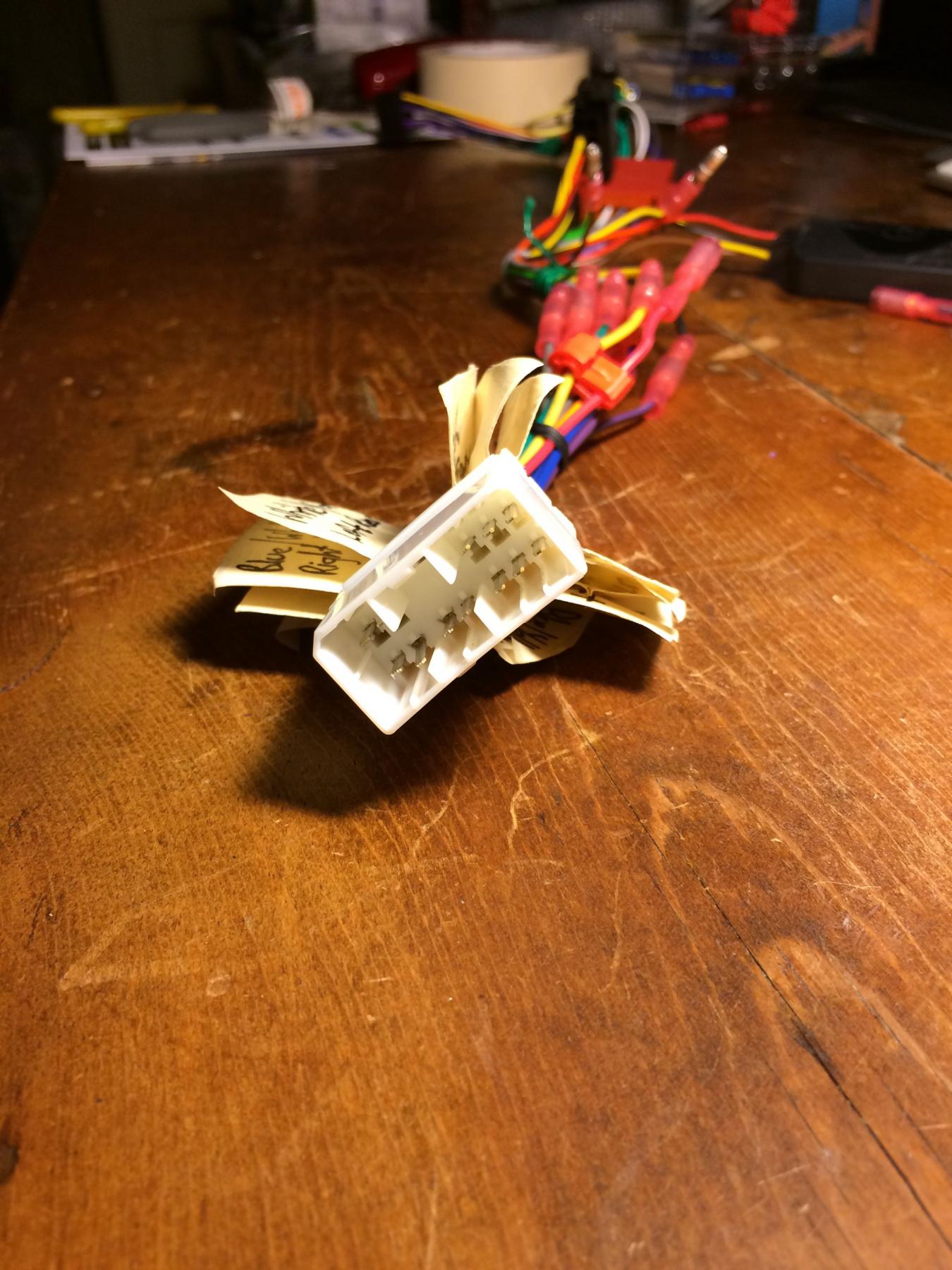

Default 2002 XJ8 (X308) Stereo Replacement
I managed to complete the wiring harness conversion without hacking the original. Pictures are attached. Everything except the Antenna and the Steering Controls are working. Have to research both. I followed the instructions found on the web site (There has been many posts on cha) but with one exception - there doesn't seem to be a RED/BLUE wire attached to the YELLOW plug that goes to the ORANGE wire of the ISO plug. I tried the BLUE but that didn't work for the Antenna or the Steering Controls.

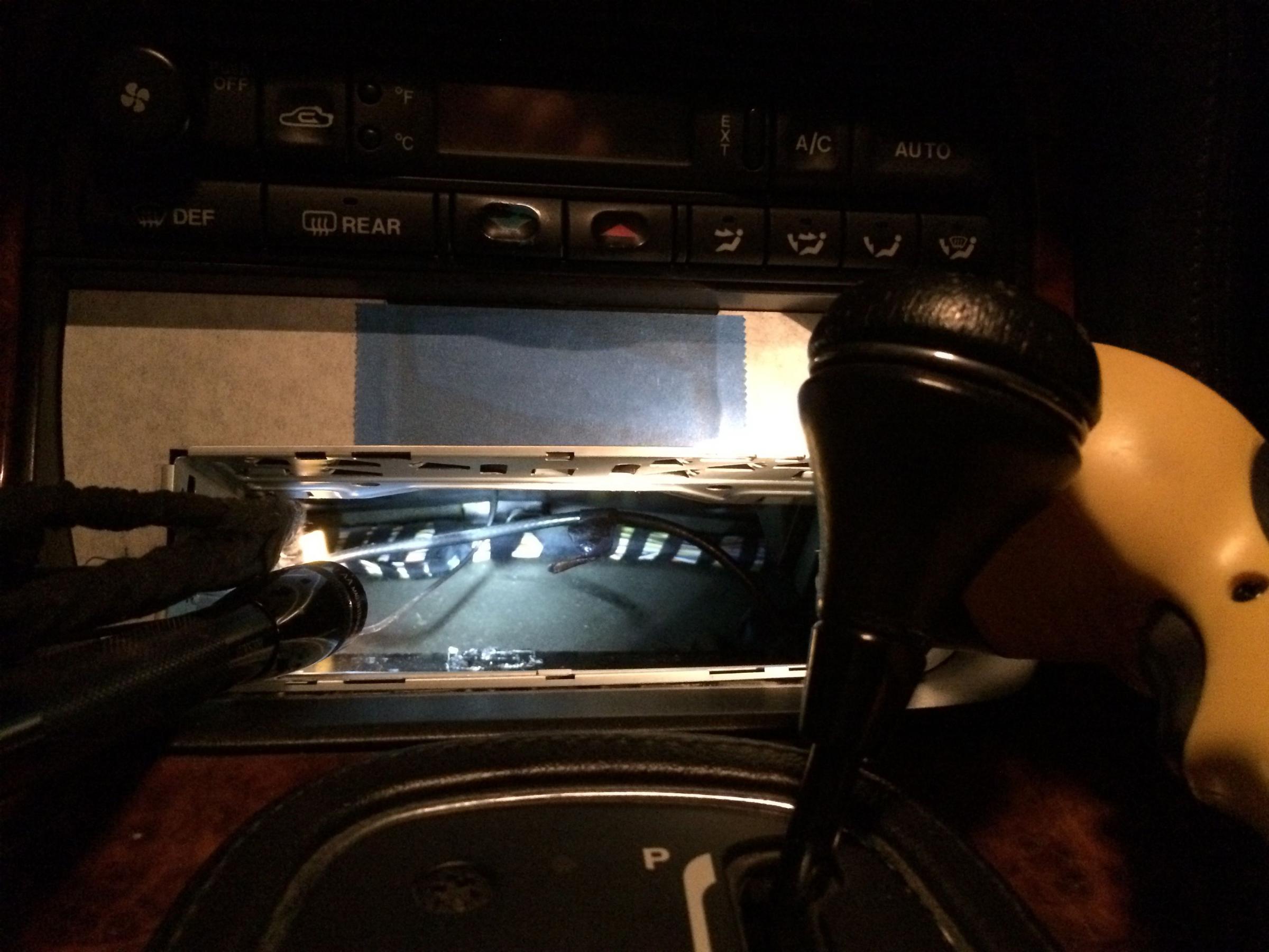

There is a not a lot of head room in behind the stereo. As has been pointed out in other threads, the ECU unit is below the stereo and the area just behind it (above the Single Din level) is blocked off. I've uploaded pictures. Sorry - forgot to measure the depth but I will have to go back in there when I figure out the RED/BLUE to ORANGE wire saga.
I installed a Pioneer DEH-X6700BT unit. I got that one because it supposedly has good voice controls for iPhone/iPod attached with BlueTooth or Wire. Seems to work OK. SIRI is a bit lacking or could be I just don't know how to talk to her and get her respond correctly.

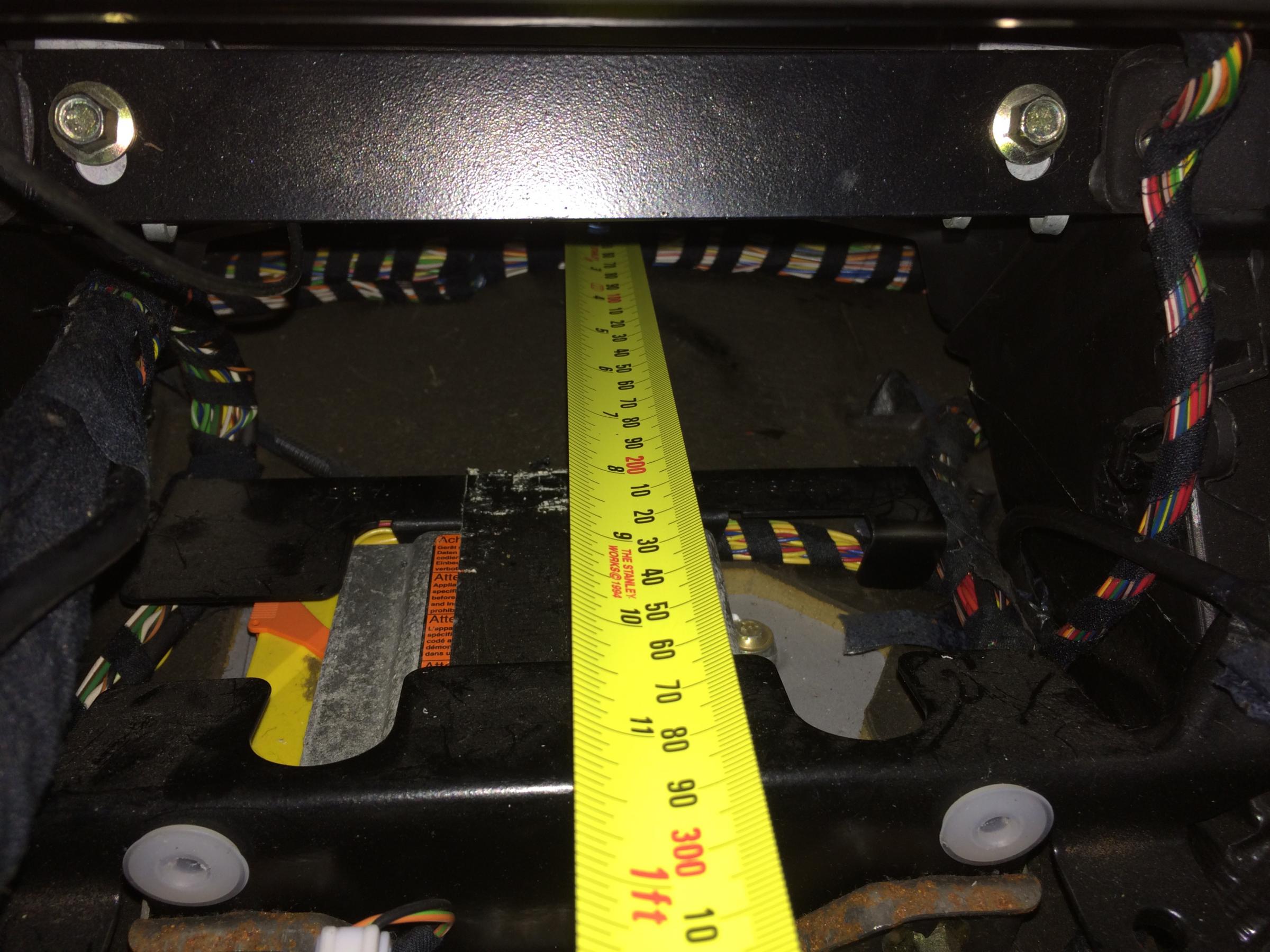

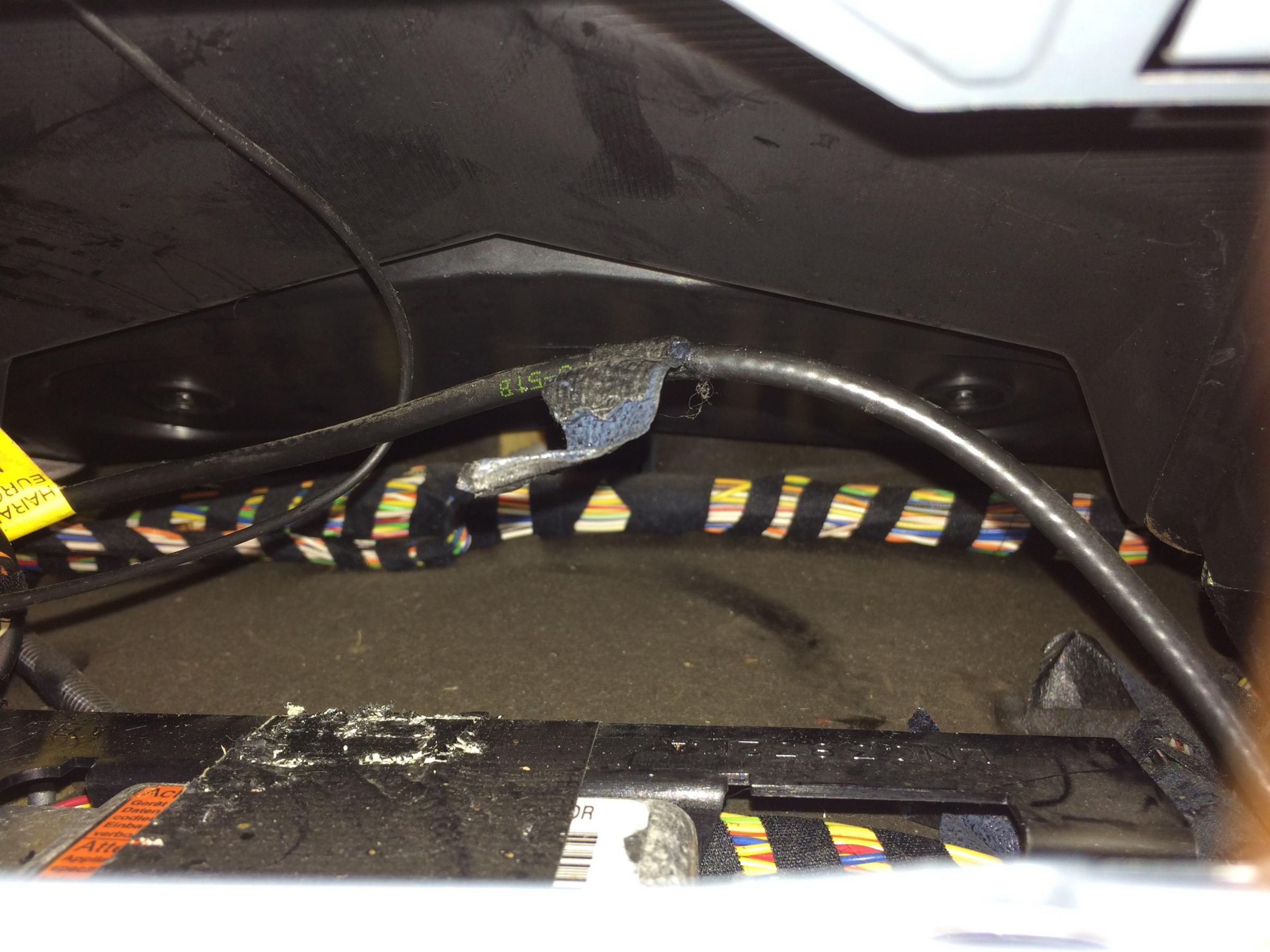

I have taken out the new stereo to try and get the steering controls and power antenna working.
Attached are photos of the space with a tape measure. Looks like about 11 inches deep, 8 inches wide and 3.5 inches high.
