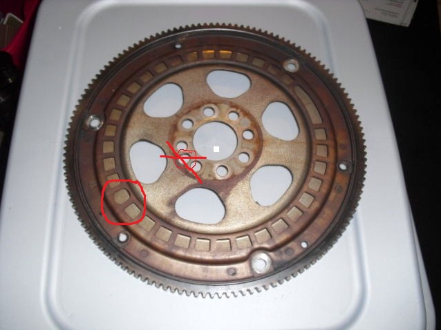

Sorry to belabor the point fellas but I'm still unsure which cylinder is to be referrenced for cam timing.
With the front cylinder of the right bank(passenger side in USA) @ TDC the cam flats align and there is an oblong hole visible and aligned with the opening for the crank position sensor.
I am reasonably confident cam timing is then correct in spite of a real live Jag "tech" hearing and driving the car insisting the timing had jumped.
The hole in the flywheel I'm seeing is at ~8 o'clock in the attached picture.

I'm not looking to lock down the cams but just confirm that cam timing is correct. I cannot even find a picture of the business end of the flywheel locking tool to confirm my suspicion of the hole into which it fits. Is it indeed the one with rounded ends among the square holes?
Simply getting the tool into the hole is very useful for assembling but for checking the possibility of 180* off exists if I don't know which cylinder to reference.
The car is currently in the air with the flywheel hole descibed centered in the crank sensor mount hole, all four cams in alignment, and piston #1 at TDC.
I'm reasonably confident all is well but am hoping for confirmation given that a "pro" was quite smug while telling me in a condescending tone that it had slipped a tooth.

Do these help?
File Type: pdf
File Type: pdf
