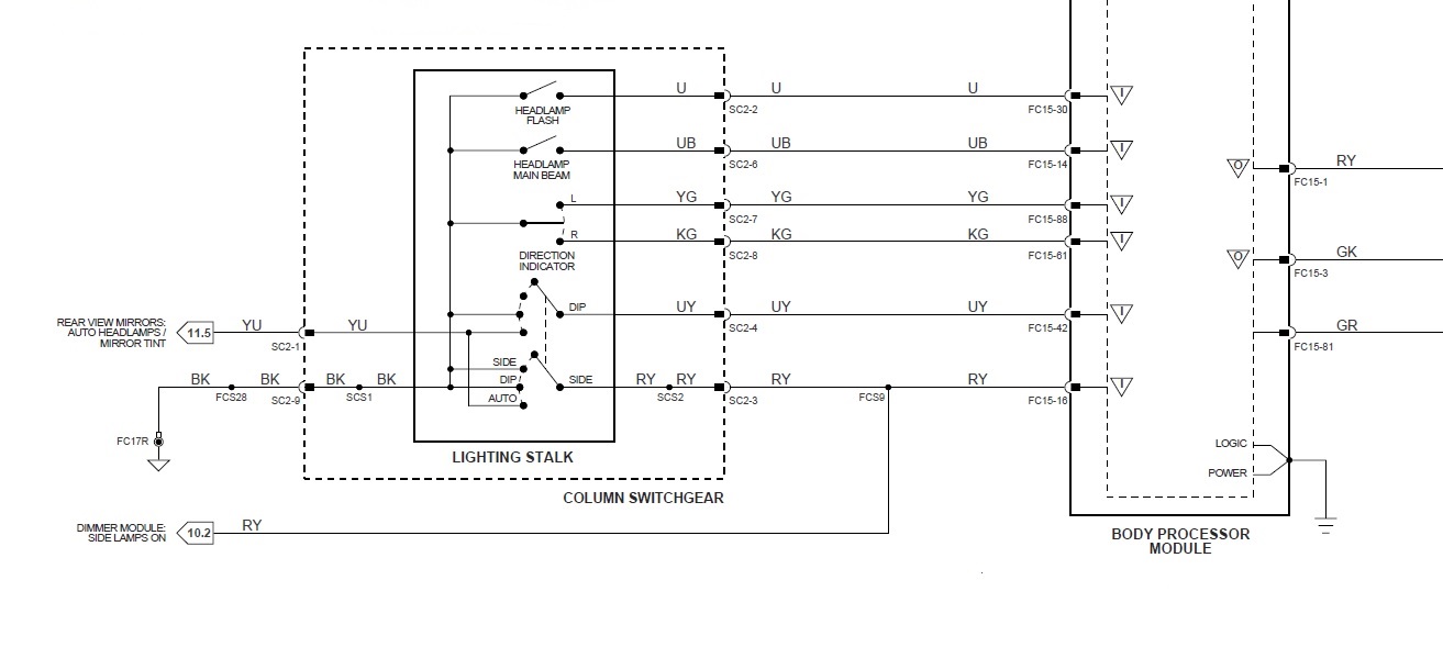

Side markers ,taillights would flicker and go out when touching the light switch. Took off bottom steering cover to find green wire from light switch was holding on with cover but I don't know wher it goes now. lights that were flickering are now off. It looked like it was connected to that little circuit board but I tried two places I thought it went and it just made the high beams stay on constant . (I just need to know where the green wire coming from the turn signal stem goes to on the other end) Thanks

It's a Green wire with no trace colour?
Here's the Lighting Stalk section of the wiring schematic for the US 98MY:
I can only see KG (Pink/Green) and YG (Yellow/Green) coming directly from the Lighting Stalk to the BPM (Body Processor Module).
