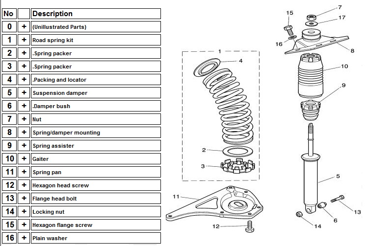

Hi Everyone, I have an XJR and I removed everything on front spring assembly. The 2 sides had things in the different position. Im hoping someone can help me put the parts in the correct order.
front springs: There is a round flat plastic washer, another washer that has a cone on it and there is a rubber Grommet that clips into the spring. I would like to find out the correct order of the items to reassemble after being rebuilt. Both sides were different and I have no idea which way is correct.
Thanks in advance.

Bryan,
Does this help?
There can be more than one Spring Packer (item 2 - the flat washer) and not necessarily an equal number on both sides!

This helps a bunch! Thanks
