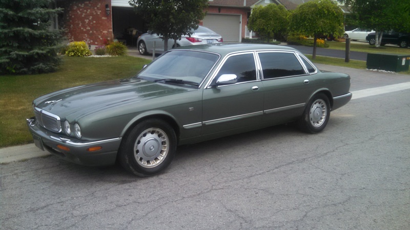

Side note: It only looks this good from 10 ft. away. Get any closer and it gets a lottt uglier real fast.
