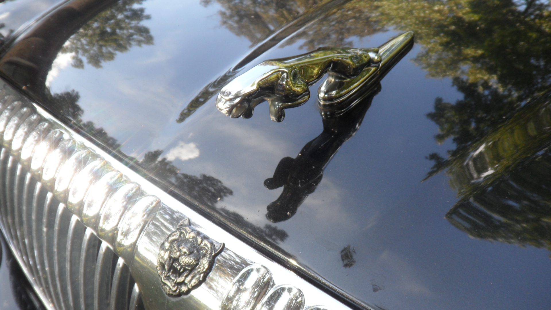

If the trans works well, I'll have new paint put on and the drivers bucket seat has a worn area on it that needs repair. Have the carpet cleaned again and I can put the car in some car shows for fun. They get a lot of compliments, for sure. Makes me want to go jump in and drive.

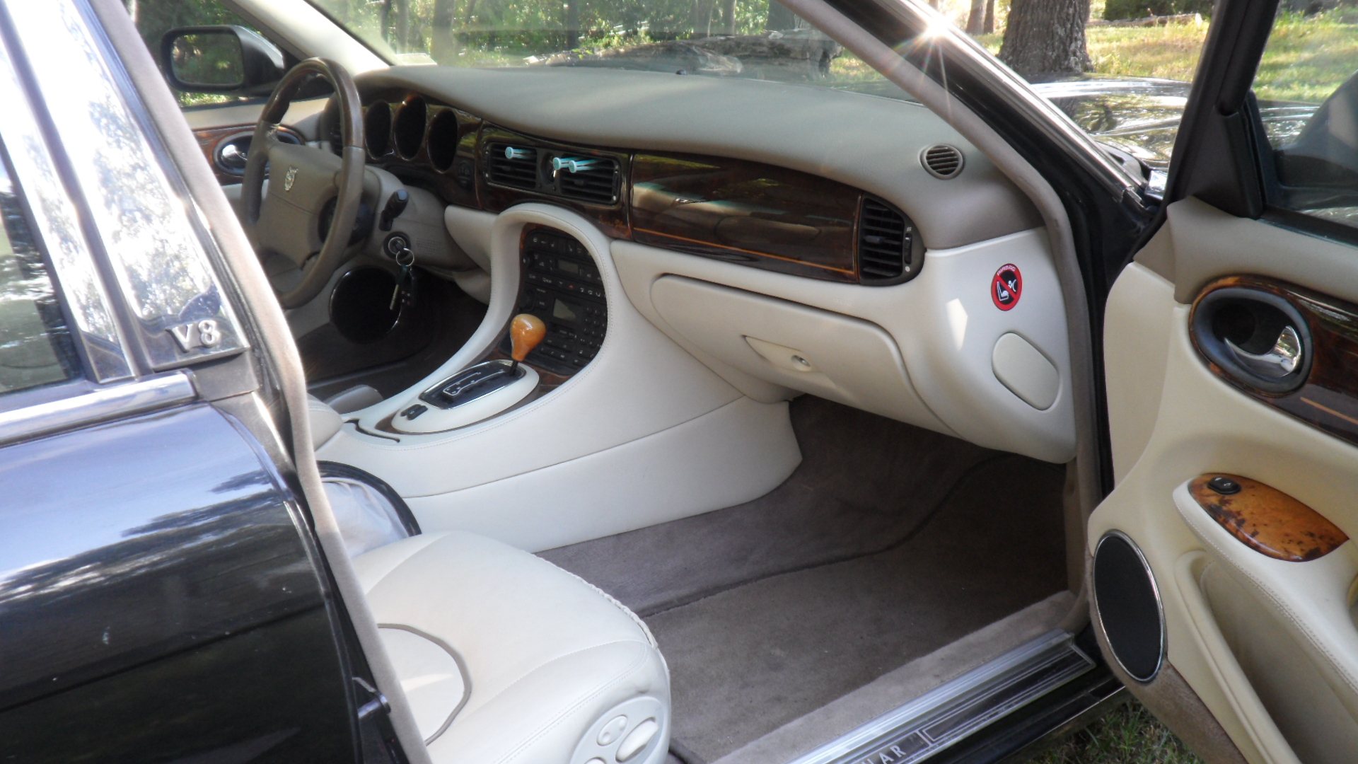

Interior is like new, except for a little wear to the front seats, (scuffing, but nothing major).
