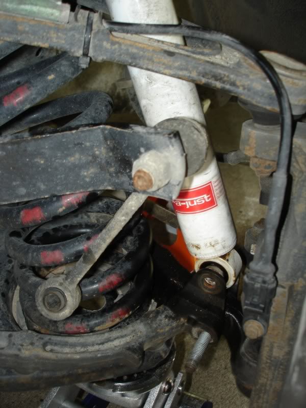

First, jacked up the car, placed stands under the car, took the wheel off, placed the floor jack under the spring bed (lower control arm), and jacked it up to a point where the car itself starts lifting up... This way you compress the shock as much as possible with the spring still on. This will give you more "wiggle" room when taking the shock out.

Next, unbolt the top, and SLOWLY (!!!) lower the floor jack. I went a bit lower the the picture below, but not by much. Had to take the bottom shock mount bolt out to remove the shock...

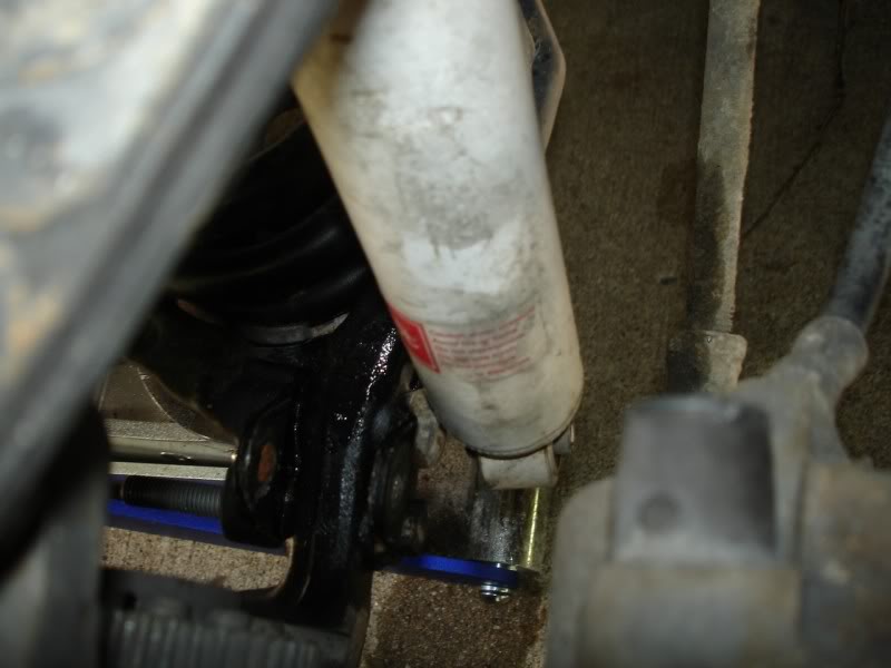

You pretty much have to remove the sway bar link to get to the lower shock mount bolt...

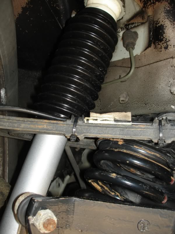

Here is the new shock boot. It fits snugly in the upper boot "dish"...
