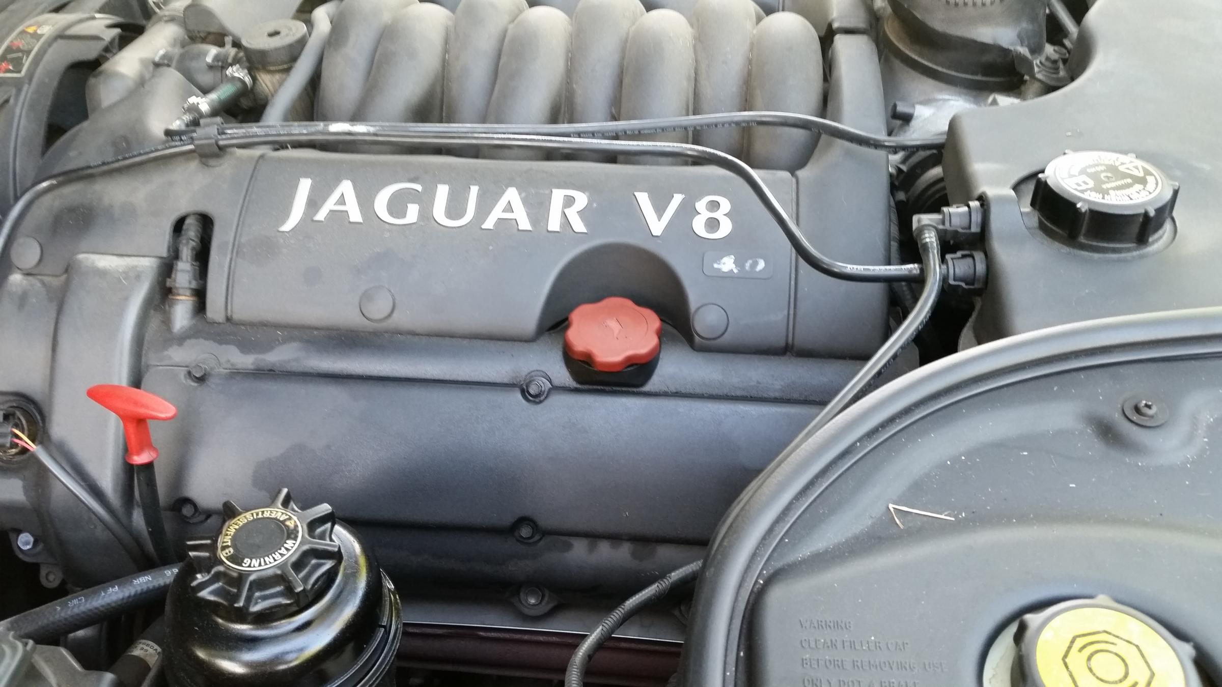

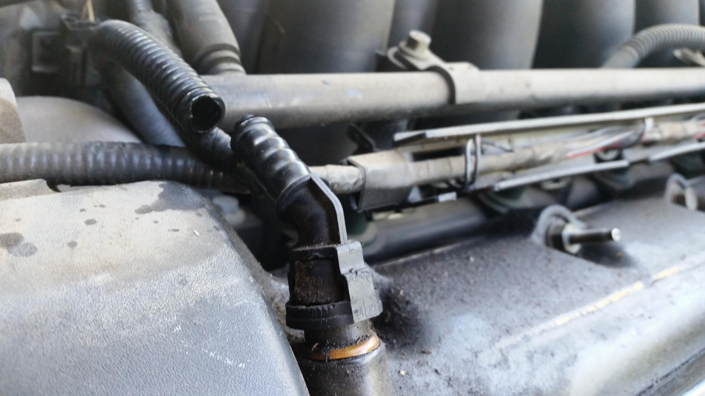

Originally, I was going to post about my loss of coolant. I was going to just add the one picture that shows fluid across an area of the engine, and ask if that could possibly be coolant, and if so, what's broken...
Then I broke a hose (a very fragile one it turns out), and I'm wondering A) Could it be that this was already partly broken and the cause of losing coolant, and B) What exactly is it that I broke?
I have about every PDF imaginable for this car, including the Workshop manual, but I'm having trouble specifically identifying the hose that I broke. It appears that it is indeed a part of the cooling system, but I'd like to know if it's low or high pressure, and if this might be a common area for leaks. Also, is it possible that fluid only goes through this hose in certain cases (like when the heater is on or when the AC is on)?
Any help is greatly appreciated.

I figured it out. Part-load engine breather tube. Temporary fix with duct tape. Will replace after I'm home.
