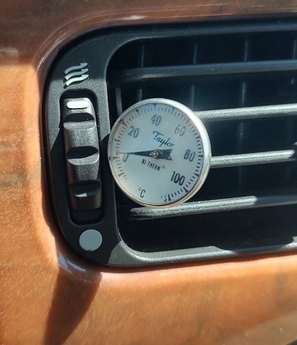

Topped up with maybe 3 or 4 two-second bursts of R152A, maybe 5 - 6 ozs. got the pressures up to range.
In the shop, that got temps at the vent down to about 8°c (~46°f), once I got out for a test drive managed 2°- 3°, (35°- 37°f) so plenty chilly.
All good!
